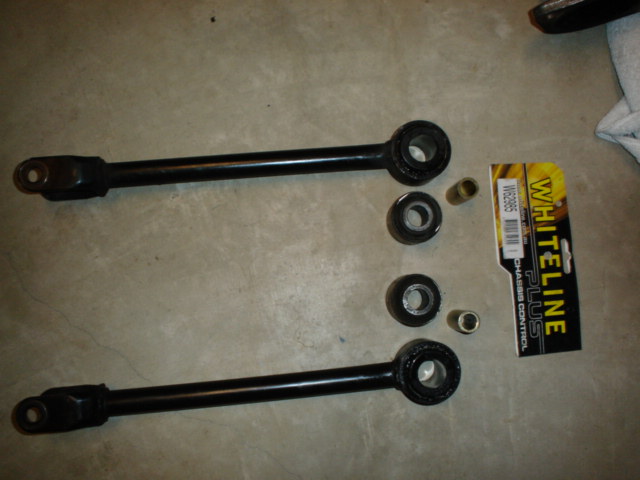

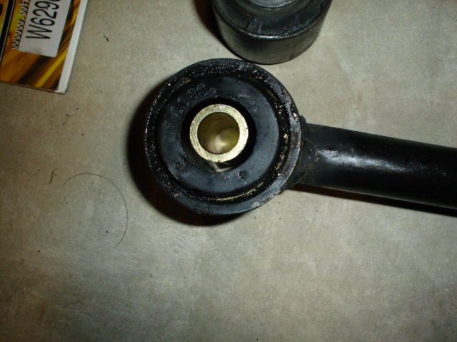

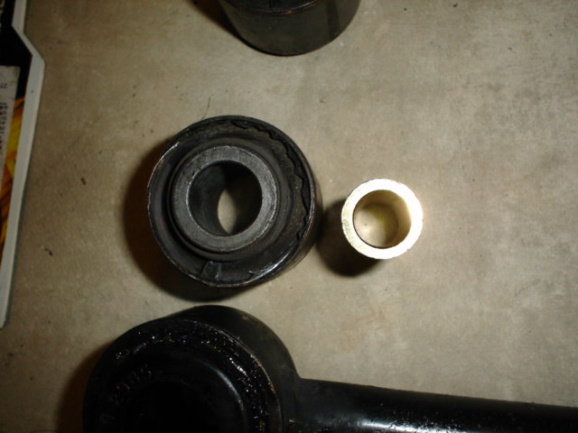

need anyone's help with whiteline bushing..so i'm in the middle of installing all my whiteline bushings and i get to W62985 (they call it the rear trailing arm -upper front) and i get the bushing installed but the middle tube is way too small. see pics.
I wanted to see if anyone has experience before i call whiteline, thanks. wrong part or do i need to do anything special, no instructions were included and i don't see any on their website.

25.4x20.2x42 mm is what the tube should be..so what you got there is obviously wrong.
25mm OD of tube/sleeve = ID of the rubber bushing hole.
20mm ID of tube/sleeve
42mm length
just call whiteline ask for a guy named Jan
or just email him - jan@whitelineus.com
let him know whats up and he will ship you the right tubes....maybe you might have to email him the pics, but most likely not...hes legit..
-J

/\ thats what i was thinking but didnt have a micrometer to confirm, thanks bro.
