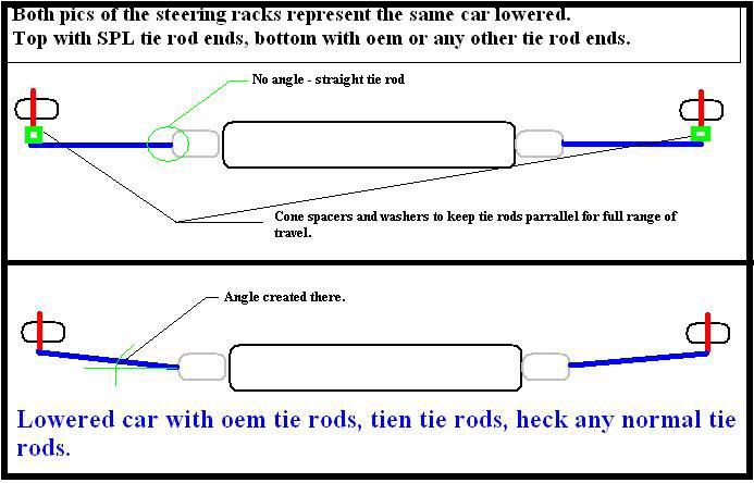

If you have a lowered car.....i recommend SPL tie rods......if its a daily driver, then na, no need but this issue your having (if its the tie rod ball joint going out) will be solved with spl since they dont use a ball joint at the knuckle to tie rod connection...
see a lowered car lowers the chassis of the car...hence lowered car!! duh...
well the steering rack is attached to the K-member...the kmember is attached to the chassis....see where im going with this....
SOoooo, in turn the wheels raise up, due to the suspension being adjusted to "lower" the car.....
This then makes an "ANGLE" in relation to the parrallel line of where the steering rack is on the lowered car to the "now raised knuckle"......
What im describing can better be shown here:
-J
