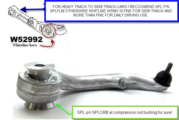

Hi Jason I have read quite a bit of this thread but I would like some input, I will be doing some suspension mods within the next few months. My car is a DD even in snow, I track only a few times a year if that so my goal is to keep the car somewhat quiet and maintenance free. My car (04 350z coupe) has 80k and a few worn bushings (compression rod and strut mount) and I want to try to replace any/all bushings at the same time.

1. SPL compression rod bushings
2. SPC rear camber arm and toe bolts
3. Whiteline sub-frame bushings
4. Whiteline Differential bushings

Now this is what I want your input on, all other worn bushings:
Should I go with Nismo, Whiteline, or SPL I do want to try to keep the cost low but if it means spending a little more for a superior product I will, these are the bushings in question:
1. Front inner LCA
2. Front lower strut mount
3. Rear lower shock mount
4. Should I decide to replace the bushings for the spring bucket arm, rear spindle, and traction arms, should I get Nismo or Whiteline?
I am not sure how much noise is added with the Whiteline stuff so that is why I am thinking of the Nismo stuff, I also want to use the Nismo bushings for the front and rear upper A-arms unless you recommend otherwise?

1 - SPL - due to this being the mount point of the dynamic (moving) suspension - it needs to articulate freely....whiteline is fine here as its sleeved and friction from bushing contact to the sides of the k-member is minimal and not that great. so whiteline there is fine - see my pic comments on track versus daily.
2 - whiteline - as this point articulates on an arc that is very gradual....no need for anything more really...
3 - rear lower shock to rear knuckle mount should be SPL - he would have this single bushing separetly on his site, not sure if he still does, but if not call him and ask him for that one only.
4 - spring bucket arm - no unless damaged, i doubt it.
- rear spindle ~ rear knuckle, no other than item 3 above.
- Traction arms ~ again item 23 radius rods - no, not for your usage.
- front upper A-arms - whilteline - again, because they are sleeved
- rear upper A-arms - whiteline - again sleeved
-J
