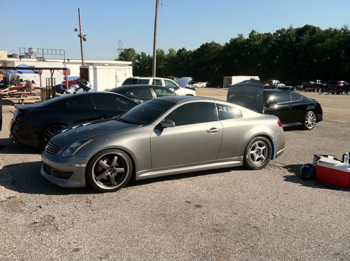

They could definitely use bigger spacers there's a mile of room... I refuse to run spacers more than 5mm for safety reasons tho. Gonna need some different rims if you want that 'drag racer' look.
Sweet ride... I absolutely hate how pushed in they are..But I would never run anything bigger than a 5mm also...
Im gonna do some research n see if anyone out there makes anything else....I started talking to the tech dept at Summit to inquire specifically about the rims they sell with their name on em.. Ill get back to them this week...

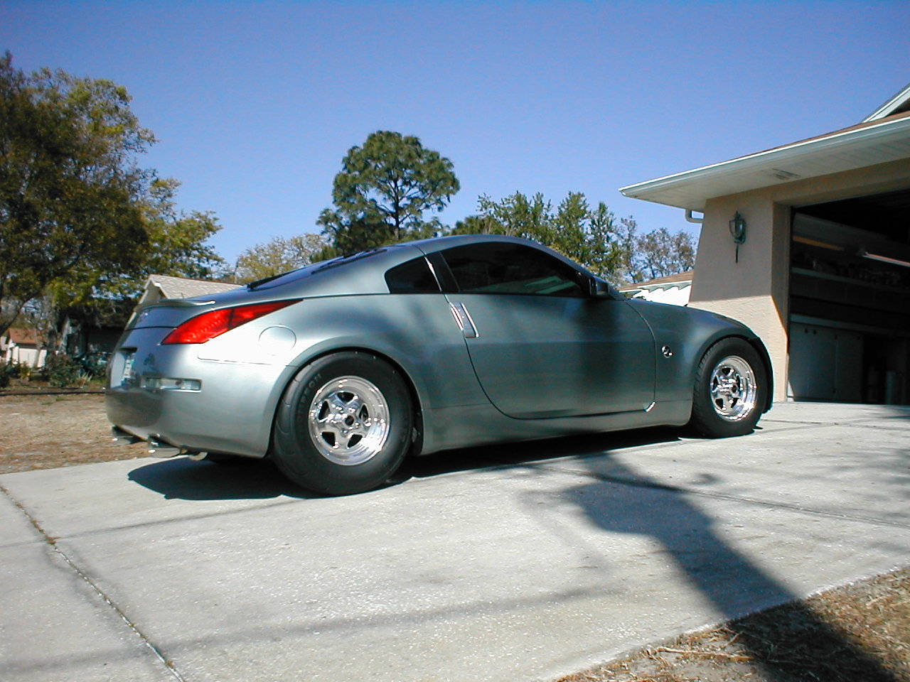

Here ia MT Drag Radial 275/60/15 (28 x 11) on a 15 x 8 wheel with 5.5" BC and the car is lower about 1-1/4". Still had good clearance.
Music to my ears...lol ...your set up is just awesome..I wish I could fit those wheels.. Next will be the 17in skinny wheel up front..

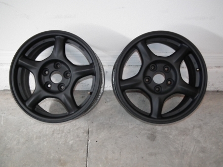

In the mean time, here is a pic of the wheels after a nice coat of paint... I got my hands on these for a very good price. A little cleaning and paint goes a long way... I hope to have the slicks mounted this week..
The wheels clear Brembos without a spacer which is a plus and they are super light. The backspacing is not bad at all. It may help tuck the slick in the wheel well better. Will see how they fit later..
Attachment 327210
Mine cleared with less than a nut hair. I would not run these without a small spacer, because even the slightest thermal expansion could cause things to go bad.
