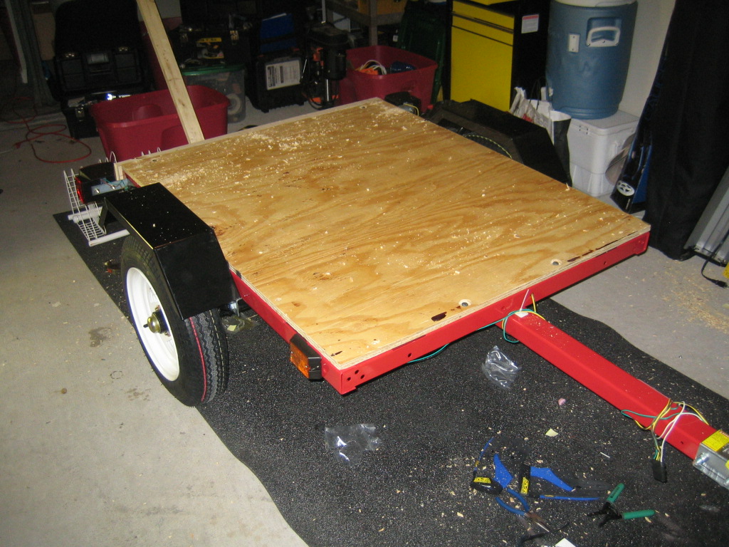

Here's how I use to do it on my '03, I haven't convereted the hitch to my '07 yet. This setup was great when hauling tires to autoX / track days.
I've actually been able to get a set of four 275 width tires in the car + equipment. After doing it once, I swore I would never do it again. Above anything, it seemed very dangerous to have the wheel & tire sitting just behind your head w/o anything to prevent it from coming at you if you had to do a panic stop or a got involved in an accident.
It's a Harbor Freight trailer 40" x 48" (the one w/ 12" wheels) w/ a 3/4" plywood sheet cut to allow a little overhang on the sides to allow for wide tires. It was dirt cheap (~$160) and held up to 4 years of usage. When hooked up, you barely know that it's there except for the noise of the receiver occasionally moving around in teh receiver tube. The trailer wiring was the toughest thing to find. I finally got it the proper wiring from a friend, I thnk he got it from Napa.

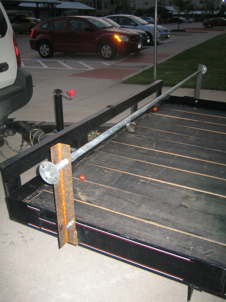

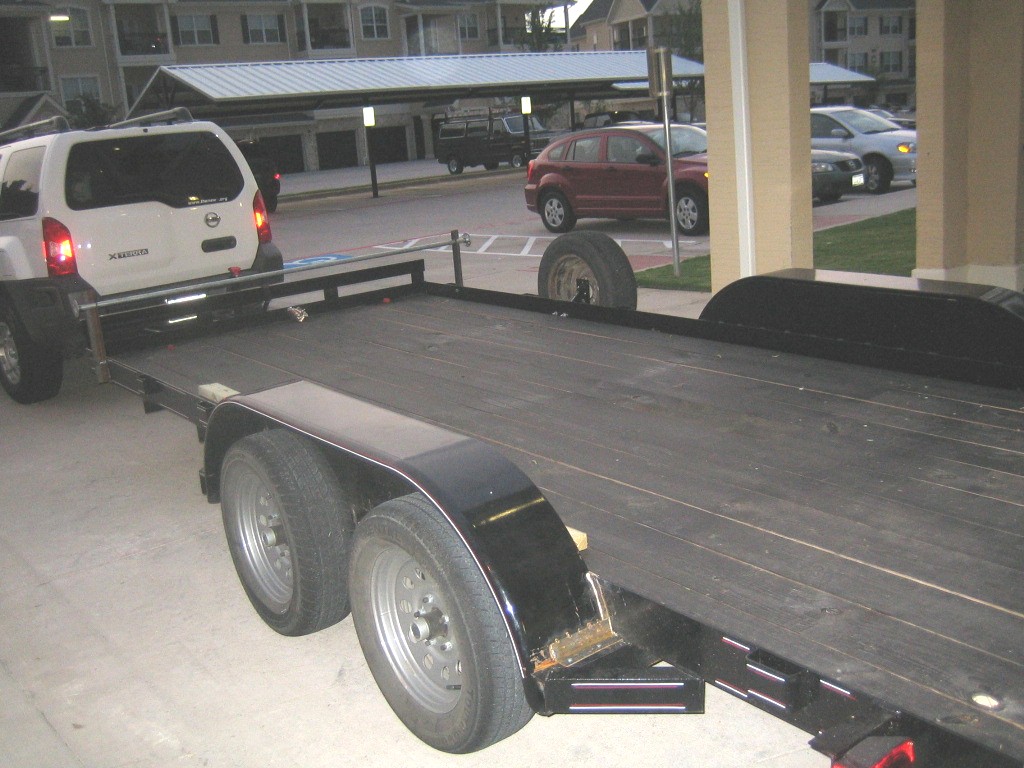

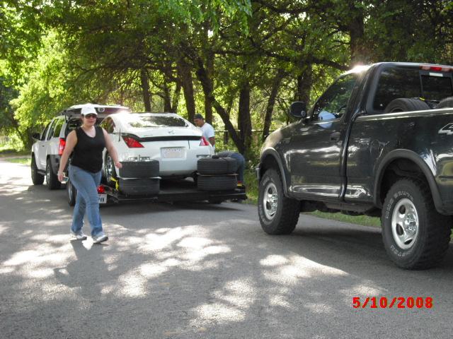

Hi,
I added two L-angles and drilled a 1 inch hole through it and ran a 84 inch 3/4 galvanized pipe through it.
I can now stand 8 wheels and tires in front of the Z when loaded on the trailer.
Ill try and add pic's later of the Z and tires all loaded up.
I also use two 1-1/4 inch floor flanges mounted on the trailer floor behind the Z and can take an extra 4 wheels and tires laying on top of each other with the 1-1/4 inch pipe sticking up through the center cap holes in the wheels. Look close behind the Z in the 3rd pic.
Since these pic's I have rust-treated and primed/painted the angles black.
I plan on drilling a hole through one end of the pipe and through the L-angle so i can lock the wheels using a trailer hitch lock for those out of town events.
- Jason

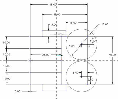

I also have this trailer to pull with my Z...don't have any up to date pics but its set up like the diagram...
I have 1-1/4 inch floor flanges screwed down to it and also have cross pipes for mounting more tires.
I use this one mainly for local auto'X events and light hauling of materials when i need.
- J
