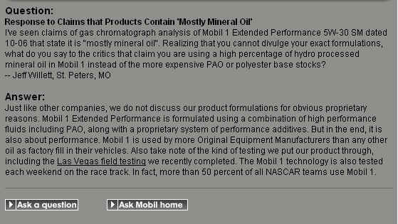

It has been well known that Mobil 1 is NO LONGER a 'true' synthetic, but they market it as such.
Someone posted a question directly to Mobil1, and rather than be straight with the answer, they wouldn't comment, saying the 'formula' is secretive. It's not formula we're asking, but simply asking what is it that we're buying.
While Mobil1 is being secretive, Amsoil and Redline, among others, proudly list their basetocks....PAO, and GroupV, the REAL synthetic basestock!!!
Attached Thumbnails Mobil 1 Oil Users - Motor oil discussion thread-mobil1-crap.jpg   Mobil 1 Oil Users - Motor oil discussion thread-redlineoil.jpg

Prove it. Please.
You might start with something better than posting a screen clip of XOM clearly stating that their M1 oil uses PAO base oils, which you claim is a "REAL" synthetic.

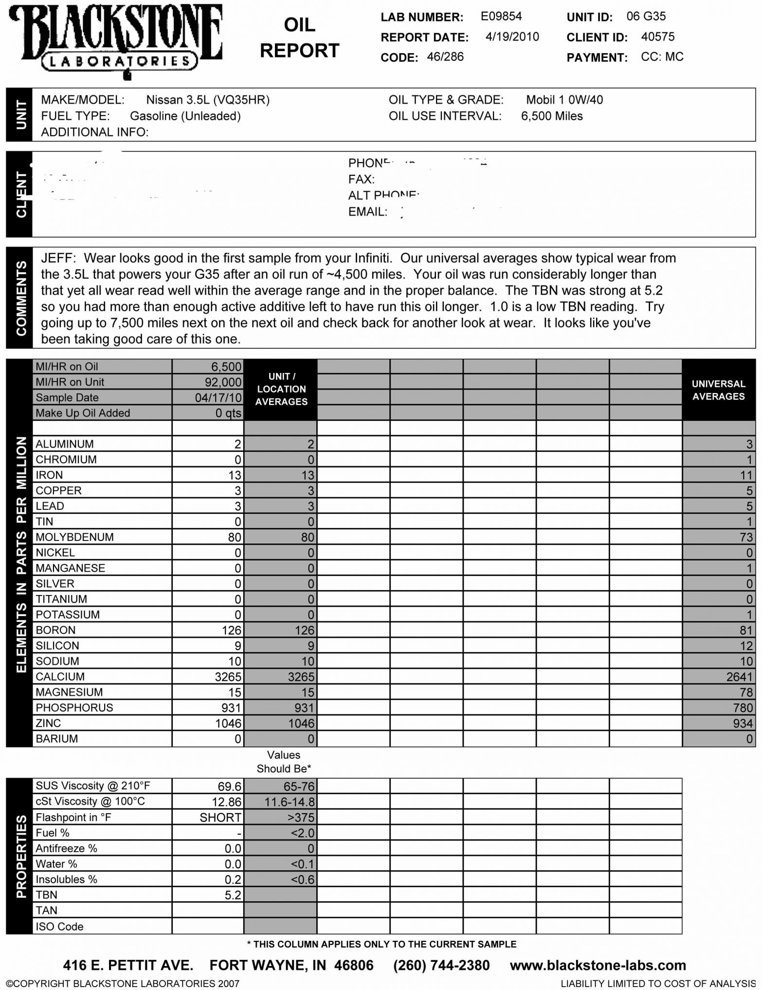

Here is a UOA for M1 0-40 that I ran last year. Couple of track days, some trailer towing and some highway. Almost no city driving. M1 doesn't do bad in all VQ's.

There's nothing to prove, use what you like. M1 is a good oil, but I will continue to use an oil brand that clearly states what base stock they use, ie Amsoil or Redline, Motul, rather than a major brand that touts so many things...but what base stocks they use (ahem..Mobil)
