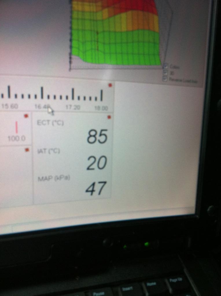

Originally Posted by Cass007
Just got another update. These are the temps after an hour of street driving:
Attachment 327261
Top # is water temp = 210.6*F
Intake temp = 93.6*F
Franz says the temps are plenty stable, so no overheating issues at the moment
I did the freaking math wrong the first time... apparently the Google does not know everything. I did it as *F = 9/5*(C+32) and the correct conversion is *F = ((9/5)*C)+32.
So correct coolant temp is 185*F and intake temp is 68*F ... Jeff wins a prize for being the only one to notice.
The car is home and is AMAZING!!! It drives completely different. I LOVE the sound and its even quieter at cruise on the highway than the previous setup, possibly because of the H-pipe. When I get on it people stare... I had a small crowd of employees at the toll plaza checking it out.
It drives like stock other than the shifter being a shorter throw and not nearly as smooth. Cruises at 75mph at 1900rpm in sixth and fourth gear is good for anywhere from 25mph to 65mph. The reverse is a bit tricky, but I will get used to it.
The clutch is much stiffer in pedal feel than before, Franz says its because the master cylinder SIKKY provides is very large. The clutch engagement is very high on the pedal as well, but the engagement is so easy vs the carbon clutch that I can almost let the clutch out with no gas in first on level ground and it just goes, even with the idle set at 800rpm.
ah, that sounds more like it!
