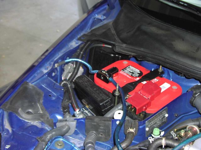

You only need 5 wires on the Z, the 6th is an unecassary option that hasn't proven to do anything enhancing.
If you have the 5 wire kit there shouldn't be a need to upgrade, I asked Guy all this when the 6th wire was announced and he gave me straight answers as usual and saved me money.
The new Z kits may be coming with 6 wires now, not sure on that (can't hurt but I think if that was the case the price would have increased?)
Haven't heard of a 7th wire on the Z.
Hope This Helps.
BTW, Here is how I did my 5th wire

Hi guys, here is an important question, that might have already been mentioned, but are you removing some paint on the surface to where the cables are bolted to the car's body? If ppl are just bolting them onto a painted surface... your not grounding anything.

Where would this procedure be necassary in the pics that have been outlined for almost 30 pages?
The factory ground remains, I am the only one who extended it to a different place and it is grounded properly for my application.
It's the manifold to the factory ground and the battery, where does paint become involved?
And where is my money from you stealing my power Mr. Enron Exec?

the bolts holding them in place make direct contact and are not painted.
