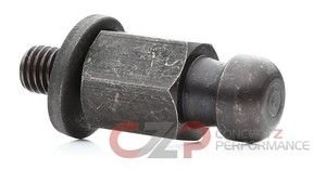

Would suggest you try the following simple things first:
- To answer your question: Yes, it could be a misaligned shifter guide plate. Check/adjust shifter plate alignment. This is an often overlooked step. ( https://my350z.com/forum/engine-driv...alignment.html )
- Check fluid - new CD00A (or any new) - as mentioned, the fluid in the new trans as shipped is for shipping only. Might be as simple as needing new fluid or topping it up. OEM Nissan MTF GL-4 spec 75W-85 or Redline MT-85 are recommended fluids.
- Check clutch engage/disengage - most likely hydraulics. Check for full disengagement and power bleed the system.
- Check to make sure you have the correct clutch fork pivot ball installed. '03 350Z (only + earlier Z32) use the long/tall pivot ball whereas '04-06 use the short one.
2003-Only
2004-2006
You need whichever one fits your YEAR unless you swap over clutch fork (due to the nature of the clutch fork - the '03 is uses a steel plated fork, all others ('04-06) with external fork use iron and they have different articulation angles). Using the improper one can lead to binding, which will not allow the clutch to be disengaged properly. I believe the CD00A ships with a short pivot (unless you stipulate its for 2003 model - not confirmed); obviously this is not suitable for '03 with original long pivot. (This is never made clear by any sources of this transmission - nor by Nissan as this is pretty obscure information.) This is a pain because you have to open the entire thing up.
Not heard many complaints about new CD009/00A transmission itself so thinking this is something related to the above. Of course, it could be the transmission but somehow doubt it. Good luck!

Now, the ball/fork is an interesting point. I'm using the new ball and fork that came with the trans, so they would both be the 04+ combo. @MicVelo Are you suggesting I switch back to an 03 combo, or that's unnecessary because my current combo matches?

@MicVelo Also Interesting with potential regard to disengaging the clutch... Prior to getting my new CD00A (I have an 03) I had ordered the complete clutch fork upgrade kit and had it in my possession... but with the new cd00a it came complete, surprisingly. So I returned the kit. I wish I had compared the depth between the cd001 and cd00a fork/pivot ball design vs old... While I did know of the difference, now that I have it in and experiencing such problems I wish I looked into it more but because it came OEM complete I didn't think to check twice as it was made for our Z (de models). I believe it may equate to the same distance as the new fork was alot thicker but even a 1/4 of an inch can make a huge difference in disengagement.

Welp just to follow up... The 06 pin is shorter!... How the internal parts appear the same on the dealership website is interesting, as they are certainly not... size difference is nearly 1/4 of an inch (Left digital caliper in garage) but with a regular ruler its about a 1/4 short. Usually people will raise hydraulic pressure (via CMC) and even extend a CSC pushrod for more disengagement and smoother shifting in some cases. So to see a smaller rod was interesting... Clutch slave housing however appeared to be the same not much difference... Experimental but I might just swap the pin in real quick to see how it plays out.
