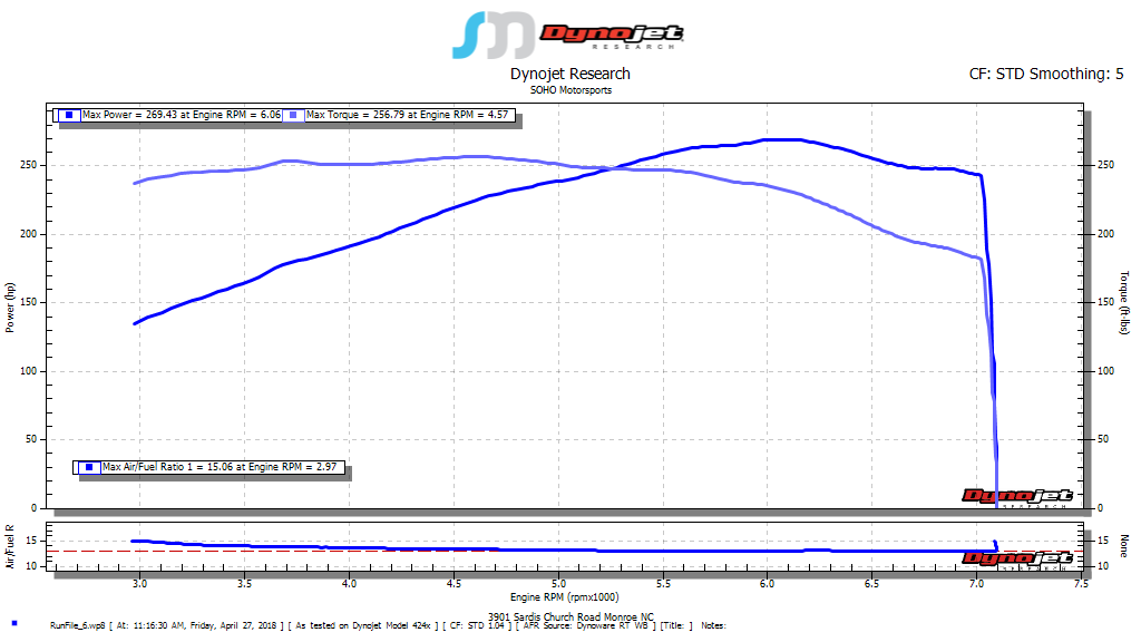

Everyone will tell you that going all out with all the NA mods is going to be more expensive in net hp gains per dollar as opposed to going FI. Now, with that said, I did not go FI and basically maxed out everything other than headers and I'm NA. I might do headers in the future but it is a lot of work for minimal gains. However, I do all the labor myself and I now have a 2-post lift in my garage, so I'll probably get bored in the future and do them, because why not. I like Tomei and will either go with those or Z1.
There's a great debate of true cold air intakes versus "warm air" intakes, or those where the filter sits in the engine bay. It really seems like splitting hairs to me. If the filter is low enough to stay out of the engine bay, then it's in danger of getting wet in my opinion. You can step up to a 3.5" or 4" intake, but you will most certainly need a tune immediately after install. As far as fitting it to your TB, you just need a compatible coupling.
I did the following "breather mods" and it made just over 269 hp at the wheels on the dyno after the tune.
- conical filter
- velocity stack/venturi ring
- 3.5" admin tuning intake
- 75mm TB
- Z1 angled plenum spacer
- Berk HFCs
- Motordyne Shockwave TDX2

I was able to make 281 whp NA with my '06 Rev-Up. That was with every possible bolt-on. I was about to do cams, but traded for a Mustang instead.

With test or ART pipes and headers, I might be able to squeeze out another 10 or so. I don't really care about numbers, though. My Z is more of a hobby/fun car and just something for me to play with. Might go down that boost rabbit hole when she hits 20 years since NC doesn't require emissions for yearly inspections anymore at that point.

You're not getting to 300 with "full bolt-ons" on a DE unless you're getting cams.
