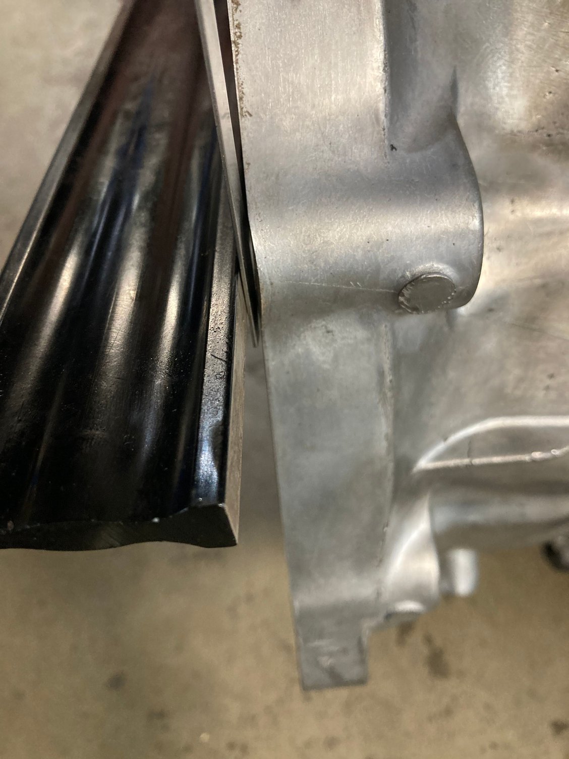

Today was a nightmare. shop left me a voicemail in the morning and i called them back. They said that the transmission is warped, and faulty from casting, off by 1/4 inch. They said they tried twice to put it on and something cracked second time. They said they already put a decent amount of hours into it, and im going to have to pay even more hours to put old one back on, and they cant keep it on rack forever taken apart..
socalz said thats an oem part shipped strt from nissan "let me check though". and i sent them these pics my shop provided holding a straight edge.
my car rental is extra expensive being summer at 300 a week.

OK, OP, I made light of the situation but wasn't kidding. The input shaft won't line up if the clutch wasn't aligned and I've heard of broken bell housings before because of similar hamhandedness. Problem is that the CD00A and most transmissions nowadays are monocoque, no separate bell housing. Hope it's not that and something simple, like a cracked clutch disc face or something. Easiest thing to fix.
so it could be the shops fault? and maybe i should tell them what you said? they claim its warped and seem to be not taking blame for it..

no lol, all good on the clusterduck. I went to shop and it looks like duck. its all wavy on side its not just one ear. and unless i misheard him, they changed their story to they hand tightened it, and it was already cracked. maybe miscommunication from mechanic to owner this morning. i dont see any bolt marks and doubt it was impacted.

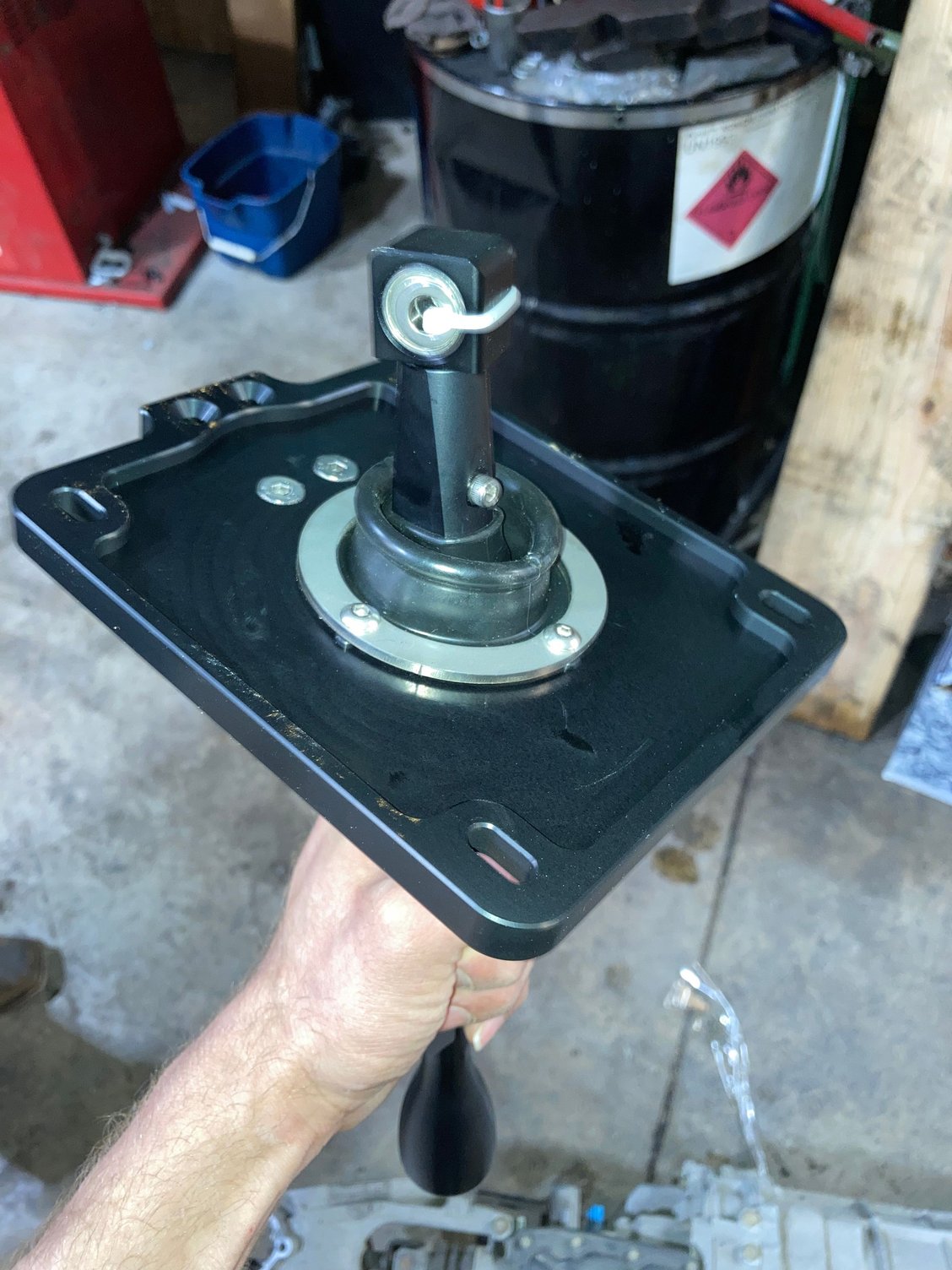

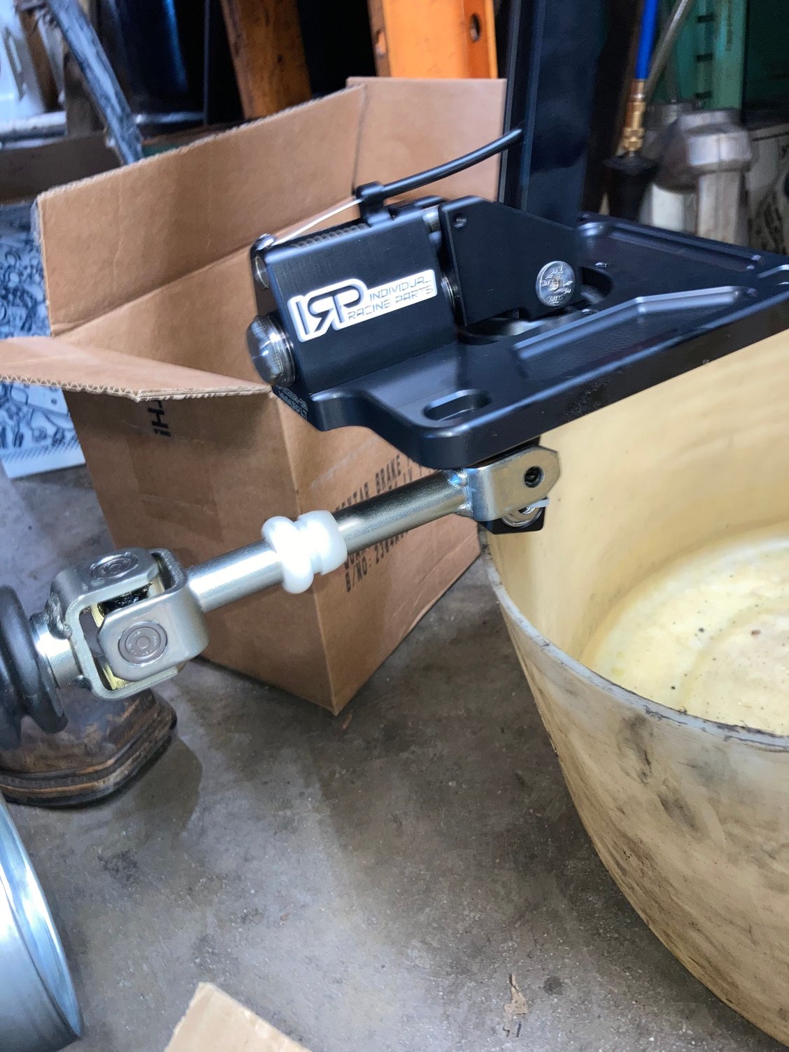

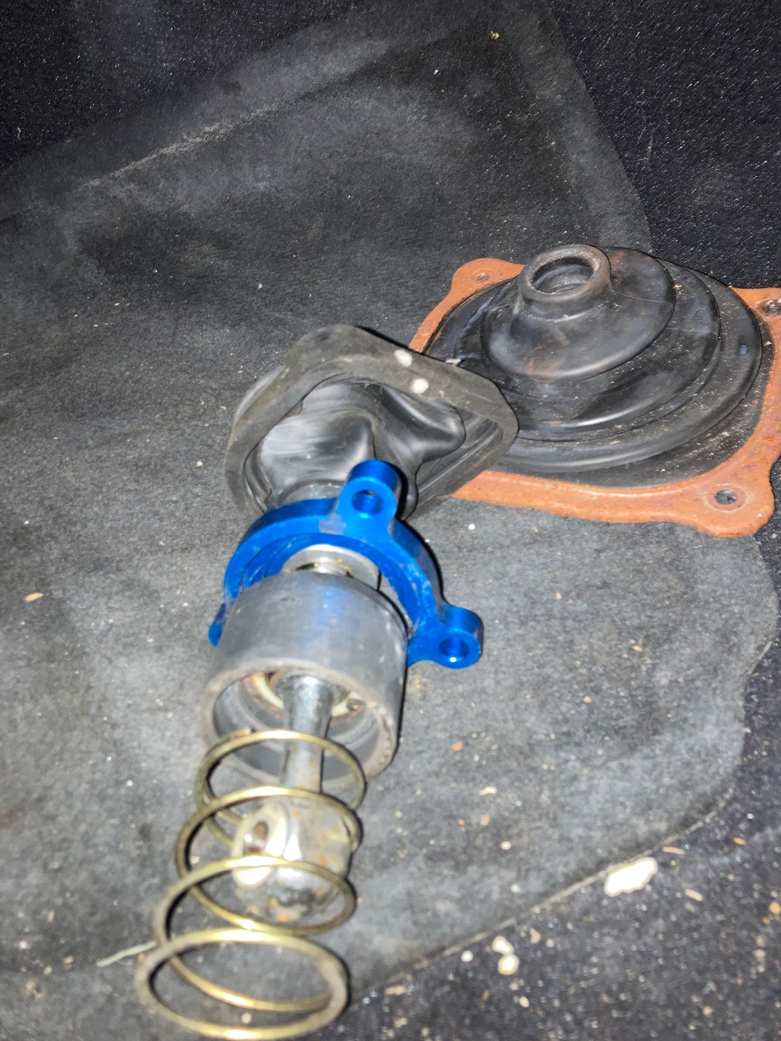

I do have one question guys and the mechanic seemed curious. so my new irp shifter has its own built in pivot for all directions, unlike the old shifter in photo 1. In photo two, is the bottom of new shifter. He said he cant even attach it to the shifter support bracket (that i bought cheap solid bushings for lol). So he plans on mounting the new shifter to the body of the car, and attaching it to the trans just like in photo 3. He said there will be more torque to the shifter or something and hopes it wont throw it out of gear, but its the only way he sees to do it. Shifter support bracket looks like a brace to me. i sure hope everything will be tight w out it and my 500 dollar shifter u all told me not to get lol

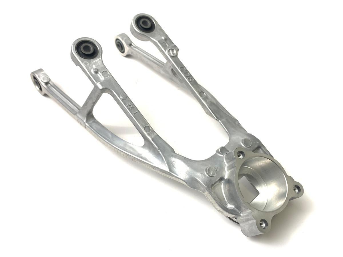

here is a pic of the piece, they will be completely removing from my vehicle tomm.
Old Apr 19, 2023 | 04:06 PM
  #439
MicVelo's Avatar
350Z/370Z Tech Moderator
Joined: Oct 2014
Posts: 10,315
Likes: 3,378
From: Northern California
Well, couldn’t follow your comments about the shifter but this pic is the tail assembly from a later model CD009/CD00A/JK40+ trans, likely with the CD02 case. Which means…. You already have one in the car.
So now what? I am incredulous that a Nissan trans could be THAT screwed up from the factory. Something strange is happening there. Hmmm…

well i know that "tail assembly" or "shifter support bracket" or whatever its called, is there. Its just my shop says its incompatable with my shifter and i dont need it, they plan on removing it. I just wanted to make sure i dont need to freak out and tell them that they need to modify it and keep it somehow. it will save weight but i get scared just taking stuff off.
yes really strange about trans. i have more pics but didnt want to bog down thread
