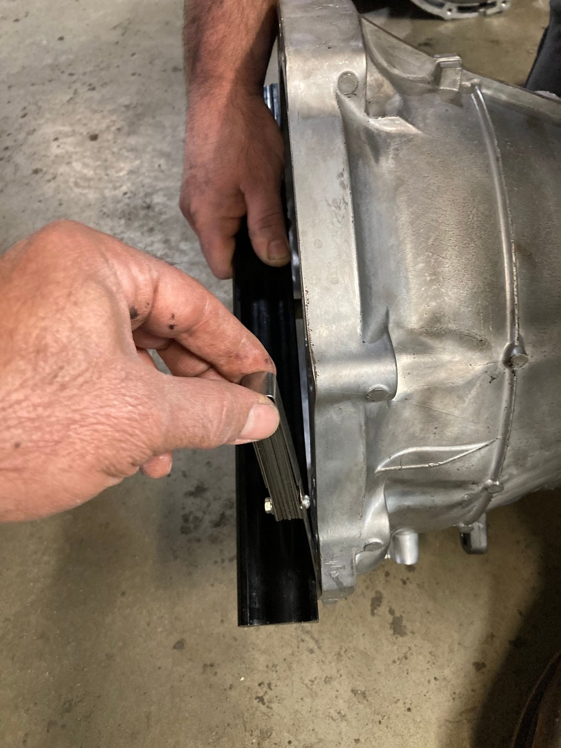

The shifter bolts to it... how is it supposed to stay in place with nothing holding it? The flimsy tunnel?
I am really questioning this shop's knowledge
My irp v3 shifter doesnt though. its all contained within itself. The shifter will bolt straight to the body of the car, then the bottom of it to the trans as pictured. The tech working on it is not familiar with my shifter though. So that wont work? i saw another youtube video of someone installing without taking trans off. They grinded out the inside of the "hole" on the thing they plan on taking off, because it would be in the way of the shifter. my shop plans on taking it off entirely, says its useless. I mean i did notice that instead of having three holes and a round shape its got 4, and is a big square. It def wont bolt to it

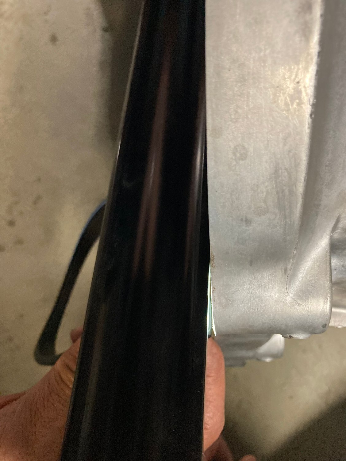

well i know that "tail assembly" or "shifter support bracket" or whatever its called, is there. Its just my shop says its incompatable with my shifter and i dont need it, they plan on removing it. I just wanted to make sure i dont need to freak out and tell them that they need to modify it and keep it somehow. it will save weight but i get scared just taking stuff off.
yes really strange about trans. i have more pics but didnt want to bog down thread
No, on the IRP or Coolerworx shifters, the support bracket goes away. As a matter of fact, if you keep it on (unnecessary), you have to machine out the hole that the stock shifter goes through (which you mentioned already). The aftermarket units are self contained and the actuator (the part that goes down to the trans shift rod) connects directly to it so the bracket is unnecessary. The actual shifter(s) mount to the trans tunnel (what your mechanic called "the body") using supplied lock down brackets and bolts. Moving the mounting points up into the cabin requires a longer actuator, which is why the new shifter looks longer by an inch or so.
It's a somewhat complex (or at least tedious) install. Mainly because removal of the shifter support bracket is difficult with trans in-car. Advisable to drop the cross member and lower the trans to get access to the top bolts holding the support assembly to the trans.
S'far as "bogging down the thread", hey, pics tell a thousand words. And, after 440 posts, who's counting anyways. Hahaha!

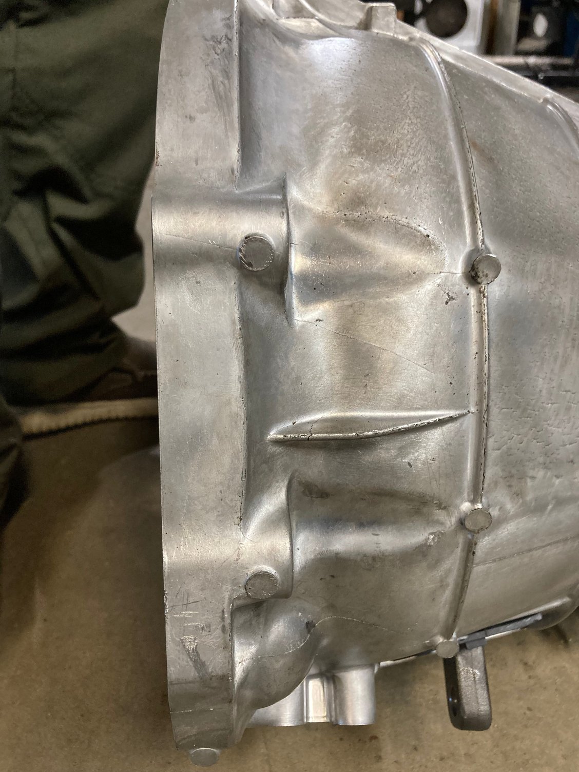

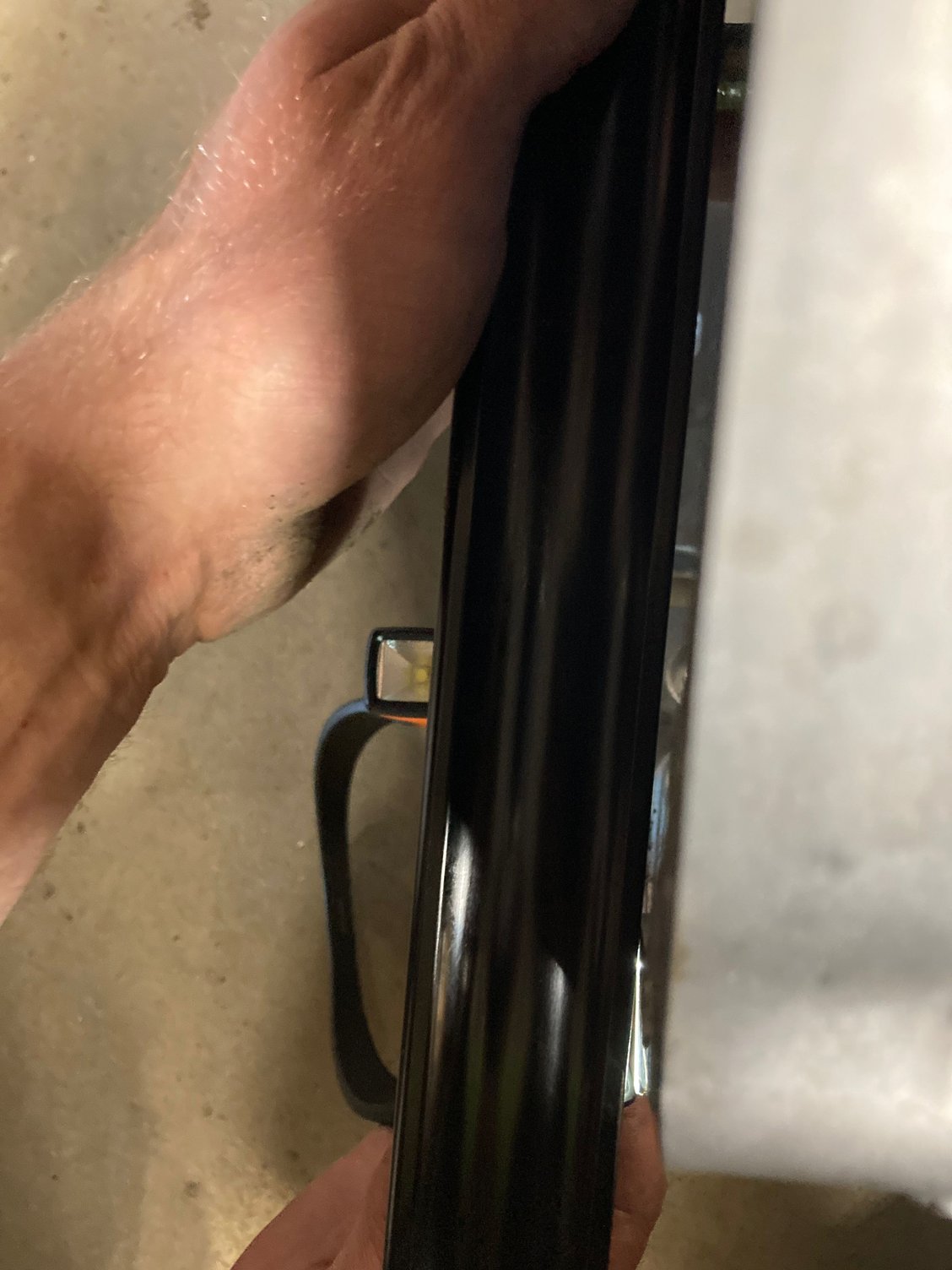

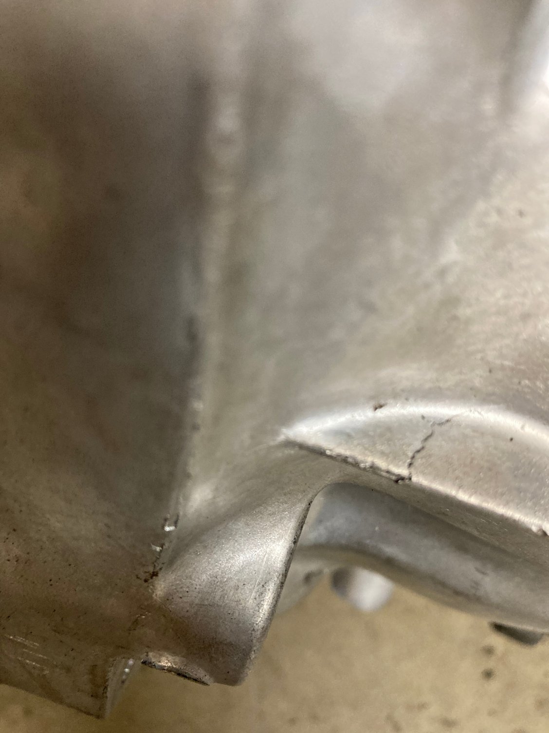

Thanks for the info!
you asked for it..
That last pic kinda shows the overal messed look from a distance that it has in person. its seriously like waved out on that one side, and goes in where its cracked
you asked for it..
Whoa, that's pretty funked up. In all my years in parts n' service have I seen a new capital part THAT screwed up. Sure hope that's going back to where it came from with new one turned around pronto! And someone is eating the freight costs.

wonder if someone dropped it

As Mic mentioned, that IRP shifter design looks similar to the Coolerworx. It does mount to the tunnel itself. Definitely tell your shop to use some loctite on those mounting bolts so they don't back out.
Here is a video of the Coolerworx install on a 370. It should be pretty similar to what you have going on.

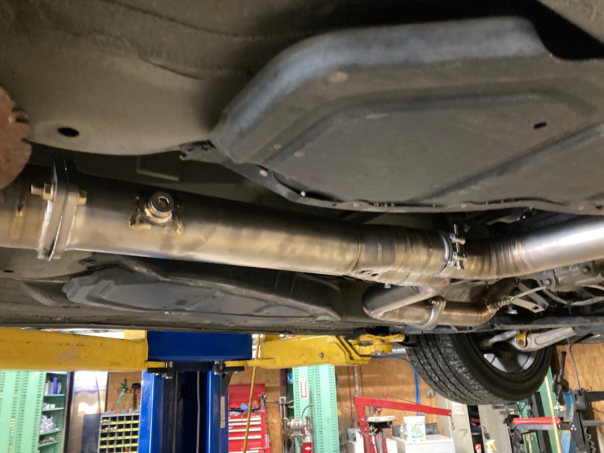

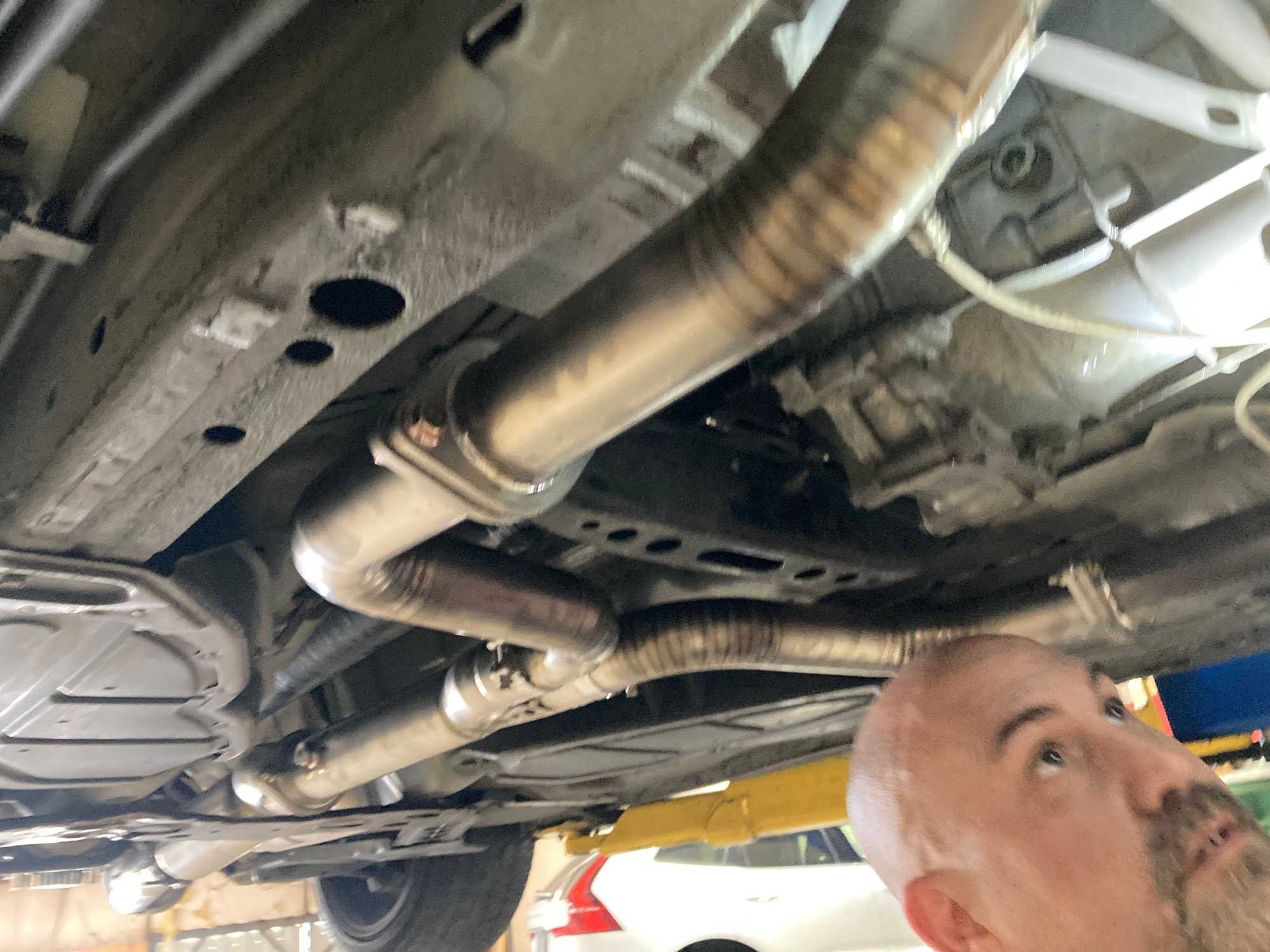

my shop randomly sent me these two photos lol. figured it would be good tomei exhaust ****.
ses vdc off and slip light was on. i may try to turn vdc on next trip, usually its on anyways.edit: second trip vdc off and slip light still on. thought it tried to engage on wet hill. maybe that was just wheel hop. pressing vdc off does nothing

Check the codes. Probably cam and/or crank sensor related.

Did you have cats before the test pipes, if so that is prob tge cause od ses light. The cement truck sound is because of the new flywheel

yes, i had factory cats before the test pipes. They were supposed to mount sensor on outside to trick it. I think they did. they finished in a hurry after trans issue, and putting project on hold for a day to figure out if i was putting old one back. I didnt want to rent another week. Im tempted, to just run it as is carefully and low rpms and keep saving for suspension, or last bolt ons and tune. Im wondering if the reason for the lack of power is its just a little lean after exhaust. The lack of power is not noticable, i just think i can tell it doesnt pull as hard. I opened engine bay and stuck my head in there while i revved it w my long arms and hand. Sounds great and runs smooth

The VDC and slip light won't be triggered by the test pipes. Go get the codes read and report back.
