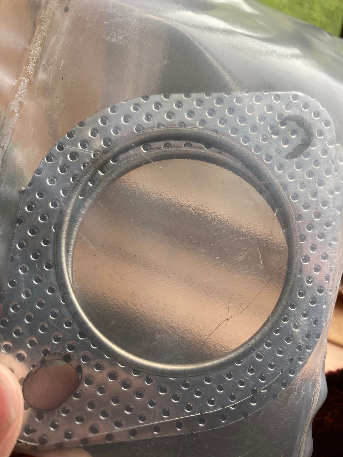

well thanks for the hoping it works out atleast lol.on a seperate note, i receive one part back after install of y-pipes and test pipes. I mean its kind of strange to me. it looks like tomei would suggest you use it. its obvious looking at my pictures it fits between the test pipes and y pipes
