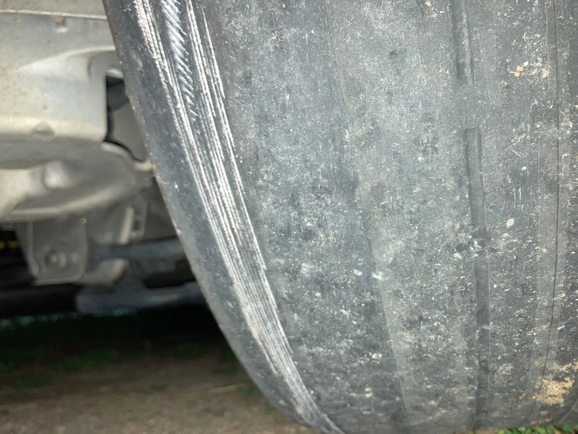

flame me

No need to flame you. Your rims will do it for you soon enough.

lol prob going for the two used tires tommorow because thats all i can afford until friday. I dont have much faith i can make it 60 miles each day until friday. Plus, i can save more, to do valve cover soon as possible.

Your alignment is way out of spec. I'm certain I mentioned this before that if you alter the suspension (as you have) and don't get it aligned, your tires will be toast. If you don't plan on addressing it soon, you may as well get used tires which will be trashed shortly and suffer the same uneven wear. Just burning through money at this point.
Do all your suspension stuff.
Go get new (not used) tires.
Get it aligned.
Avoid doing sick drifts in the meantime.

Post up the alignment sheet after Friday. I'm interested to see how far off everything is. I'm guessing the camber and toe is pretty bad as it is right now.

Get new tires before the alignment. If you get an alignment with trash tires, you'll need to re-do it when you replace them. Tires that worn changes your suspension geometry.
yes, it seemed fine really except the camber, after shocks and springs. but when they put that control arm and the ball joints on, it got worse. now its def out of alignment and steering wheel vibrates at fast interstate speeds. which is why im doing the non special alignment first, to try to fix that issue.
The "specialty"alignment i need the arms for, and i plan on doing seperate from head gasket, which im freaking out about. (Commute really may get shorter soon thankfully.)That shop also is expensive, and backed up schedule. May be why i have my shop throw everything on, and them align it. Thankfully ill have the arms they dont have to remove, to adjust. The two shops are a few miles from each other
