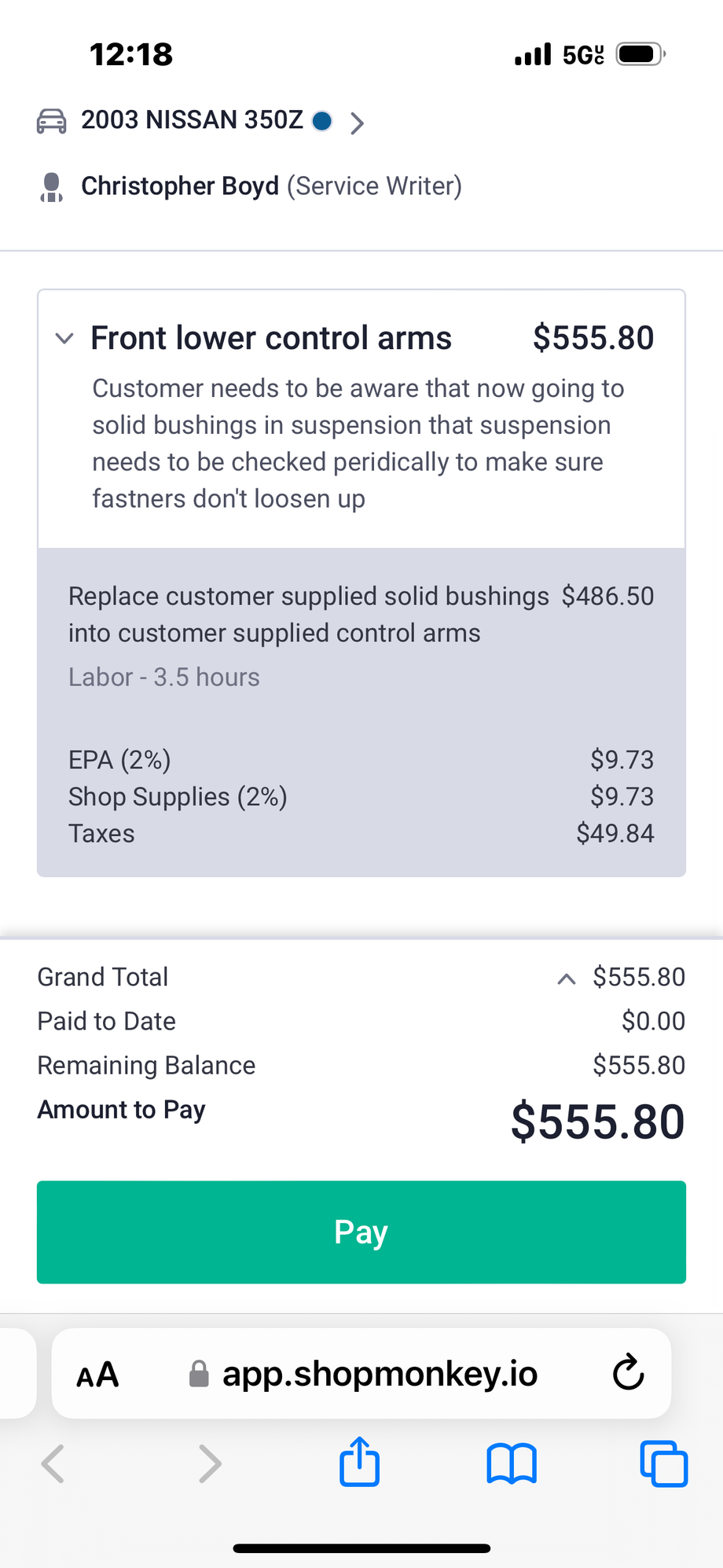

Originally Posted by luv350sass
I got the front lower spl bushings, that socalz didnt send, when i thought they did. I just had the front lower, and shock mount bushings done, finally. It was a nightmare. The front lower arms on my car, were oem spec but not oem. The spl bushings, were barely too loose. I had to pay over 900 bucks for new ones, and reschedule my alignment. The front was handling funny. I hope its fixed now. Im curious what my shop means, by checking fasteners.
They probably mean that since solid spherical bushings are less forgiving than OEM or poly, the bolts need to be checked to make sure they haven't backed out due to increased vibration or added stress.
Or they're just covering their hindquarters from an improper install and inevitable issues down the road once it starts acting squirrelly.

edit: and always thanks heel for being a big help. even the fastener thing helped. I talked to my shop too, and i wasnt sure if it was just the hardware holding arms together, or some weird titanium clasps like i saw on my set of nismo arms. Im overthinking it as always.

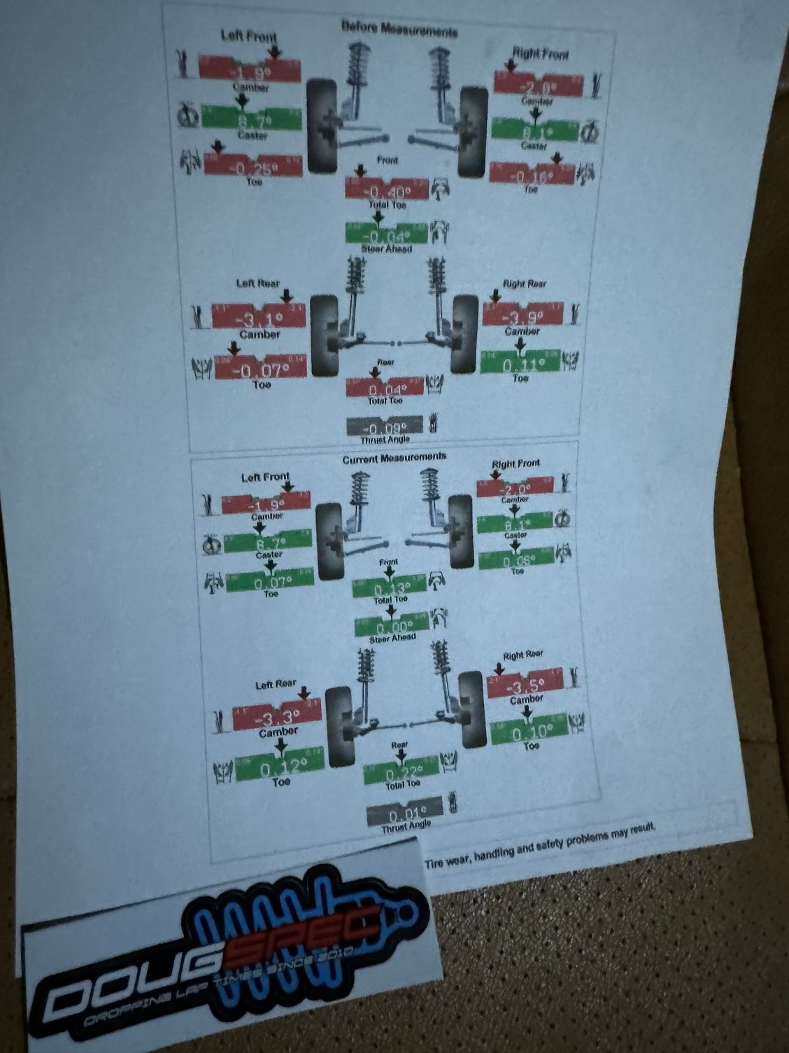

well, drove the car home, and the front suspension problem is still there... All of the front bushings are new. It makes popping or bumping noises from front left, over bumps, and bumps affect the handling. Ill add it to the list, to take it to the other mechanic, for proper diagnosis.

Christ, your rear camber is f***ed! Fix that. A street car should have very little rear camber. It reduces the size of your contact patch. The front should have some, but not that much.
I dont want camber. I want it ideal. The guy who aligned me really knows what he is doing. However, he aligns racers, and idiots who stunt around town. I didnt talk to him this time, but i think he did the best he could do, and i need the true coilovers. I dont have true coilovers, and the nismo arm says its designed for trues.
NISMO Billet Rear Toe Arms are designed for the Z or G owner who has converted to "true" style rear coilovers and wish to remove the stock mid-link / spring-bucket. NISMO Rear Toe Links replace the stock mid links to provide a wide range of toe adjustment, which is necessary for lowered cars or for performance alignments
no, you want you dont need. What you NEED is something like the spc front and rear kit
The brakes make a loud bssssjjjjjjjjjjtttttttt noise. Like its releasing pressure or slipped or something idk lol. Ive also heard a different noise, a clank that may be trans. It also doesnt really brake good when this happens. It takes a second after the noise when i slam the pedal super hard, then it brakes hard. It's delayed. I dont think this is brake fade, they are fine in traffic, this is when driving hard, trying to make a better time. I asked for them to change all four calipers, because i thought my powerstop kit (I didnt open and look at), had new calipers. My shop instead, only replaced one that was malfunctioning. I have one new oem(i asked for oem, maybe just oem spec), and 3 from 2003. I couldnt be too upset, because i could barely afford the shop bill.
It's hard to diagnose sounds over the internet, but it could be air in the lines, brake booster, or something else. You could try running DOT 5.1 (not DOT 5) if you think you're boiling your brake fluid since it has a higher boiling point than standard DOT 3. One would think that a mechanic's shop would have properly bled and installed your brakes, but there's no telling.
Get some adjustable rear camber arms and/or adjustable rear traction arms to get that camber fixed. Coilovers aren't going to solve that problem. If anything, they'll likely create more of them.
