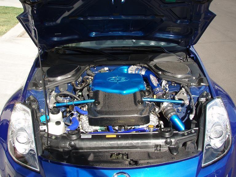

You gotta get the APS bar to go with it. Here's a better picture:
man thats nice. I guess thats the aps tallboy plenum. I dug around, and i doubt ill be able to find that on used market, but ill keep my eyes open. I cant find a cosworth plenum either. I noticed some of these cool rare parts, are more commonly available if you buy a car with the parts on it.
The kinnetix plenums get alot of hate, but the ogs on reddit are over there praising the velocity manifold, w dyno numbers. They said the velocity manifold got a bad wrap because of the ssv, and all the other horrible plenums they put out. They claim that if you just inspect the iffy build quality, the velocity manifold does numbers, even on a NA Z.

Yep. I had a lot of time and effort in that car. Sometimes I think I should've kept it and installed the JWT S7 cams I had bought for it, but I have car ADD. I get bored and trade out cars every few months to 3 years. 3 years is the longest I've owned a car. Had the Z from '06 to '09. Traded it in on a Mustang. Shortest time I've owned a car was 27 days.

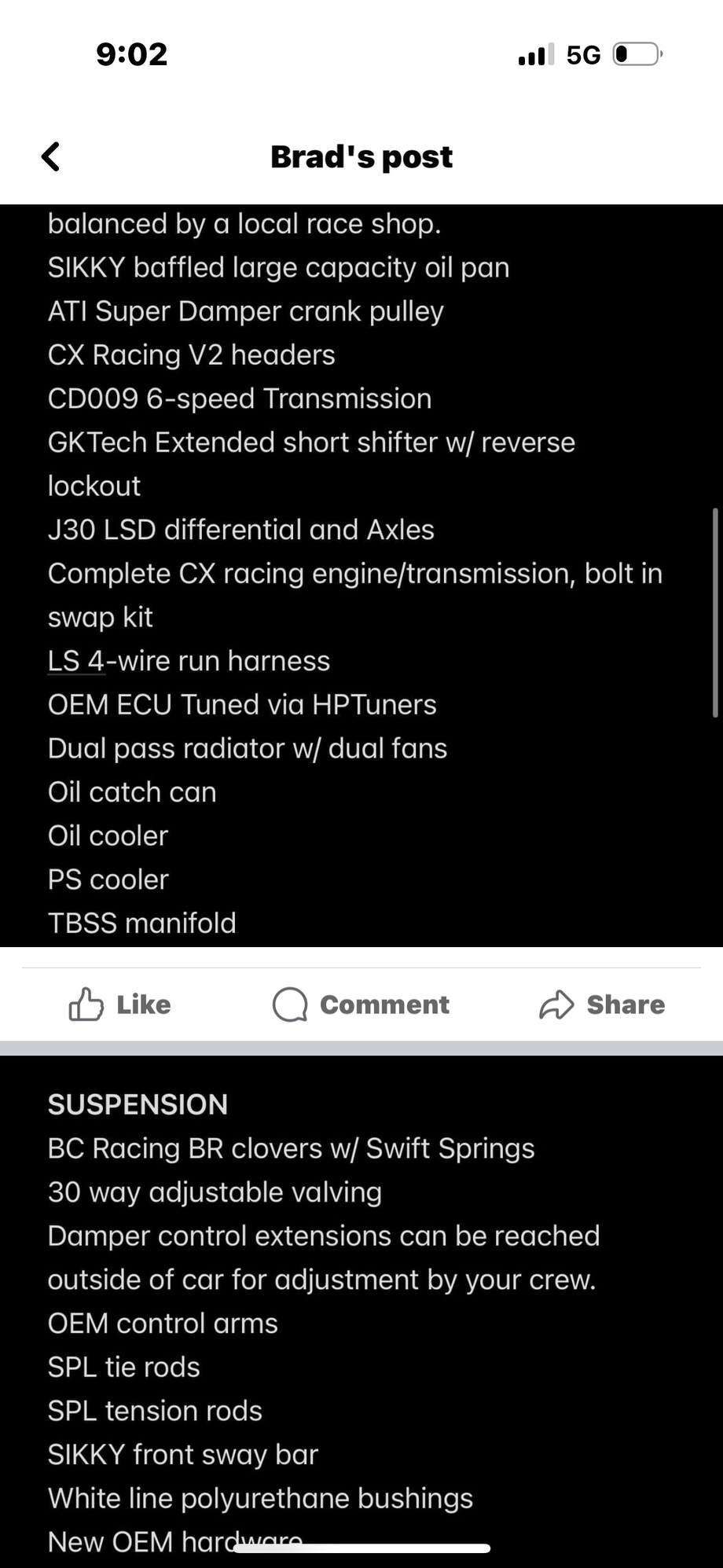

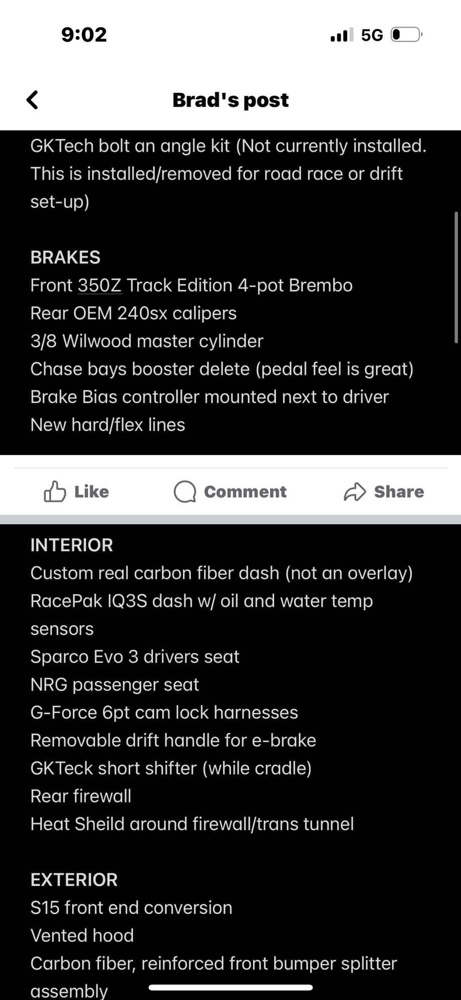

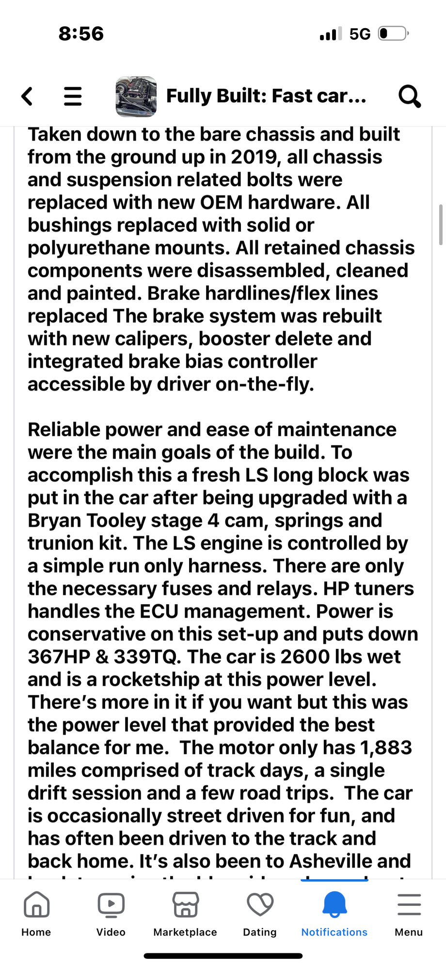

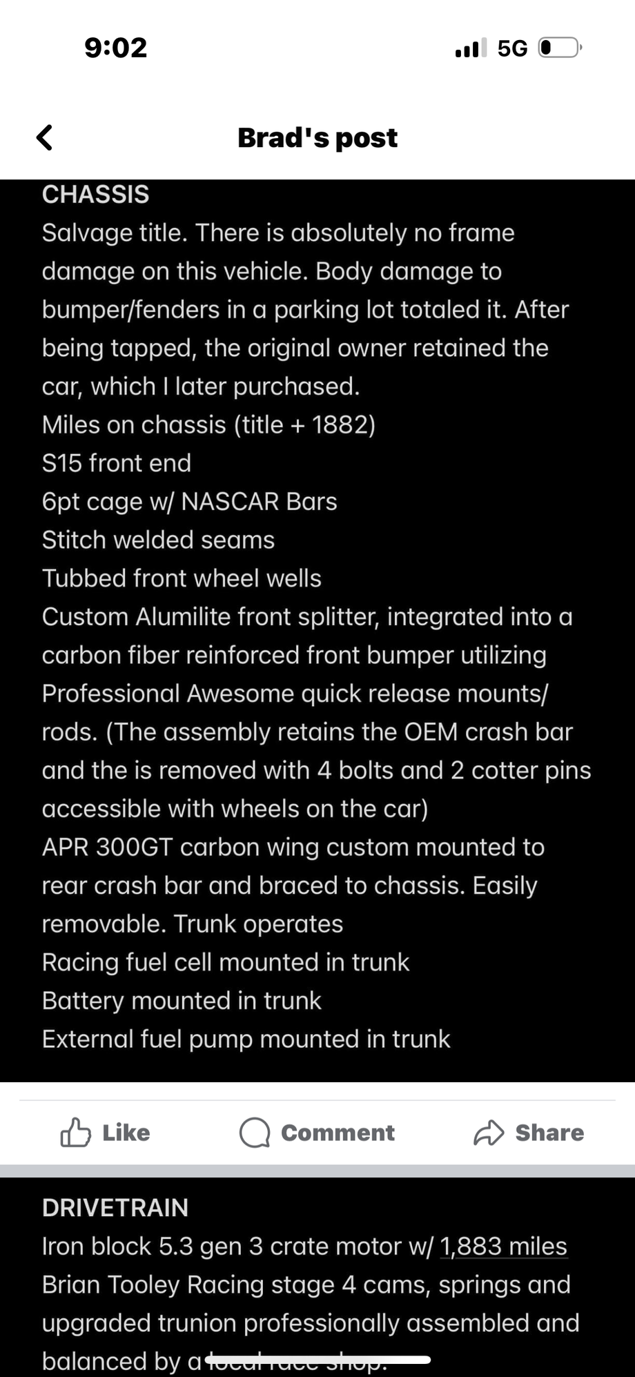

Well, Ive seen some wicked cars for sale. I used to never use facebook and im in groups, with built cars for sale etc. I saw a s14.5 for sale it said. Full padded cage, ls swap, car had been stripped down to chassis and every part painted and gone thru. All kinds of aftermarket parts. Power was in mid 300's, and can be turned up. He said it weighs 2600 lbs wet. 22k dollars, no ac or air bags and stuff. Its probably safer and, fast as hell with that weight. It also came with a bunch of parts! Cd009 trans and two r200 diffs. And i could have beat around town in anything.
Im also still eyeing this FBO hr, thats been babied to hell, with 50k miles. Its got a sound system, custom blue interior accents, z1 built r200 diff. Everything has been done except build, or boost. The bushings are changed. He has the z1 arms you have to take off to adjust. It has a tune, everything. 20k and he wont budge. I think with the extensive parts list i like, its worth it.
I could have got cheaper parts, but i do want what i want, and I still think buying that S14, wouldve made me way happier than building a z thats all screwed up and was 10k lol. Its interesting how i wanted the tomei for the sound/performance. Then i got it, and hated the sound til u get above 3k or so rpms. While i loved the sound at top end, i got pulled over again and warning for sound, and a little slide for turning left when it turned green. The cop was ahead of me and just heard it. Its like a cop beacon, and my neighbors are all grumpy. I dont like it for around town anymore.
