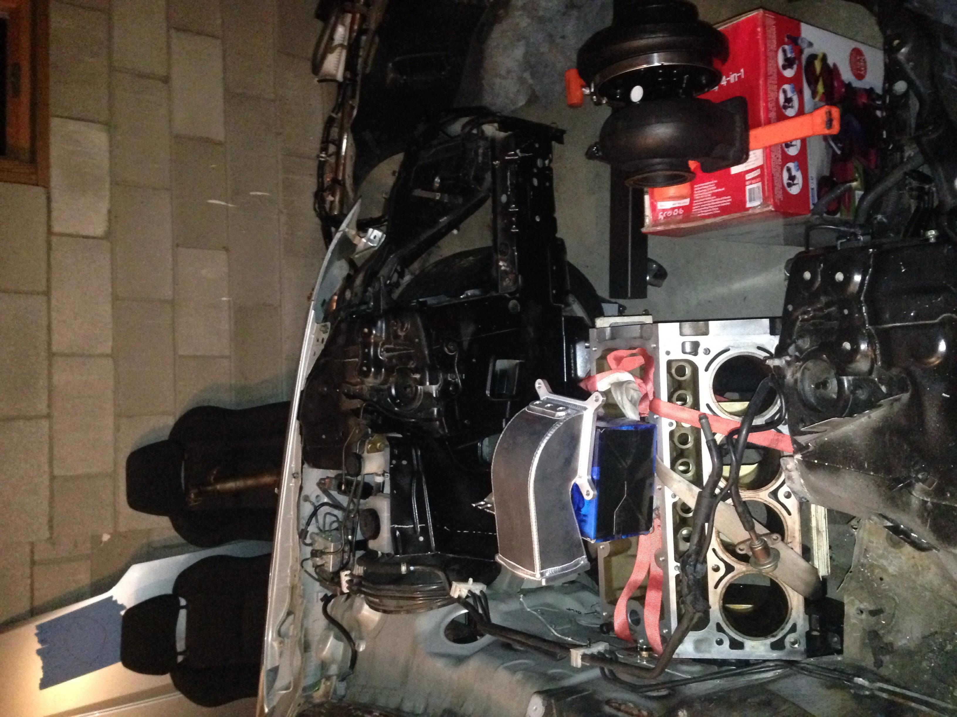

I cant speak for quality as i never seen one in person, it does look top notch. My concern is their engine placement, the shifter and the front sumped oil pan dont appeal to me.
I wanted big room up front for a front facing turbo set up, this is as far as i could go without relocating the stock firewall. Worked out really well, even with the accessories bolted on the entire engine sits behind the strut towers. Got rid of the boat anchor of a crossmember and the heavy motor mounts( using a front and mid motor plate which weighs 7lbs each) i wonder what the weight bias will be now... And best of all, no shifter extender.

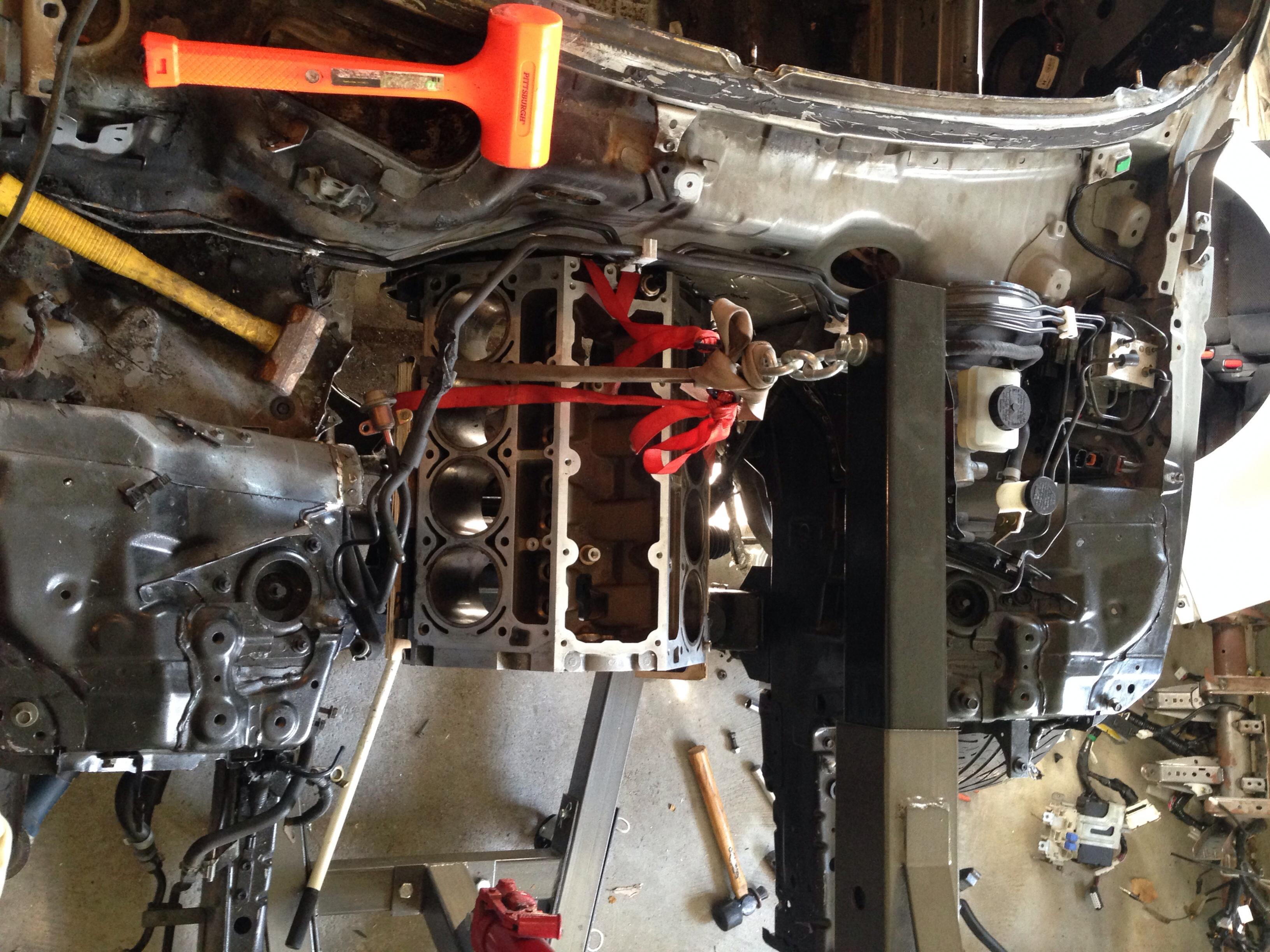

Here it is sitting on some temporary motor mounts , i will be doing alot more cutting on the engine bay.

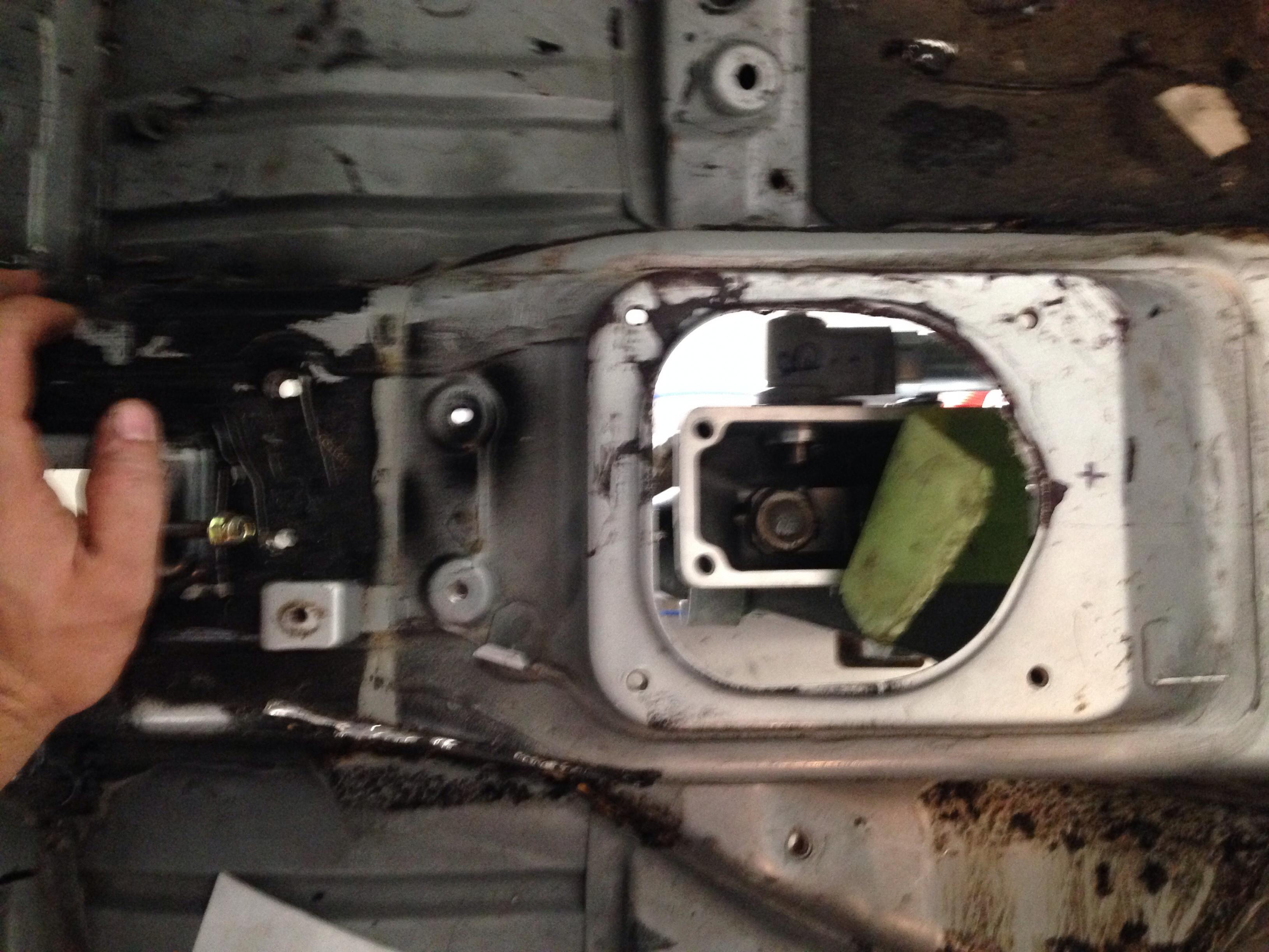

These pics are huge , i cant resize them on my phone.

Oh man, I see exactly where this is going!! Are you going to put a solid axle in the back?!? Air to water intercooler, this is a full drag setup!!!
