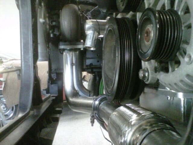

Old Feb 14, 2015 | 01:38 PM
  #1583
mkiv20vt's Avatar
mkiv20vt
Joined: Jan 2011
Posts: 190
From: Northern FL
THANK YOU. This is great.
DP goes in between the pass mani and block?
Old Feb 14, 2015 | 02:59 PM
  #1584
sidewaysracin's Avatar
sidewaysracin
Joined: Jul 2008
Posts: 116
From: Mn
DP hoes between the engine mount and the front crossmember
Old Feb 14, 2015 | 03:56 PM
  #1585
mkiv20vt's Avatar
mkiv20vt
Joined: Jan 2011
Posts: 190
From: Northern FL
Thanks! Good lookin setup. How much are you trying to sell the current setup for?

Originally Posted by sidewaysracin
Looks like a small intercooler, any plans on upgrading it?

I have it listed for $4700 shipped for everything and inter cooler.
And no, this inter cooler is good to 1000hp so until it's an issue I won't change it

It had a single puller. The new setup is gonna have twin pullers and lean the radiator forward a little for more room

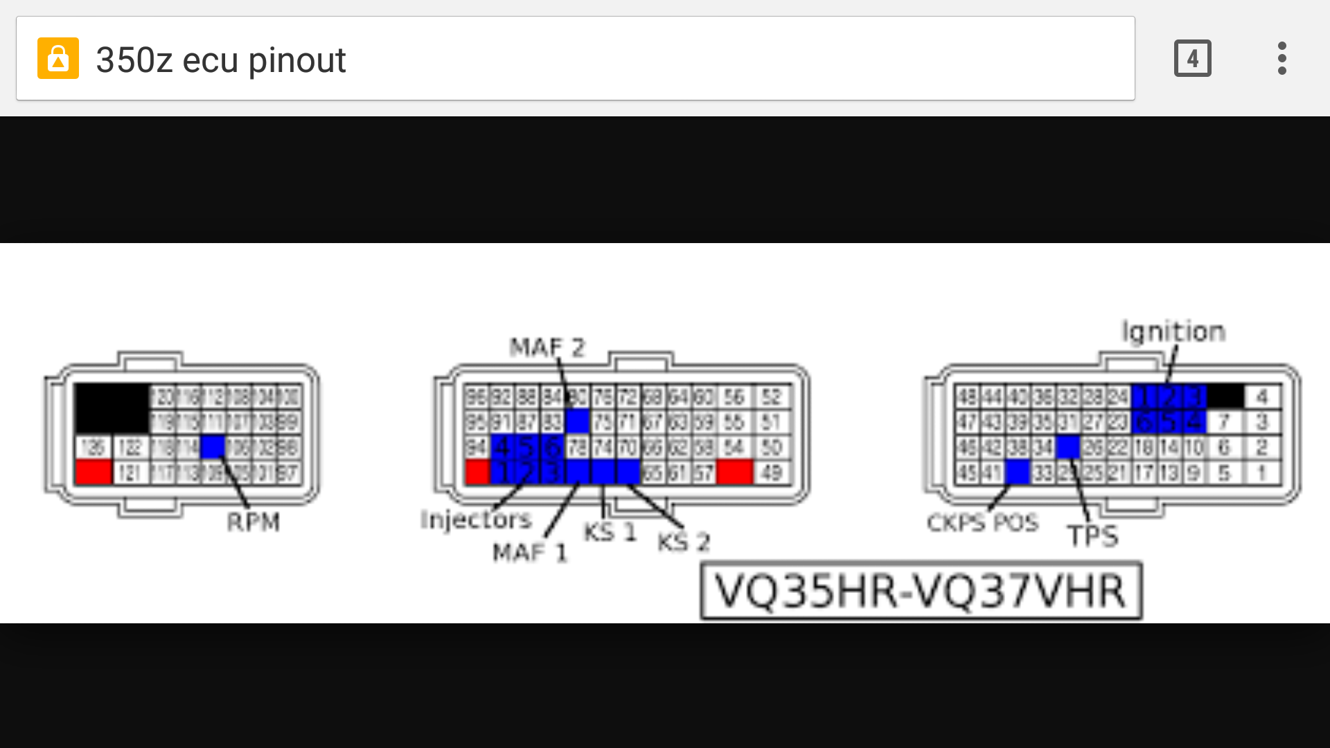

Question for the guys keeping the VQ ECU for the water temp gauge to work.
Did you remove the engine harness completely and run a wire from the sensor directly to the ECU pin? Or does the ECU need the engine harness to power up/ground?
Anyone?
I removed the engine harness completely. And found this ECU pinout. I'm thinking about connecting the power/grounds and connect the water temp sensor directly to the pin.
