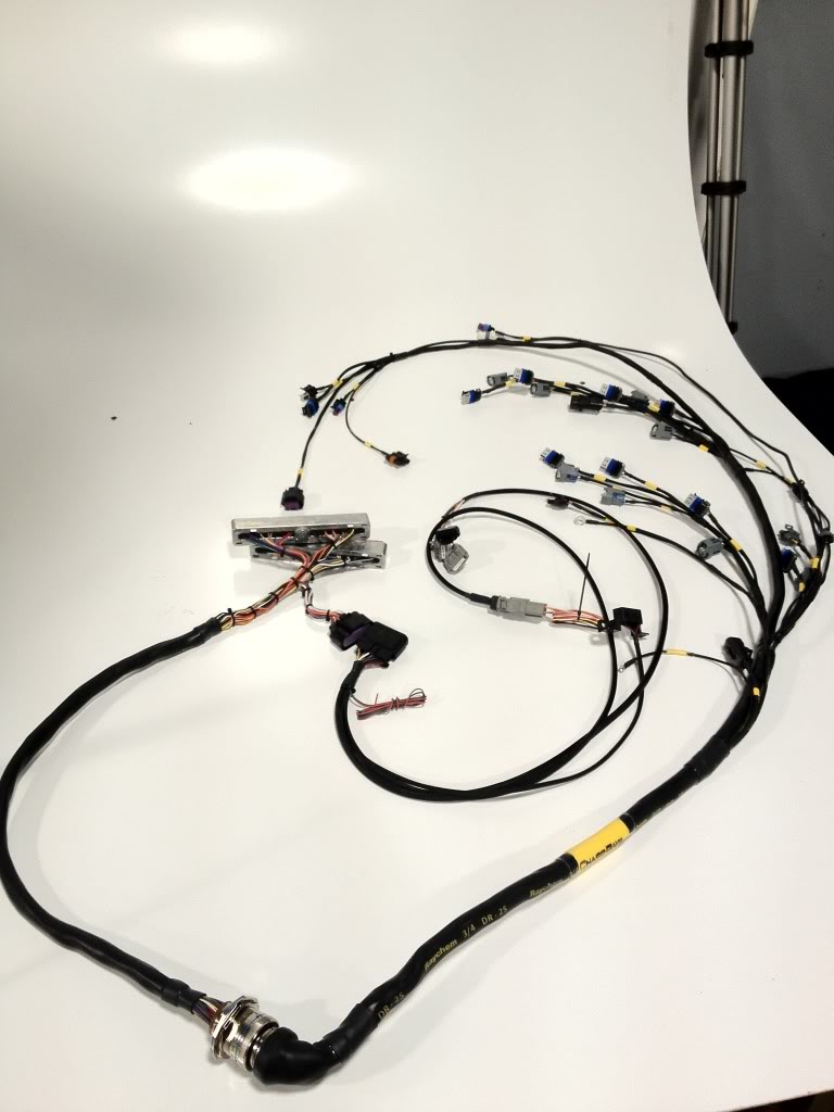

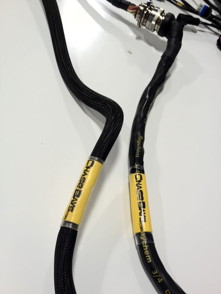

My old harness loomed in the Nylon braided loom- Does not come with a Cannon plug disconnect - What we call a CM1 harness. Goes directly from the motor to the ECU like stock
The Mil-spec harness comes loomed in the Raychem DR25 high heat and diesel fuel resistant heat shrink and individual sensor labeling. It will also come with the Mil-Spec cannon plug quick disconnect
The original harness was only used for mock up and testing. No sense in using the expensive loom ad cannon plug for mocking up and testing

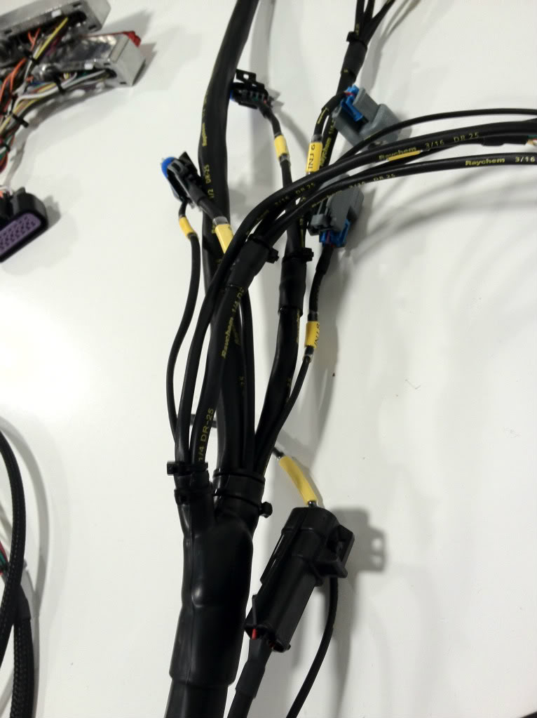

here is a picture of the individual sensor labeling
