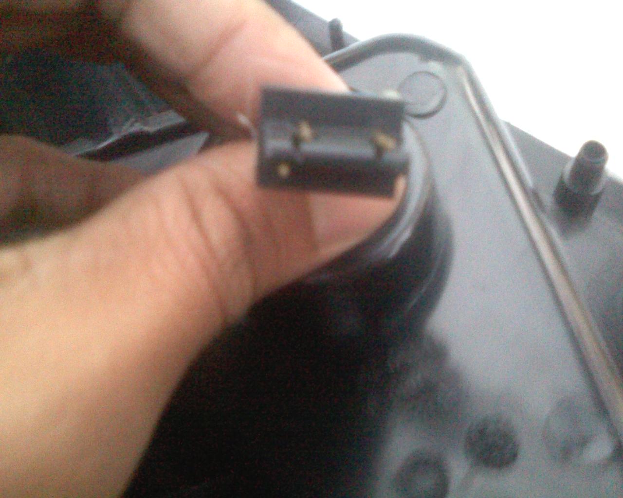

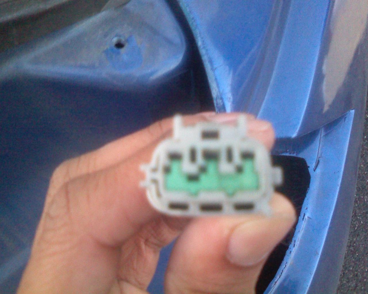

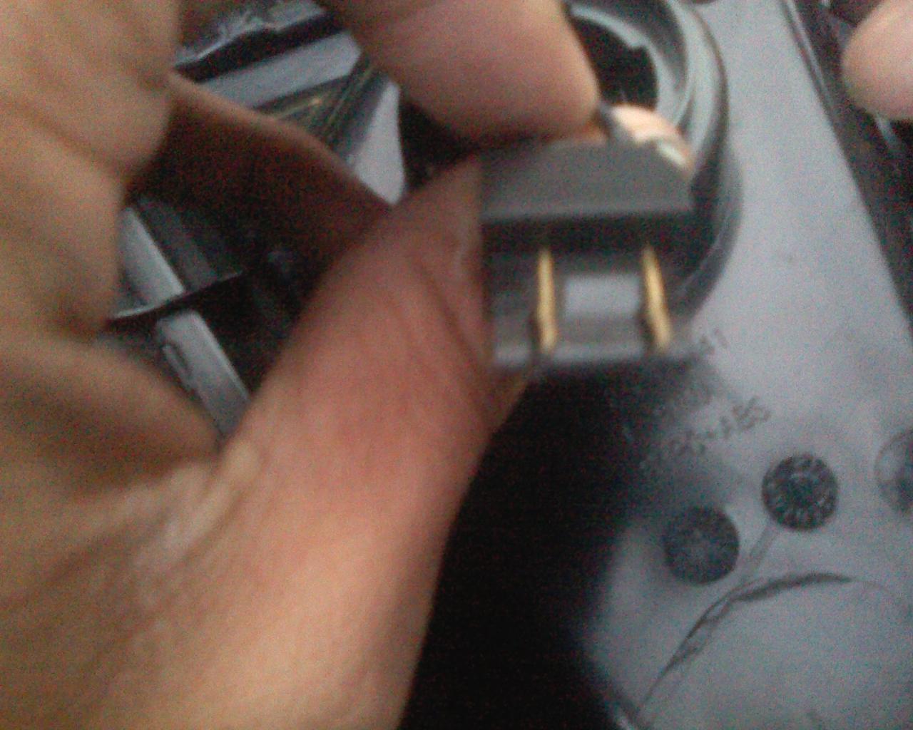

Whats up guys. I just got a set of the "oem style" tail lights off of ebay (i know i know, but whats done is done). I have an 06 z and the tail lights say that it fits the 03 to 06z. However the plugs dont seem to fit at all and I see no way they can work. If anyone has installed aftermarket tail lights on their 06 and up please help me out.
Here are some pics. The first one is what the after market tail light needs to plug into and the other two are the tail light's plug from two views.
thanks in advance.

Are the eBay lights also LED? The 2006 had LED, correct?
Provided it will work once connected, then your problem is in making that
connection. More aptly put, in connecting two incompatible male/female connections.
You can either salvage the required male plug from your OEM lights (That I'd like to buy
if they are LED) or you can find a salvage yard unit to remove the plugs from or you can
abandon the OEM end of the harness as well as the end on the eBay lights and use your
own set of male/female plugs.
This would require soldering and cutting the OEM wires. Not the route I would take.
PM me if you want to unload those OEM lights, provided they are LED.

your doing it wrong.. just take out the bulb, and plug in the wire that is on the ebay lights into where the bulb goes in the socket.

Those are LEDs, there are no bulbs per say. You can't plug it the way it is now, you have to use your brain and a multimeter and figure out what is ground , what is running light 12v and what is brake light 12v. From there I would suggest you cut the female end off your broken tail light and the oem non-damaged one and also cut out the plugs from the new taillights and retrofit the connectors to make it look oem, or solder the wires individually after you cut the connectors out. Since money is an issue ( I'm assuming this was the case, or else why didn't you buy an oem set) your best bet is to find someone that can guide you through the process of cutting the wires and making a good connection. If you had the knowledge to do such thing this thread would not excist, so I am assuming you lack said knowledge therefore advising you to have someone with experience handle this.
