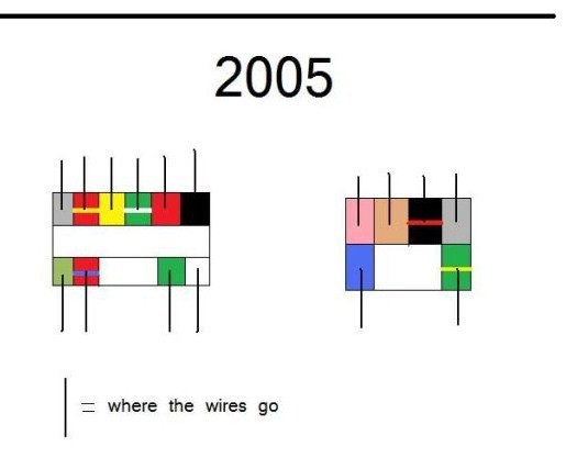

Hi all. I have an 04.5 touring w/o nav. 2 days ago i pulled out my bose HU to fix the cd changer ribbon issue and it is fixed now. Now there are 4 harnesses concted to the HU (2 upper, 2 lower). As i was pulling out the HU, the 2 upper harnesses got opened and the wires were all over the place. Now i found a color diagram online and installed the wires accordingly (see colored wire diagram pic below)...everything ran smoothly until it was night. I turned on my headlights and the lights on the HU illumination did not turn on..in other words when i turn on my headlights, nothing changes inside the car. The TSC, Heated seats, HU, and other console lights dont go on. I pulled out the HU again a while ago and checked the wiring..it is just like the pic below and everything seems ok. Also i checked every single fuse in the car and everything was ok..Any help would be really appreciated. thanks

wow no didnt know there were fuses there...should be a blown fuse inside that box...thanks alot nismoZR!
