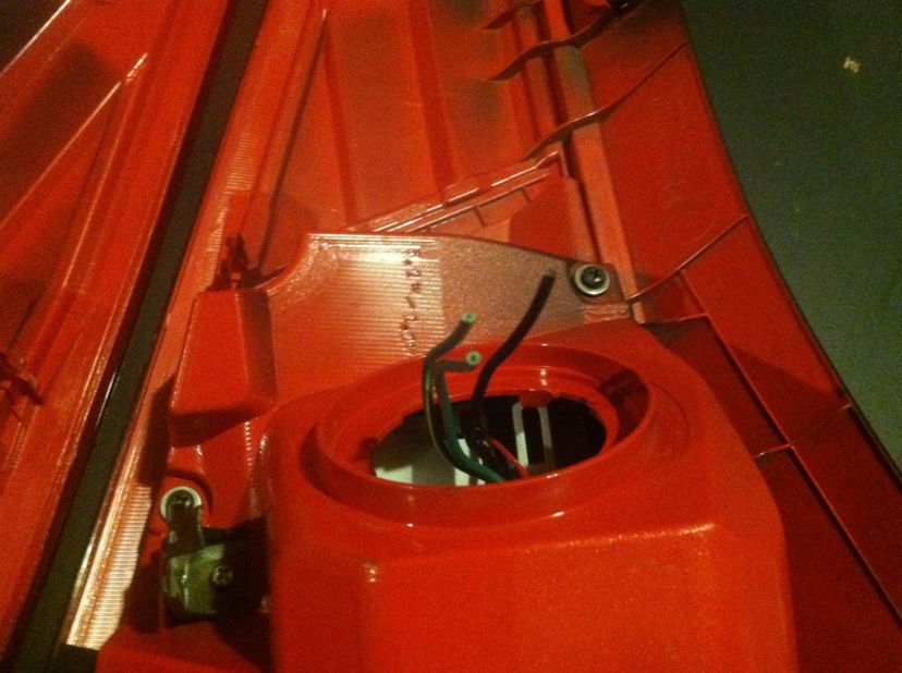

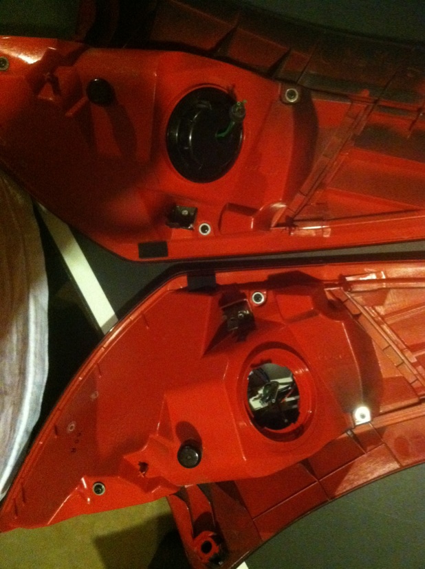

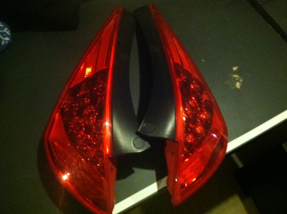

Hey everyone, hopefully I'm posting in the right section. The story is someone I know is selling the 06 LED tail lights for $150. The thing is, he cut the connectors off. Is it seem worth it to buy it without the connectors? I know its a easy DIY from what I've seen from when I searched, but those already had connectors. Would taking the connectors off my current 05 lights and soldering them onto the 06 work? Or just stay away and wait for one in the marketplace? Thanks

I can't tell if your friend cutout the entire harness or just to connection to his car.
Can you try to get closer photos with more light? so we can confirm

Ummmm. Do you know wiring? You'll have to hard wire
Them to the car. As big of a discount as you'll get on these...

Just wire them up and you should be fine. Either snip the other connectors off or just splice into the wire behind the connector.

@DavidV. No sir haha As for the pictures, I can look into getting more. Wasn't really shopping for them, kinda came across the deal, so not like I have to get them. But it was a planning to down the road.As the actual work not really worried, I work for an automotive supplier, and building harness's is a common job I'm required to do. Guess I need to do some research on finding the connectors before I decide to pull trigger. Thanks for the input guys! And if anyone knows of some mech drawings or what the connectors are, that would save me some time. Thanks!

They would work.....I noticed that the one taillight has no black cover....also are the prongs intact so it stays in perfectly?
