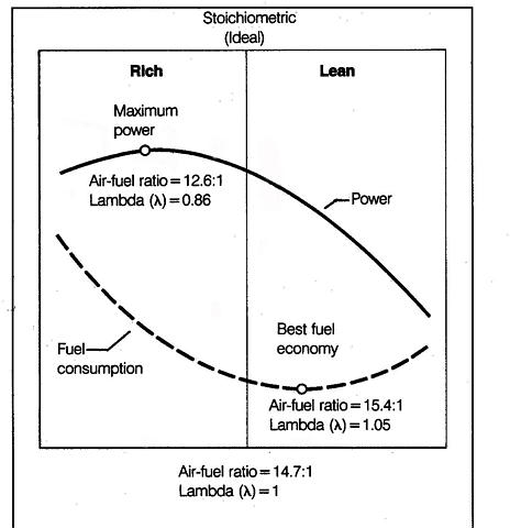

Oh boy more lean is more power I think. Have to install AEM UEGO and check it out afterwards. I think the Greddy TT is easyer to tune but harder to install.
What a ****ing desicion.

well...actually, more lean can mean blown engine. the hks kit is the most conservative fi kit offered. the greddy is the most aggressive and has blown up the most engines. there are many other good, safe choices in btwn, vortech, aps single and twin, turbonetics single to name a few.
i chose the hks cuz i wanted to start conservative. sounds like you need to take your time and do a lot more research cuz you named the two extreme setups, which are vastly different. check the forced induction forum.

this graph may help you:
Attached Thumbnails HKS Super Charger Installed "WOW"-stoichiometric-20graph.jpg
