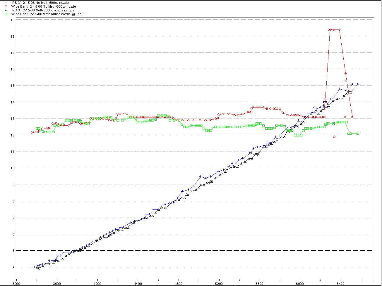

just an update to my post above.
Put in the 600cc nozzle and saw a nice drop in A:F. between .5 and 1 point above my spray zone of 8psi. Whoo hoo. Without meth, i had knock and my timing was retarded (that why AF looks funny at the top on the red graph). Exact same map, just meth on vs off.
The working meth, new return fuel system, and a new tune in a week in a half should be sweet!

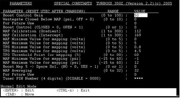

/\ I know what you are talking about regarding temp changes and Air Density changes. I'm just making it a little simpler since base on my logs and Utec, it don't matter what is the ambient temp since my timing will not change. For example, I may hit 5psi at around 3300rpm when the temp is around 80F, now my timing map is set to run 18 deg at 5psiX3300rpm. Now the weather got colder (40F) and I start to hit 8 psi at 3300rpm, now my timing map is set to run 16 deg at that area (8psiX3300rpm). Utec does have a Temp Compensation feature (Not the best) but I'm only using the A/F adjustment and left my timing unchanged.
The way I see this is that my timing is already laid out using PSIXRPM from 2000RPM all the way to 8000RPM and boost from 0psi to 10psi, I may hit boost early coz of colder weather but I already have a preset timing I want to run at any RPM and Boost. Yes, 8psi at 90F has a different Air flow compare to 8psi at 40F but Utec is already compensating for that change right?
I just used the word Load since Utec use the Term Load Column which in reality it is PSI/Boost. Utec has 10 Load Column that you can set (I have mine 1-10psi). Now if my Meth kit start to spraying at 5psi then all I have to do is Tune my 50% load column (that is 5psi in my setting) all they way to 100% load column (10psi) since that is where I know I have Meth to back me up. I think I'm getting more confuse here It look easy in theory right but I think will still have my tuner do the tune for me.

Like I said in the previous post, there are a lot of FI'd cars using Utec and most of them if not all uses MAP and not MAF. This came from the Utec Manual that will explain what is Used in their Load Column.
11. MAP Minimum Value for Mapping is the lowest MAP value in psi for the MAP referenced load columns in the fuel and timing maps (the 10% column). This parameter is only used when MAP is selected as the Load Indicator in the Open Loop fuelling Parameters menu.
12. MAP Maximum Value for Mapping is the highest MAP value in psi for the MAP referenced columns in the fuel and timing maps (the 100% column). This parameter is only used when MAP is selected as the Load Indicator in the Open Loop fuelling Parameters menu.
