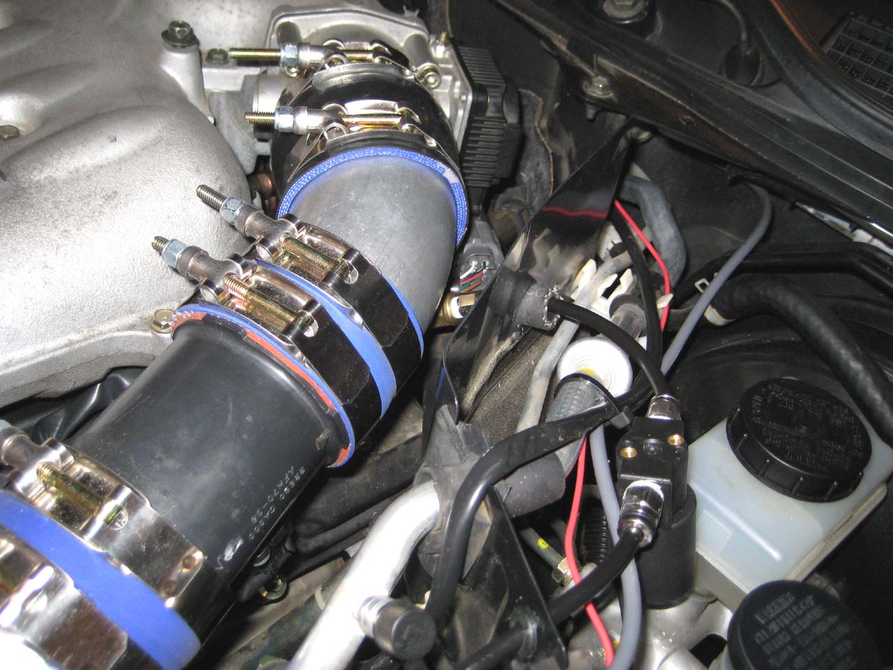

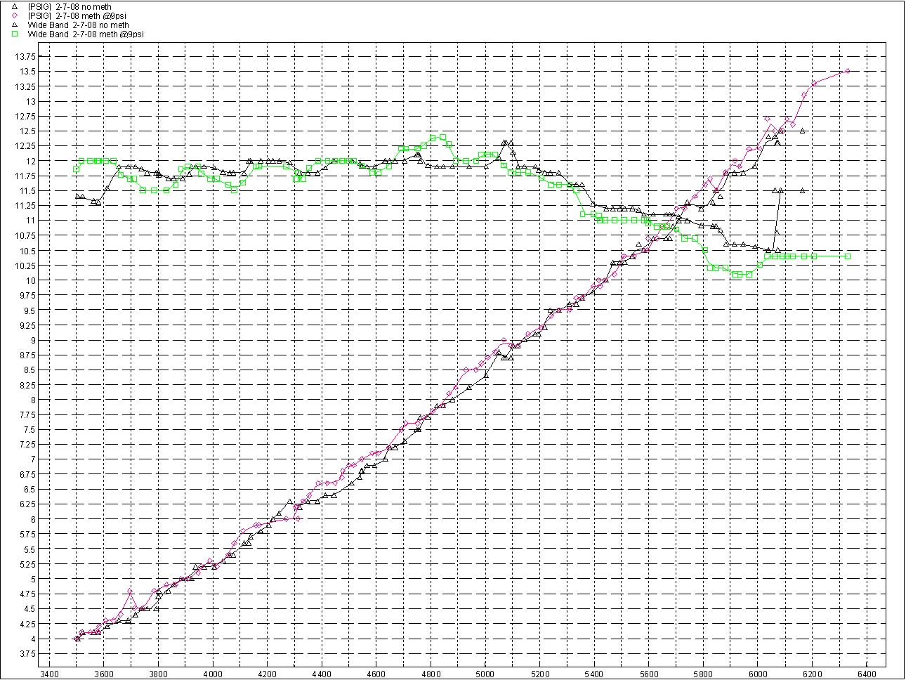

So to revive an old thread. Just put on my meth kit. I'm using a 400cc nozzle with 50/50 MeOH/Water
The pump turns on at 9psi (about 5100 rpms) as controlled by my UTEC and verified by a green LED i have on the dash.
I've read from Snow that you should see a 0.5 to 1 point richer AF once it sprays (which is any point 5100 rpms there should be noticable drop in AF). I'm barely seeing any richer AF.
Both runs were done on the exact same map, the only difference being meth being meth vs no meth.
According to Snow, my tune should be leaner before I start spraying, but the relative drop in AF should be the same.
So whats the deal, bigger nozzle?????
I wish my UTI software could access the dashboard, then I could log IAT.

Utec IAT temp will be off since the Intake Temp Prove is by the MAF sensor. The only way you will see a drop of temp is if you are spraying before the MAF Sensor. If you are not seeing any drop on A/F then by Snow's instruction then you are not spraying enough and vice versa. One thing I don't like about the Snow kit is that you have to keep changing the nozzle to get the right amount, does your Snow kit has a Tune **** that you can increase flow without changing the nozzle like the Coolingmist/AIS kit? I have read the Snow Instruction and you are right about the expected drop to .5-1 A/F and if you are out of that range then you have to change the nozzle to the right one.

One thing to consider is that are you sure your are using a 50/50 mix? The A/F drop is directly related to how much Meth is in the mix.

There is a screw on the black regulator housing on the pump. Turn it clockwise about 2-3 turns to increase the pressure of the pump. It can go up to 200psi. Try that first before switching nozzles and see if the AF richens up. You should be seeing at least a .5 A/F drop with a 50/50 mix on that nozzle size.
Btw, did you happen to take dyno's before and after the injection? How much did the 50/50 mix add?

I have the Snow kit on my car . I start the pump and spray at 7psi which is 1/3 of the total boost and ramp up the spray all the way to redline and 20 to 22psi of boost . This is from the Snow instructions

If I remember right its the 400 nozzle . And yes...I saw a 1 point richer A/F
