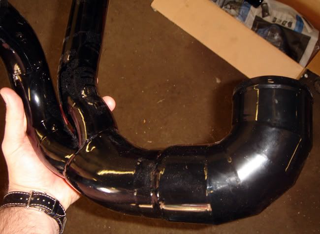

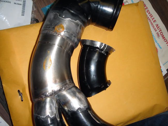

This is a must mod for the PE kit IMO... Here's my modded y-pipe...

Default ^^^^^nice^^^^^^
Who did the customization for you (Y pipe)?

Don over at www.straightlinetuning.com

(nice ypipe mod btw )
