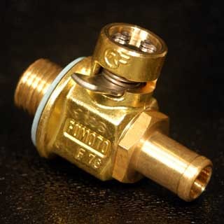

this garbage just happened to my aps now im gonna go with this fumoto drain 16mm x 1.5, ordered
I have this as well, waiting to lower the car to make sure I am 100% clear

I got the Fumoto for my setup after reading this thread way back. Mine has some hard scars on it from hitting a few things, but it has help up like a champ and still works fine.
It will go to whomever buys my APS TT setup, yet another added value

just popped off the oil pan today, did you use loctite thread sealer on the oil drain tubes?/ nevermind i read the instructions wrong, should be installed with the fumoto this week.

couldnt get my oil drain plug out for the life of me just kept spinning free, so i just dropped off my pan and fumoto at the local machine shop yesterday,cant wait to get it back and try her out

got it all mounted up and done, i thought my fumoto was broken from the factory but after really really torquing that switch it finaly opened and now it opens easily.
I HAVE A 16MMX1.5 THREADER 10$ SHIPPED LET ME KNOW BY PM HAD TO ORDER ONLINE SINCE OREILLY DIDNT HAVE ONE

I know I'm bumping an old thread, but I'm trying to find what size to use for a greddy oil pan. Mine is stripped as well. Would I be okay with a 16mm x 1.5 fumoto drain valve like you guys with the aps kit?

you can if you want but you shouldn't have to go that large.The greddy oil pan thread is 12x1.5. I've been using an oversized 12x1.5 piggyback plug for a while after an oil change shop stripped my drain hole. I have a 14x1.25 fumoto waiting to go on when I freshen up my block.
If you want to go that large because you have it then I wouldn't seen an issue.
