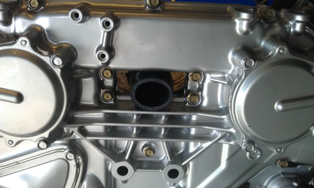

From: socal
What coating is done on the timing cover?
Old Dec 14, 2011 | 04:54 PM
  #292
JasonZ-YA's Avatar
JasonZ-YA
iTrader: (60)
Posts: 11,204
Likes: 32
paint......
looks like good ole paint.......excess seal is painted too..

Old Dec 15, 2011 | 04:13 AM
  #293
rh_334's Avatar
rh_334
Joined: Jul 2008
Posts: 497
From: Alabama
Originally Posted by JasonZ-YA
paint......
-J
Negative, Its PC. And yes the idiot PC'ed the sealant, but it was a free job so i'm not complaining... The color is called something chrome, it was sent to the guy to be polished, he decided he couldn't pull it off so he said he would PC it a "chrome" color for free, in the sunlight it does look polished.
Old Dec 15, 2011 | 04:22 AM
  #294
JasonZ-YA's Avatar
JasonZ-YA
iTrader: (60)
Posts: 11,204
Likes: 32
^ interesting, i didnt think it was cause i would have thought the heat involved with pc would have ruined some of the seal....regardless, it looks great...
-J
Old Dec 15, 2011 | 04:27 AM
  #295
rh_334's Avatar
rh_334
Joined: Jul 2008
Posts: 497
From: Alabama
-J
Thanks, I guess you could say it did "ruin it". It made the sealant hard as a rock and leaked. So i ended up scraping all that off and resealing.
