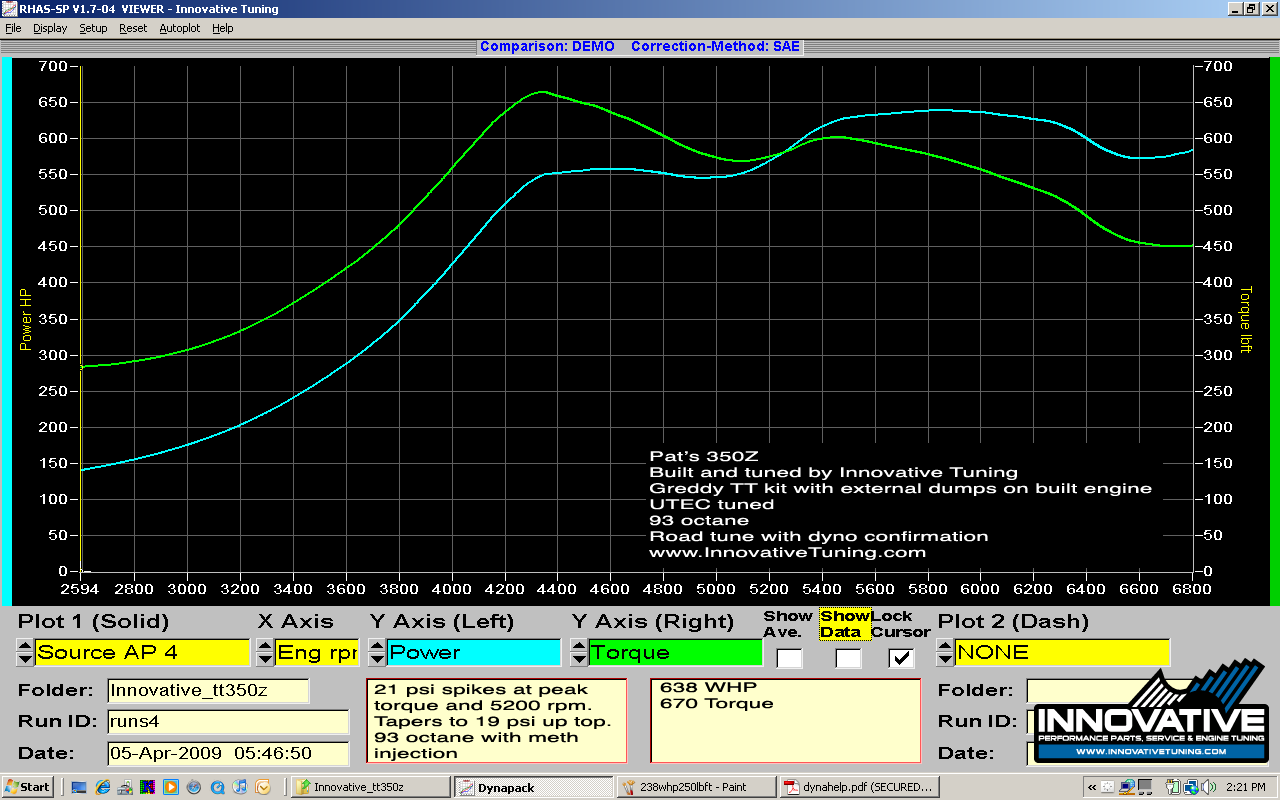

Just sharing my info My car is an 03 with a complete built long block, sleeves, tomei 268 cams, some head works, open dumps, APS 2.5 TD exhaust, triple carbon plates clutch, crawford plenum(old one), Meth/Water kit, 18G Greddy TT, and Utec. This is on a dynapack. Just purchased the Haltec EMS and will drive down to Hal to get it tune next Spring and trying to squeeze some more power out of the kit.
