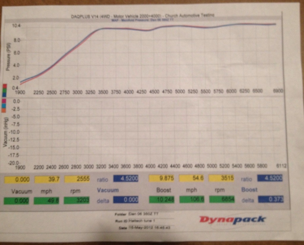

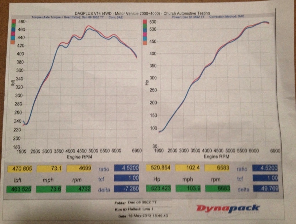

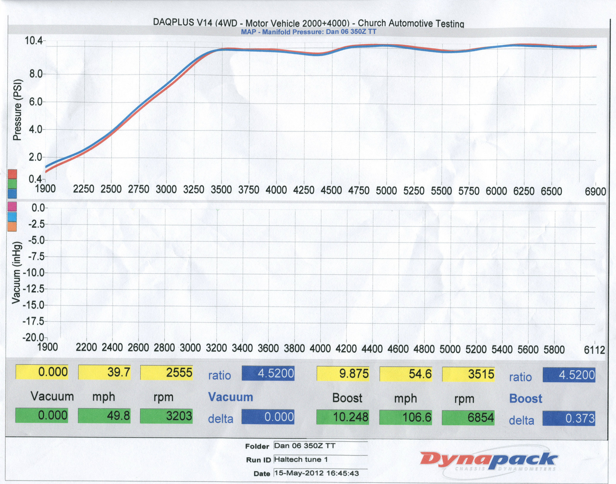

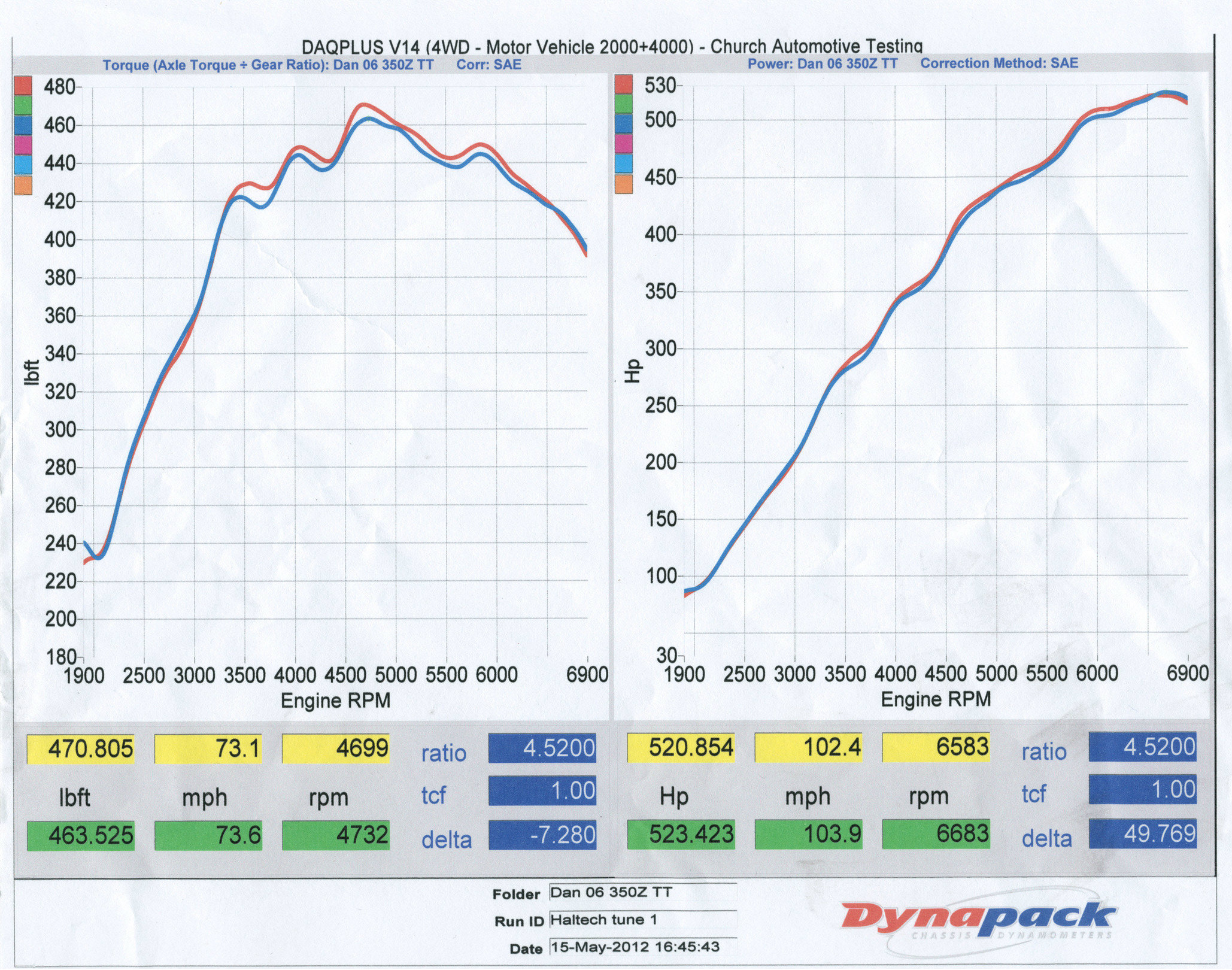

Car made 523whp / 470 tq at a little over 10psi of boost on the haltech. The GT-R injectors are running at 95% so that was the limiting factor. Will upgrade injectors once I've put a few miles on the new block. Will have dyno sheet up later but the car feels very smooth and it is scary to drive compared to the prius

sorry its so blurry ill scan them tomorrow:

Im sorry to see that car is still weak sauce. Building a car with those numbers (especially on that dyno) is like having a kid with Downs, sure you love the b@stard, but in the back of your head, you wished things were different.
Well done.

I promise to make you proud when I am running proper injectors Alberto and ill post non dynapak numbers.

also, what's up with that tq curve? is the clutch slipping or something?
