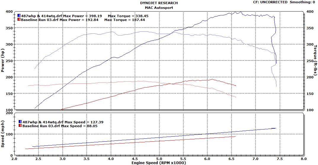

Twin JWT 530 BB turbos spoolup at at about 3300 rpm. I think these are GT25R tubos. Here is a link to a thread with the dyno chart. This tune was a little conservative, this turbo kit will easily exceed 400 whp, and may even get you close to 500 whp. In fact, the user presently lists 480 hp.
https://my350z.com/forum/engine-and-...lly-dynod.html
The JWT 700 BB turbos (GT28Rs?) spoolup around 3500 rpm.
https://my350z.com/forum/attachments...cted-speed.jpg
The 700BB turbos will allow the engine to breath better, and thus provide better top end.
