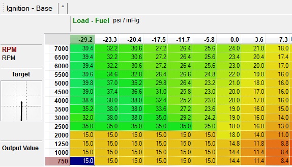

I just now saw that image of your timing map. That is WAY low for timing in vac. When i'm just in vac cruising 1500-2500 rpms my timing is in the 30's. You can advance the crap out of timing in vac without getting knock.
When i turned copy through off on accident and didn't notice it my timing map looked like that and the car drove like complete crap and got horrible gas mileage. It would die at every stop light or if i just pushed the clutch in on the highway.
Here are a couple images but i can send you the whole map. I followed a system developed by Raj (rcdash) on how to set it up. This gives me some knock counts but I have them all between 100-150 counts and over 150 counts is where the knock map kicks in to do something. If you set them to zero it's hard to tell how well your threshold is set. I can email you the instructions raj sent me on how to get that setup. My old trial and error system too way too long. I don't use the knock map fully yet though. I just log it to check things later.
also, here is my timing with copy through turned off. It doesn't run near as good with static numbers though.
