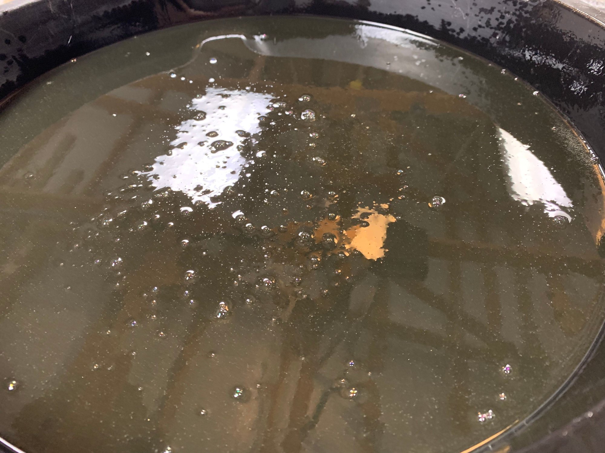

Last thing before I started drinking was to drop the flush oil ... dropped it and nothing out of the ordinary ... deep breaths, tomorrow is a new day...
the next day...

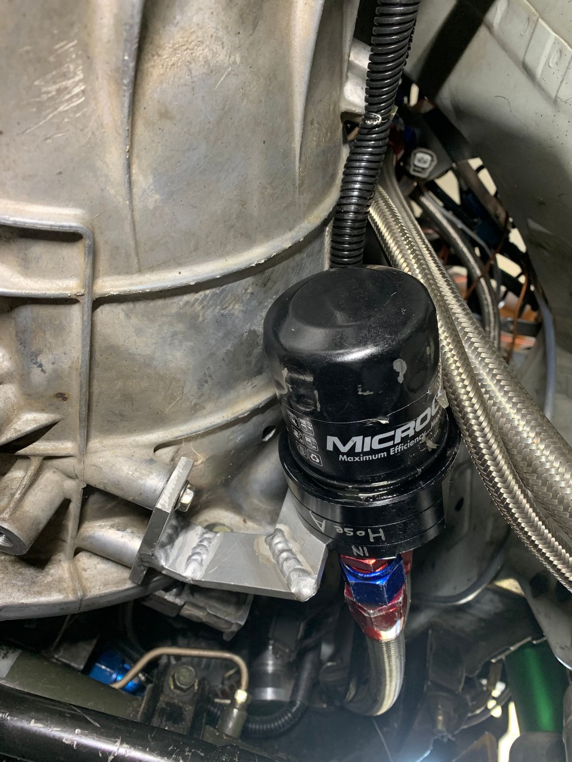

Also drained out the OEM oil filter (didn't cut into it - so really only got clean-side oil out) and nothing that would be alarming came out (metal shavings wise) then drained out my secondary (pre-turbo) oil filter and gold flakes were present - I'm not overly alarmed as these were likely present from my previous bearing failure - I did clean out the filter but I think this contamination was from before.

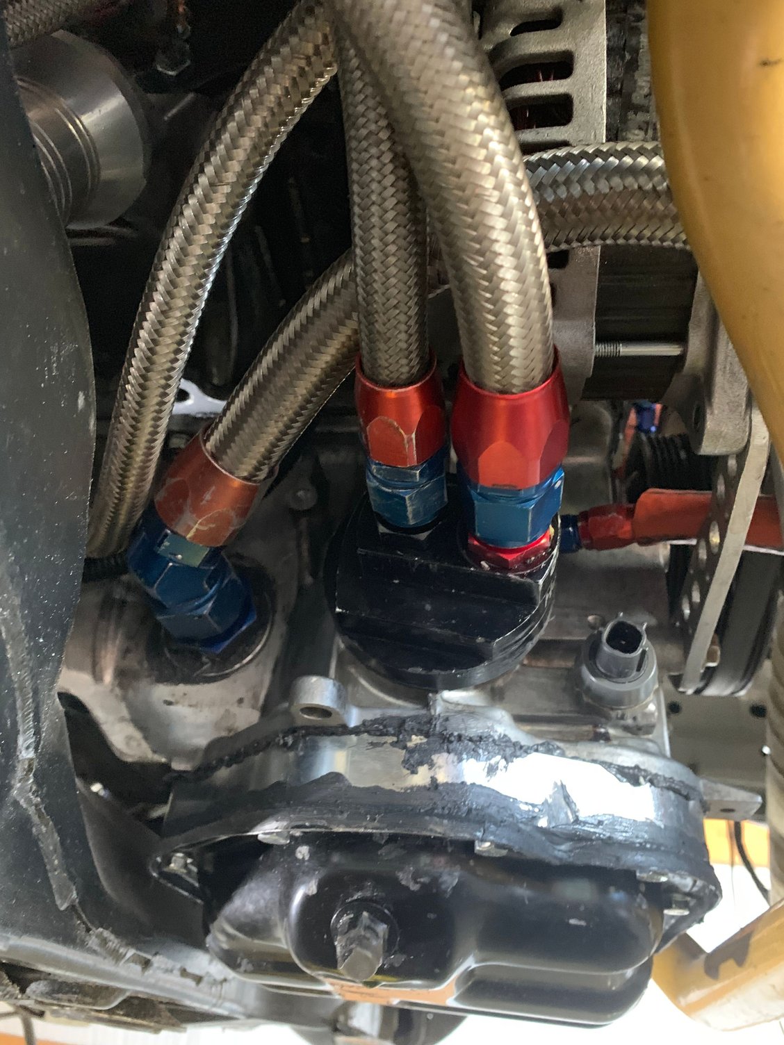

One outstanding task was to move the oil filter anywhere out of the way. I already have a filter relocation kit but bending/snaking it around the motor mounts was pretty much impossible with it connected. With the oil drained I was able to disassemble the filter side and route the hoses to the passenger side of the transmission.
Made a little bracket to mount the filter body to the chassis - used two 6mm bolt holes off the transmission. Surer than **** the steel braided hose touched the positive terminal of the starter and sparked up! Didn't thing much of it (as it's happened before) and proceeded.
Filled oil, checked everything and fired the car up … started well and ran with no assistance from the pedal. Oil pressure climbed and climbed and all the sudden dropped and dropped and I shut the car down around 20psi of pressure...the steel braided hose was compromised and oil was pissing out of the hole. I probably lost 3 quarts of oil all over the floor!
Removed, rebuilt, reinstalled the hose … Ended up buying new oil, filled 3quarts, but didn't start the car - I don’t want to overfill.

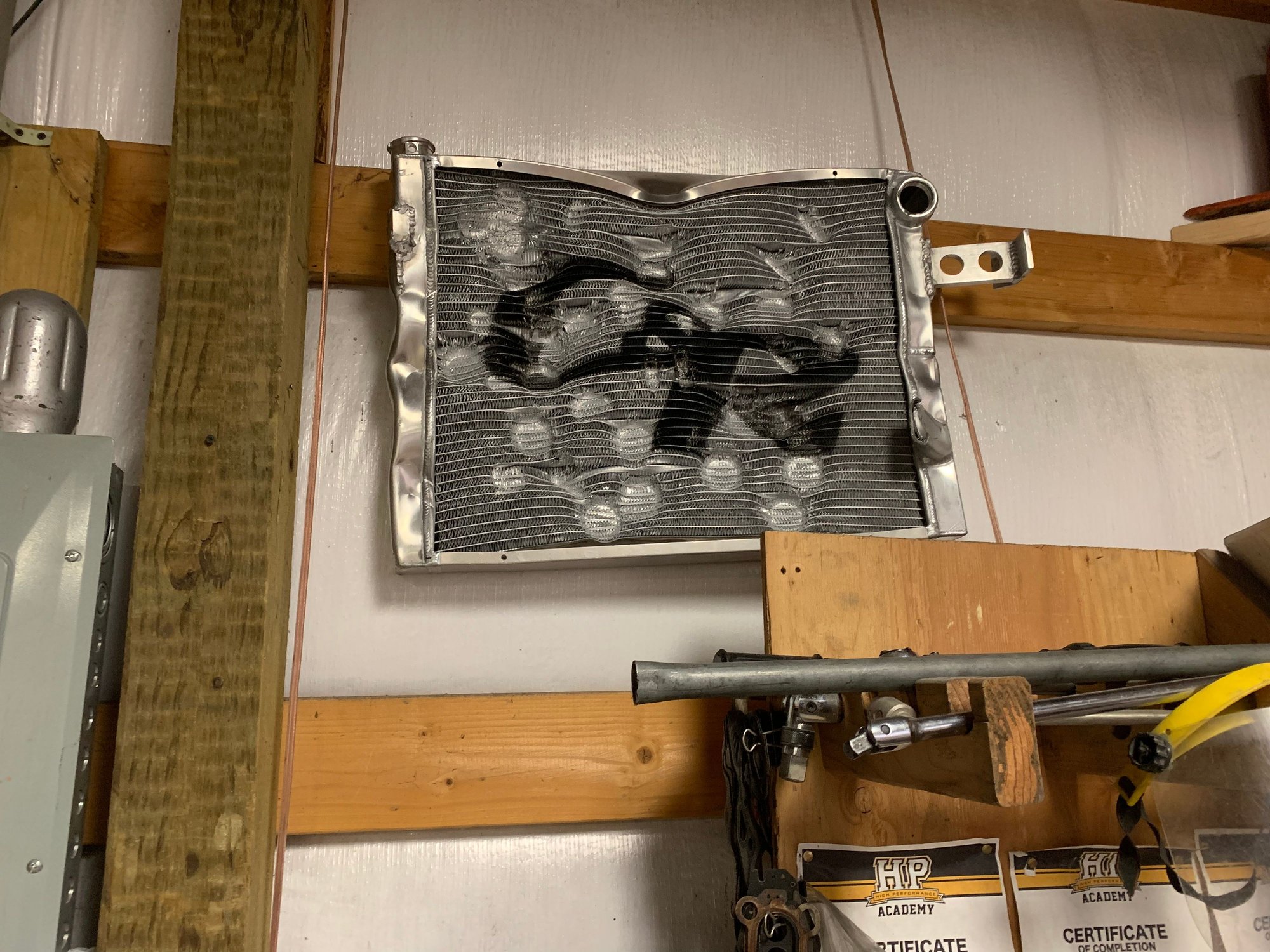

failed … had issues loading the car onto the trailer. Trailer shifted vertically as I was on the ramps, I stopped and as I was backing and the IC caught the edge of the trailer dovetail lip and clipped it off. It was sorta funny - I definitely was laughing at myself!
If it's a silver lining - only a small amount of scratches on the bottom plate of the IC and no other damage to the IC, the radiator is fine, the exhaust is fine, and I chopped-off a coupler to get the IC off. I put the car back in the garage and our group went to the event car-less. We still had a good time. This event, although put on by the same individual, isn't as nice as the airstrip attack - airstrip attack is pretty sweet.
Moving forward - I'll have to drain & remove the radiator, remove the mounting bar and re-weld the two IC mounting legs and then reassemble.

Did get the IC mount/bracket off the car and taking the radiator off was easier than expected. The bracket did sustain a small amount of damage in that the welded-face of the bracket bow'd out. I put it in the vice along with a flat piece of stainless plate and pushed it back in and then tapped it with a hammer. Gound-off the fractured welds and re-laid-out the brackets.

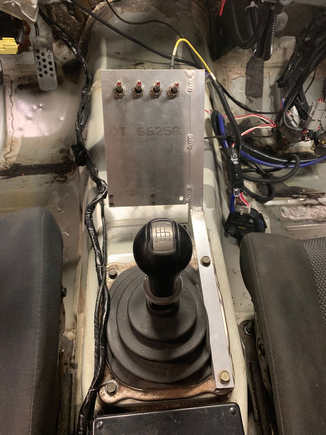

Also made steps on a small switch plate ... nothing too complicated but something to mount ahead of the stick-shift.

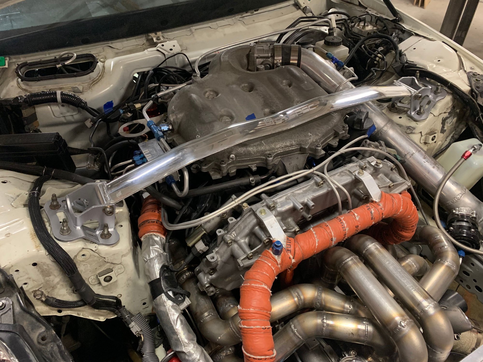

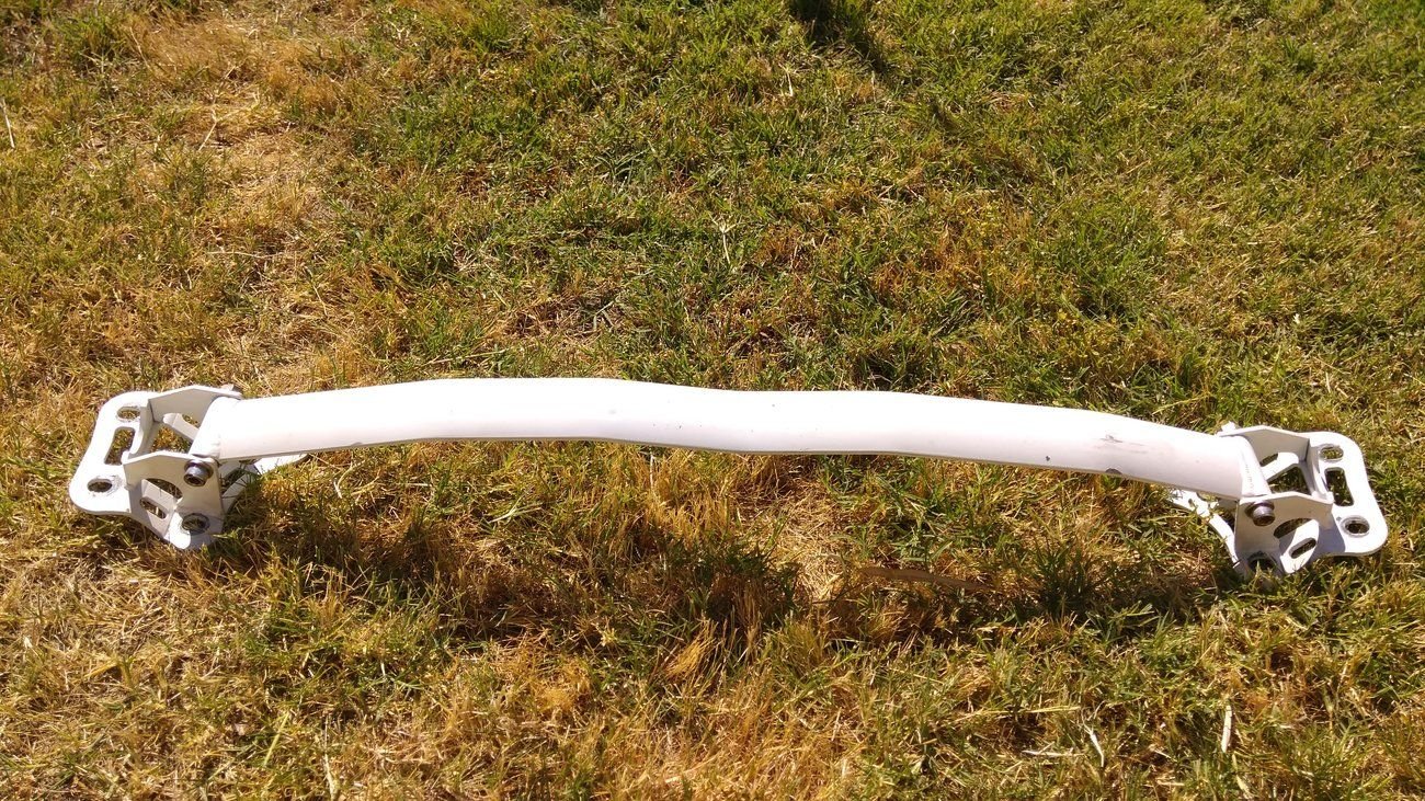

I picked up this front-tower brace from DPhoenix ... I love GT Spec stuff and this was one piece I didnt have and DPhx gave me a great deal on it (hat-tip). I dont necessarily like the white-out but I can deal and it wouldnt be the first time I stripped paint!
(everyone prepare to laugh) its about 2lbs lighter than stock. which its becoming incredible hard to take weight on the front end of the car and now even worse with a front-mounted turbo!

On the Z ... got the Gspec front tower brace prep'd and installed. I forgot that I had 1/2 a can of silver spray paint from the wheels a few summers back ... So I painted the brackets in silver. Didnt clear coat them or anything and if I have it all over again I'll do them in white. DPhoenix had the right idea!

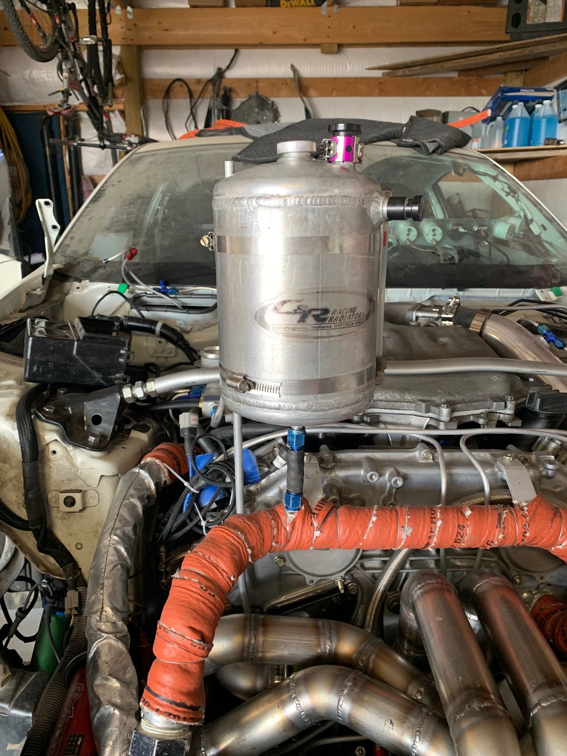

Ive been in need of a coolant overflow tank and I've liked the idea of a plastic / lab-grade / nalgene bottle over a aluminum or stainless tank ... I ordered a few of these 1 liter square bottles ... punched a hole, rtv'd, and installed a -4 fitting. We'll see how it turns out.

had some garage time tonight ... did a final bleed on the coolant system, capped it, and started the car. On cold start it did this (and freaked me the F out):

pecked away at the switch plate ... to this effect:

thanks Mike!!! I was rocking my '04 lariat forever and a half - got up to 225k miles on it and told myself if you can take care of a 2004 with the 5.4liter triton and not have the cam phasers or oil pump explode on you, when the time is right look into something nice. I've always loved the king ranch package and the 3.5 liter ecoboost is a excellent balance of daily drivability, economy, and enough towing capacity for what I need. It's actually pretty fast for a 4600lb pickup.
Ill look to add a better IC, I'll add water methanol injection, and at some point a bigger (setrab) oil cooler.
My bigger focus is the other 3.5 liter - I uploaded another copied tinker-around tune tonight and surer than **** the car fired up within a second or two.
The car wouldnt stay running without a little throttle until it was running for about 30seconds. I didnt run it but for a few minutes before the garage was full of smoke.
I'll look to get a video of the erratic RPMs
