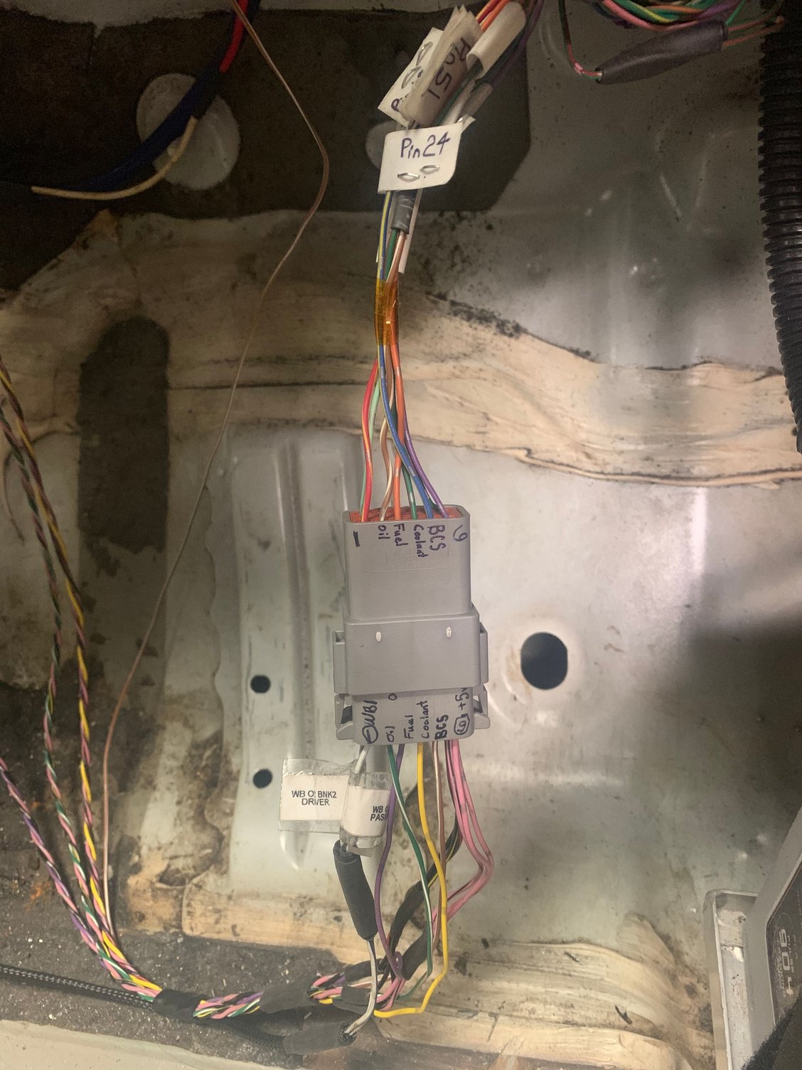

Spent the last few days getting the Link sensors pigged/wired in, organized, and pinned to the ECU. I ran the car for about 15minutes with a few throttle blips and logged the parameters to ensure everything is talking back and forth between the ECU and the car.
Pretty happy as I had no check engine lights / faults and the sensors are talking to the ECU. A little more work to assign a calibrations table (based on the sensors pressure range) but overall pretty encouraging.

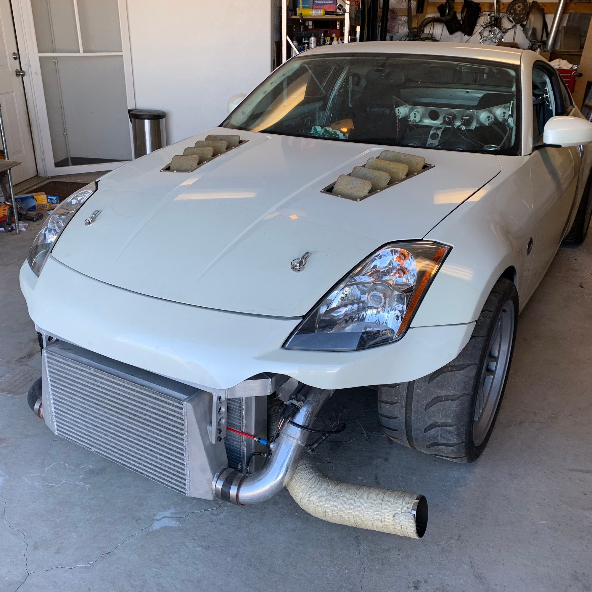

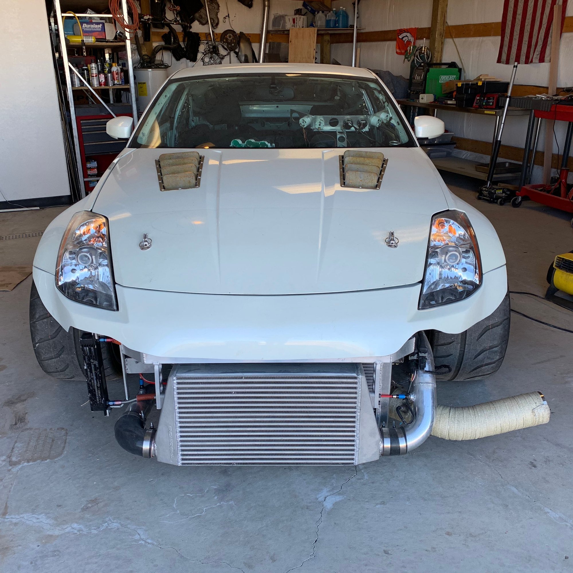

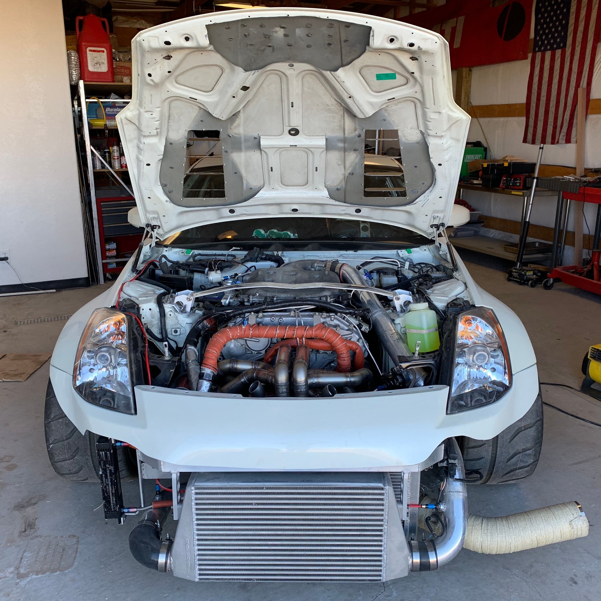

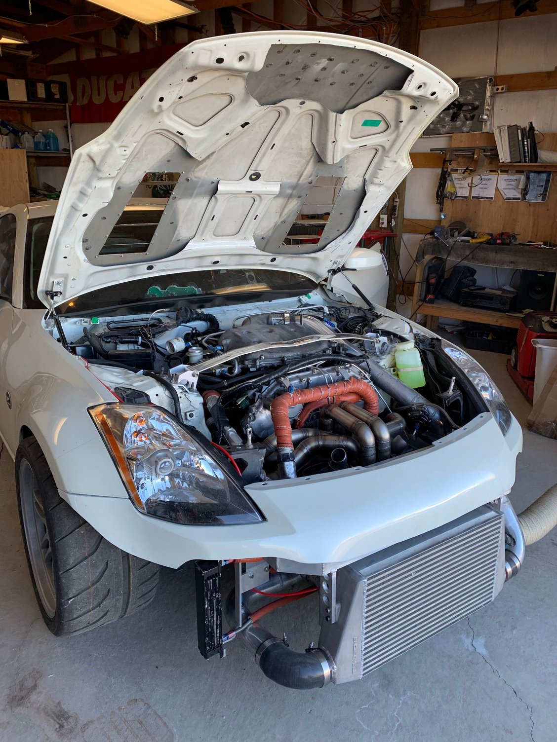

had a good day and made some more progress with the car ...
got the car up and going and a solid 15minutes of idle / throttle blips and she did well.
With the turbo & header assembly so close to the radiator my 16" spal was too close for comfort to the turbo exhaust housing so I dropped down to a 10" and I wasnt sure if it'd provide enough capacity (around 900cfm...I believe the 16" was 2100 cfm).
As a test, I got the car up to 170 degrees and configured the Link to activate the fan at 170* and let the car run...over a few minutes the car did get any hotter but it didnt get any cooler either. I did the same test for 200 degrees and same result. I do have two 6" spal fans I could hook up to the OEM 'fan #2' power source. We'll see...
my coolant expansion tank (a simple lab-grade nalgene bottle) did fill up maybe 6 to 8 ounces ... I'm assuming this is actual expansion ... I marked the bottle with that rubber band and we'll see if it goes back into the radiator upon cooldown.
Got the car plenty warm and out for about a 15minute test drive. Nothing crazy, stayed in vacuum the entire time with the exception of one pull where I did get into about 2psi of boost - never thought I get excited about 2psi of boost...lol!
I did run into an issue with the Link's failsafes ... it's definately going to take some ironing-out as the car is going into 'safe-mode' during normal operations ...
For instance - oil pressure (I really gotta dial the threshold down) On my way back, I turned around and pressure dropped below 15psi (on the link pressure sensor) and limitted my RPMs to 2500...
Also coolant pressure - my coolant pressure was between 1psi and 10psi the entire trip ... so I was 'checked' to 2500 and 4000rpm most the drive.
The GP (general purpose) tables have timed lock-outs but the others dont - so I might have to rearrange the assignments.
here are some pics from the afternoon:

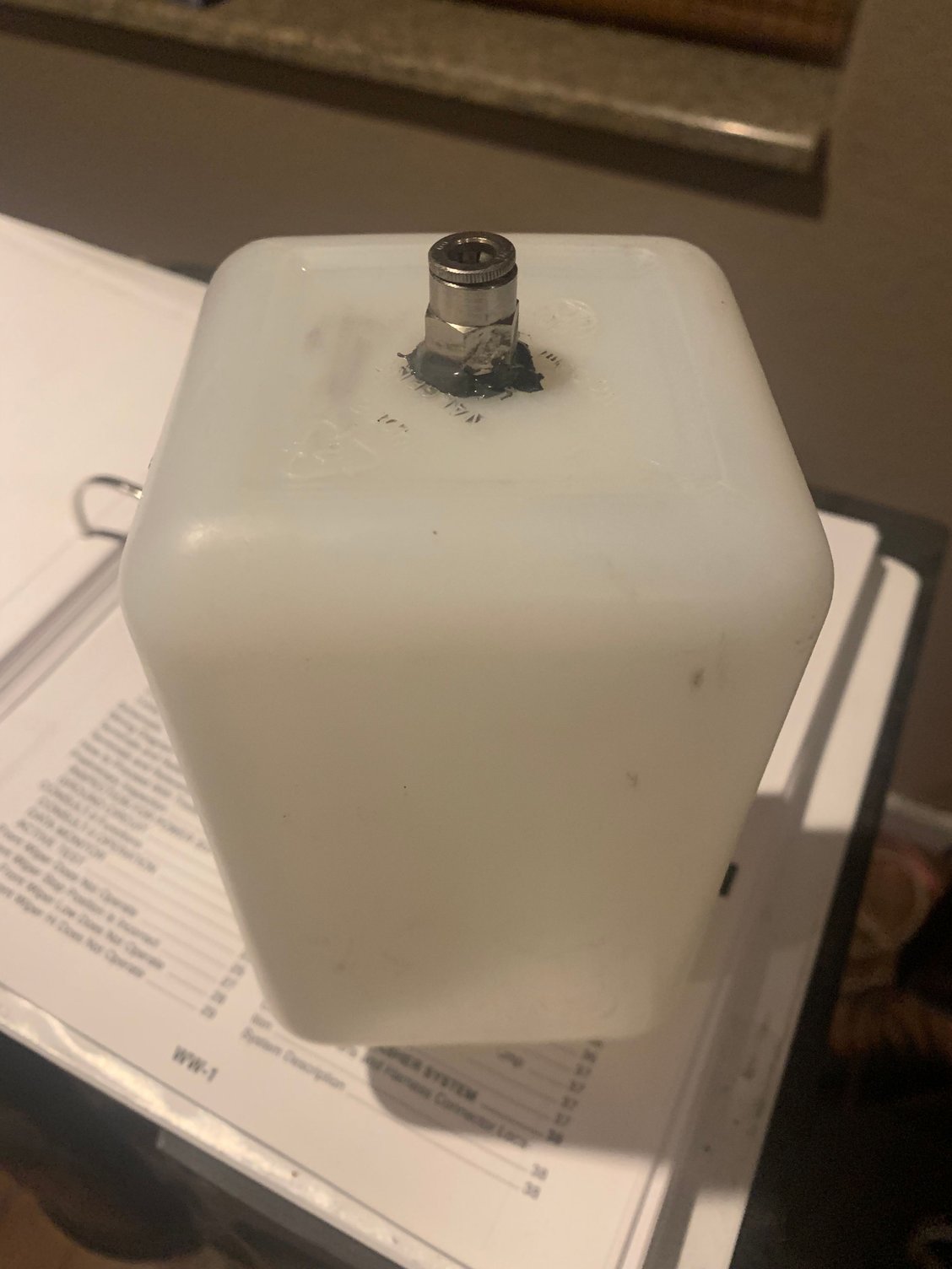

finished welding and installed a 1liter lab-grade nalgene bottle for water/meth ... I'll replace the rubber-band with a velcro strap...
