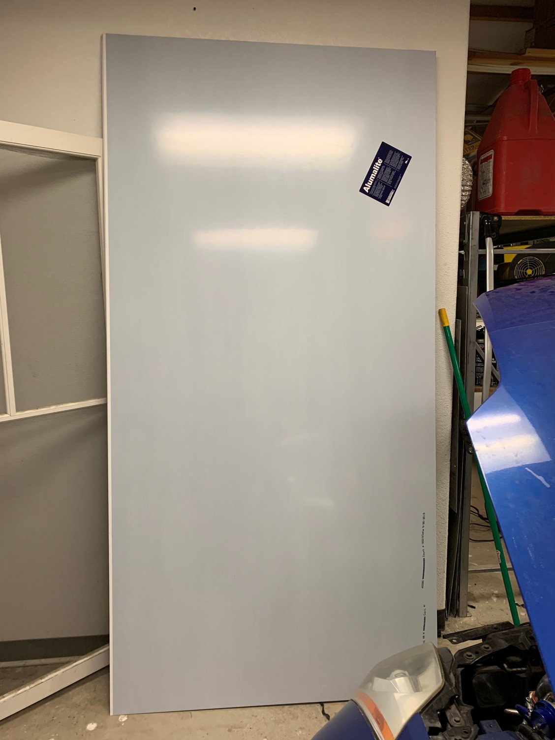

That aluminium composite panel is good stuff, I use it in place of flat aluminium sheet where it doesn't have to be bent. It's way lighter which for our chubby 350Z's is a good thing.
do you see any problems running a 1/8" (6mm) piece of aluminum (rather than alumalite) over the rear axle? Any insight on the front area / areas? or insight in general?
I have access to a 6mm or 10mm thickness ... do most people run 6mm thickness?
any insight would be appreciated

I use 6 mm and have not had a need for anything thicker but guess 10 would not be much heavier.and may require less support. As for the back axle after reading about the development of the 350Z and particularly their aero work on the under floor decided to leave mine alone. Some cars seem to have diff overheating problems which could be related to airflow issues, my conclusion was that a bigger finned diff cover would be sufficient. With yours being a turbo and so putting more power through the diff I'd be keeping cooling air flow to the diff very much in mind. Like your build
Cool - thanks for the insight/opinions!

I found a sign shop locally (about 5minutes from my office) that can get 6mm alumalite for $140 a sheet ... so I ordered two sheets and likely it'll be in tomorrow. I ran some very basic layout sketches and I think I have a pretty good plan moving forward.

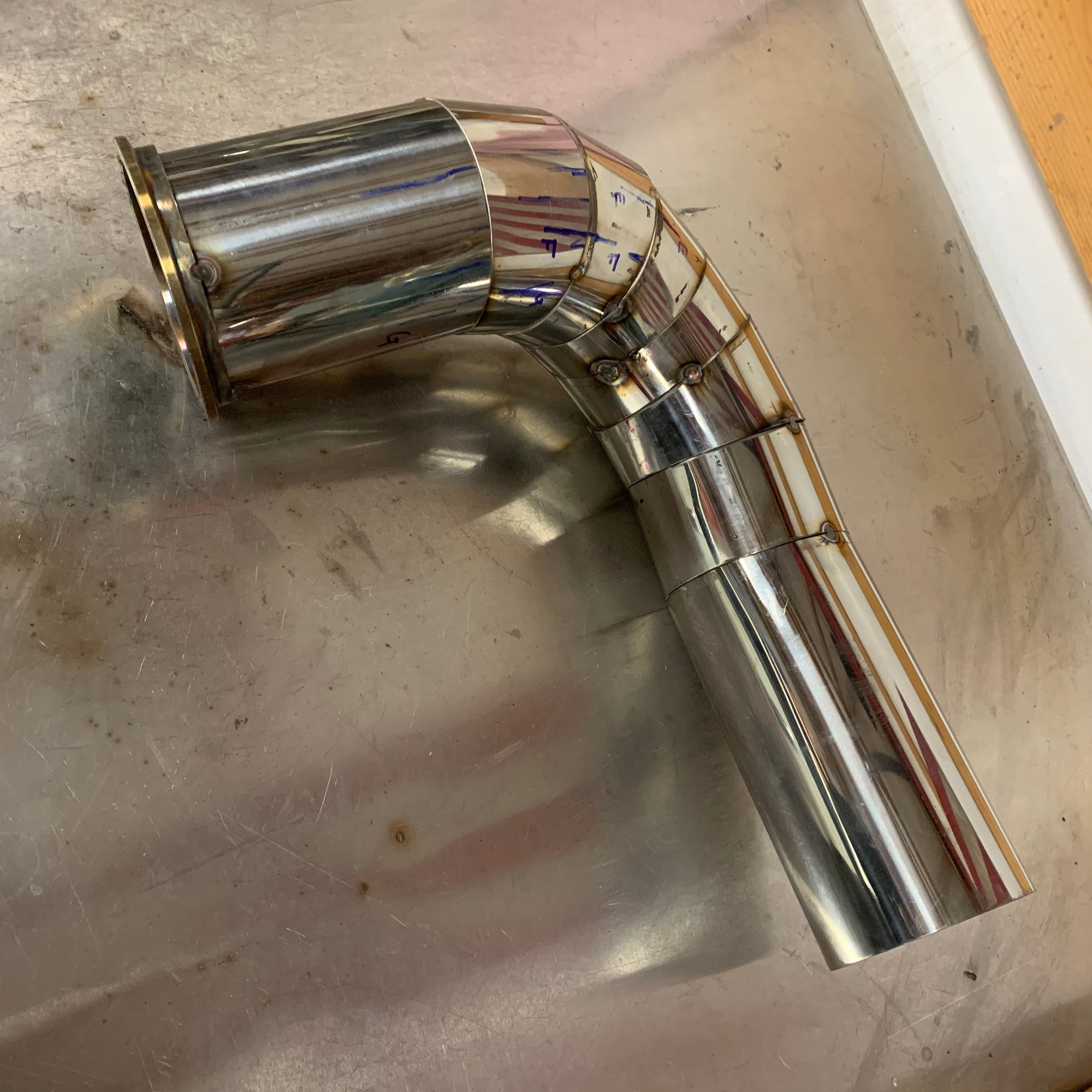

Gonna revamp my exhaust pipe and go hood exit (as previously mentioned). I cut 4" stainless steel pipe at/around 7degree angle to pipe-cut to bend forward and up …

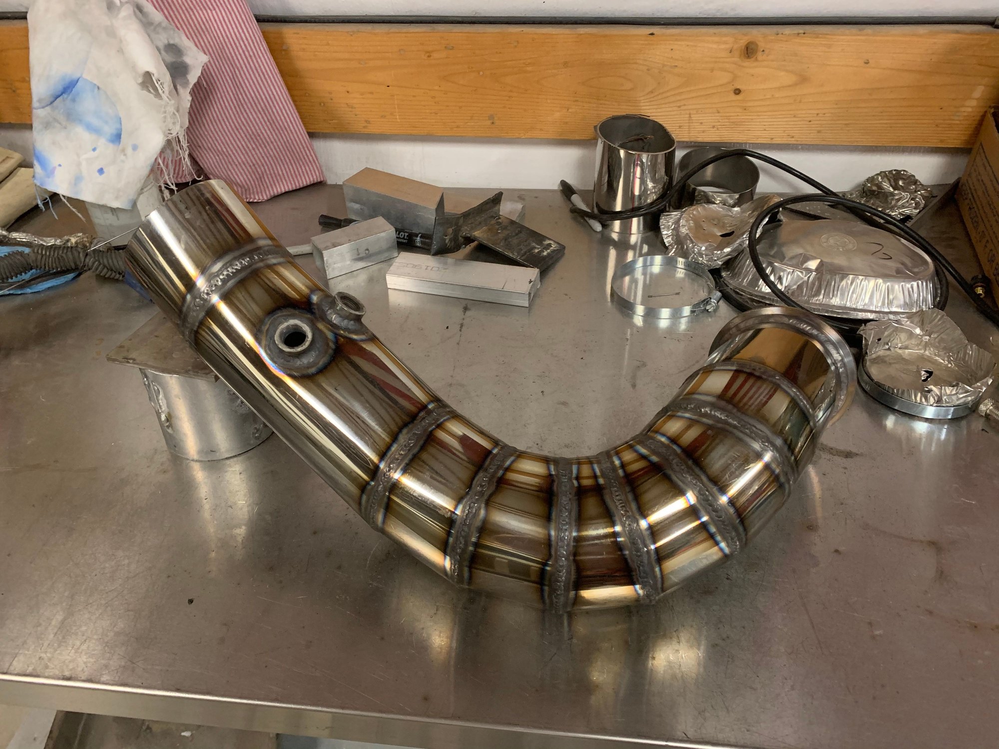

Worked on the exhaust a touch more and tacked it up...excited to see how it comes out ... will need to weld-in bungs at some point. It's been windy and cold but I want to get the car out ... especially after riding in my buddy's setup.

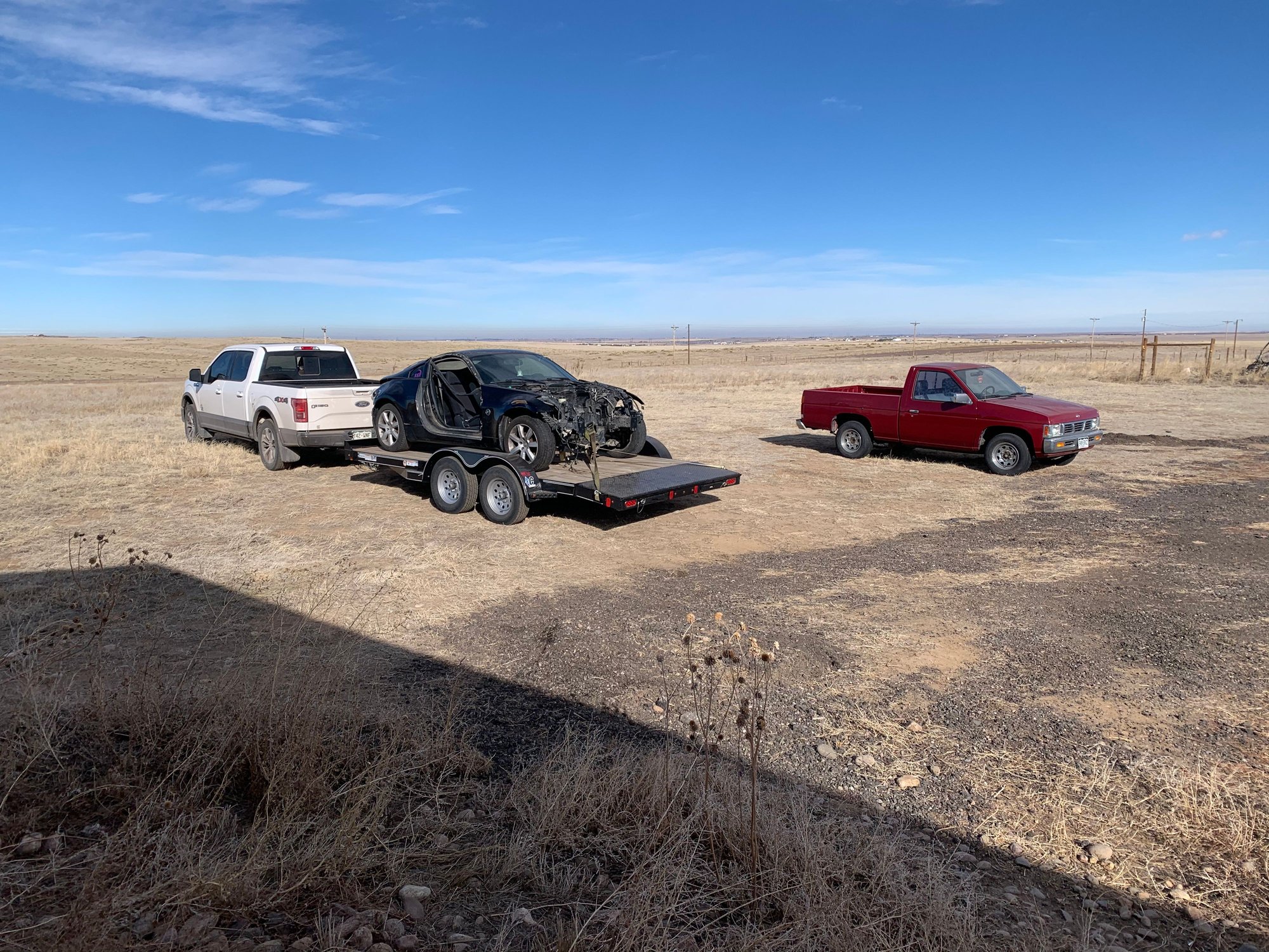

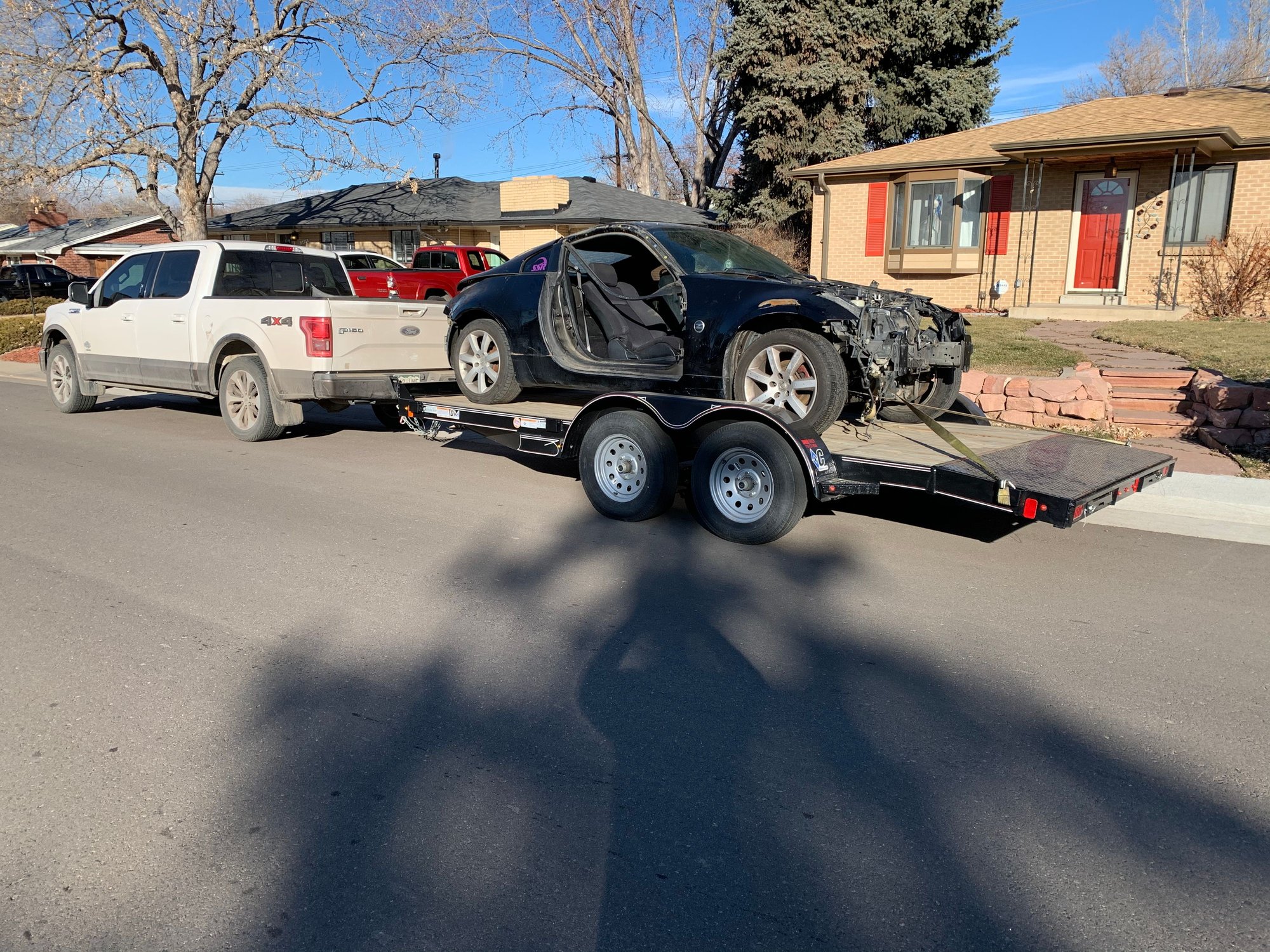

Picked up the roller ... $4 bills for it. Want to take a few things for myself, part out some stuff, and then aforementioned buddy wants the carcass to do (I guess the kids are calling it) a 'death' ... 'cart' ... 'build' ... ie, strip everything down to the frame, weld in a cage and cause ruckus (I feel old)...

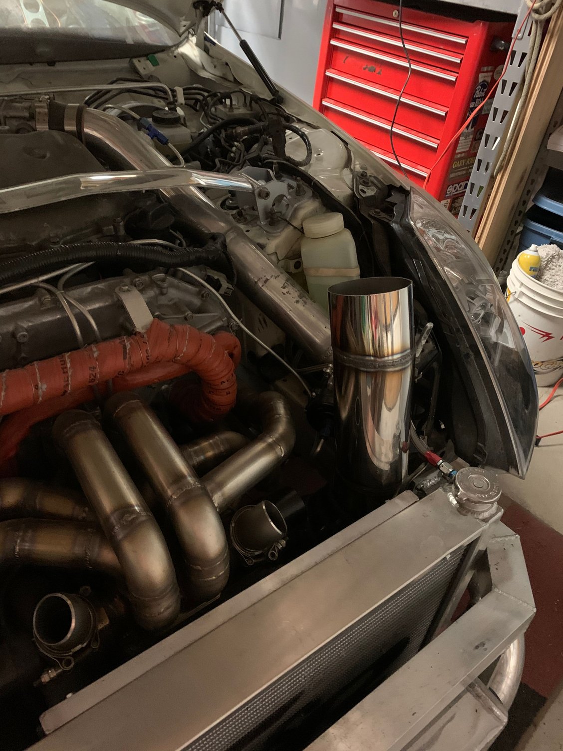

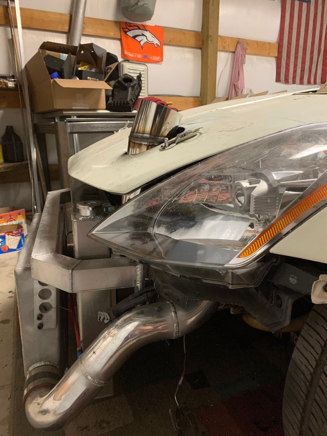

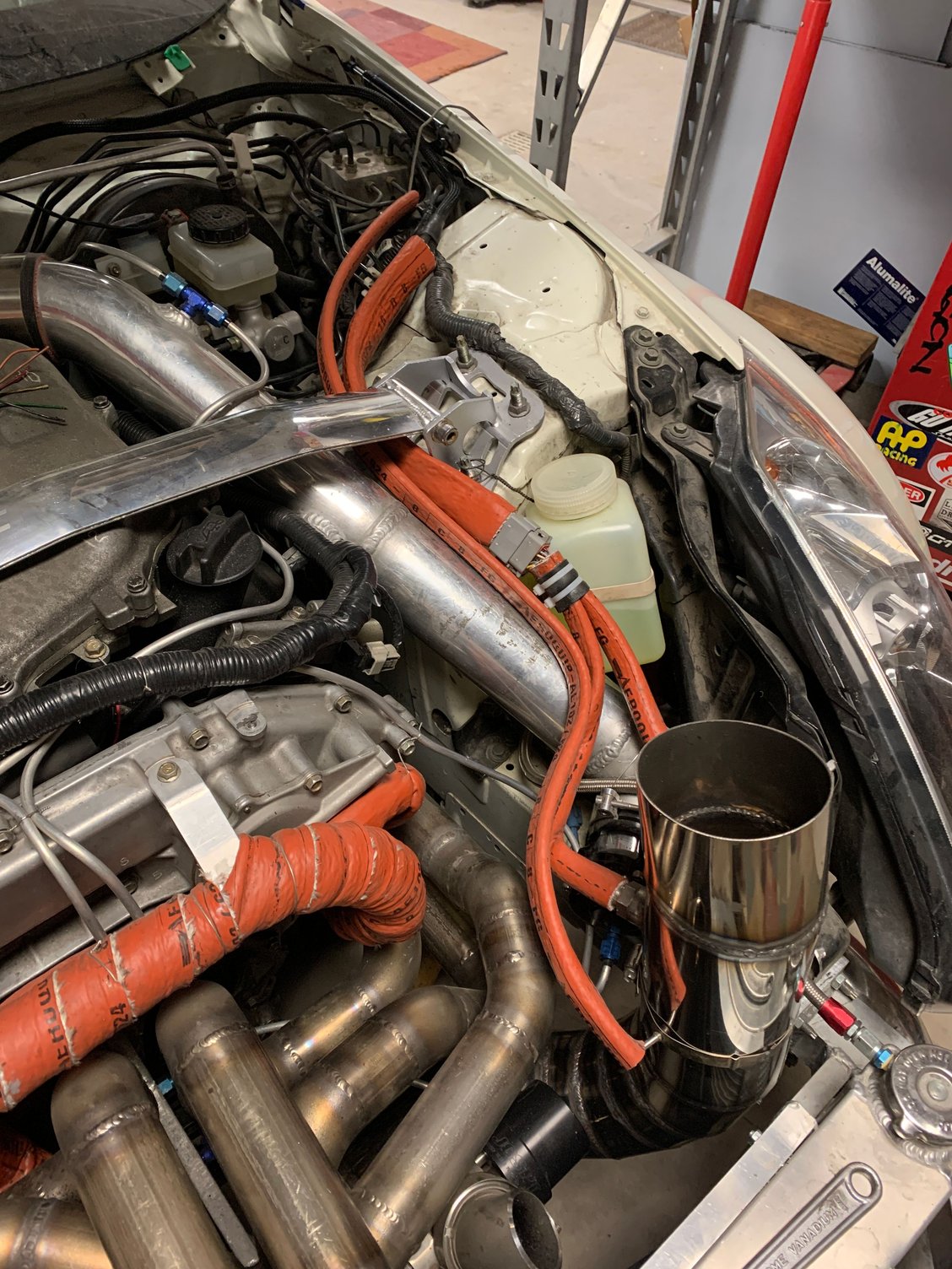

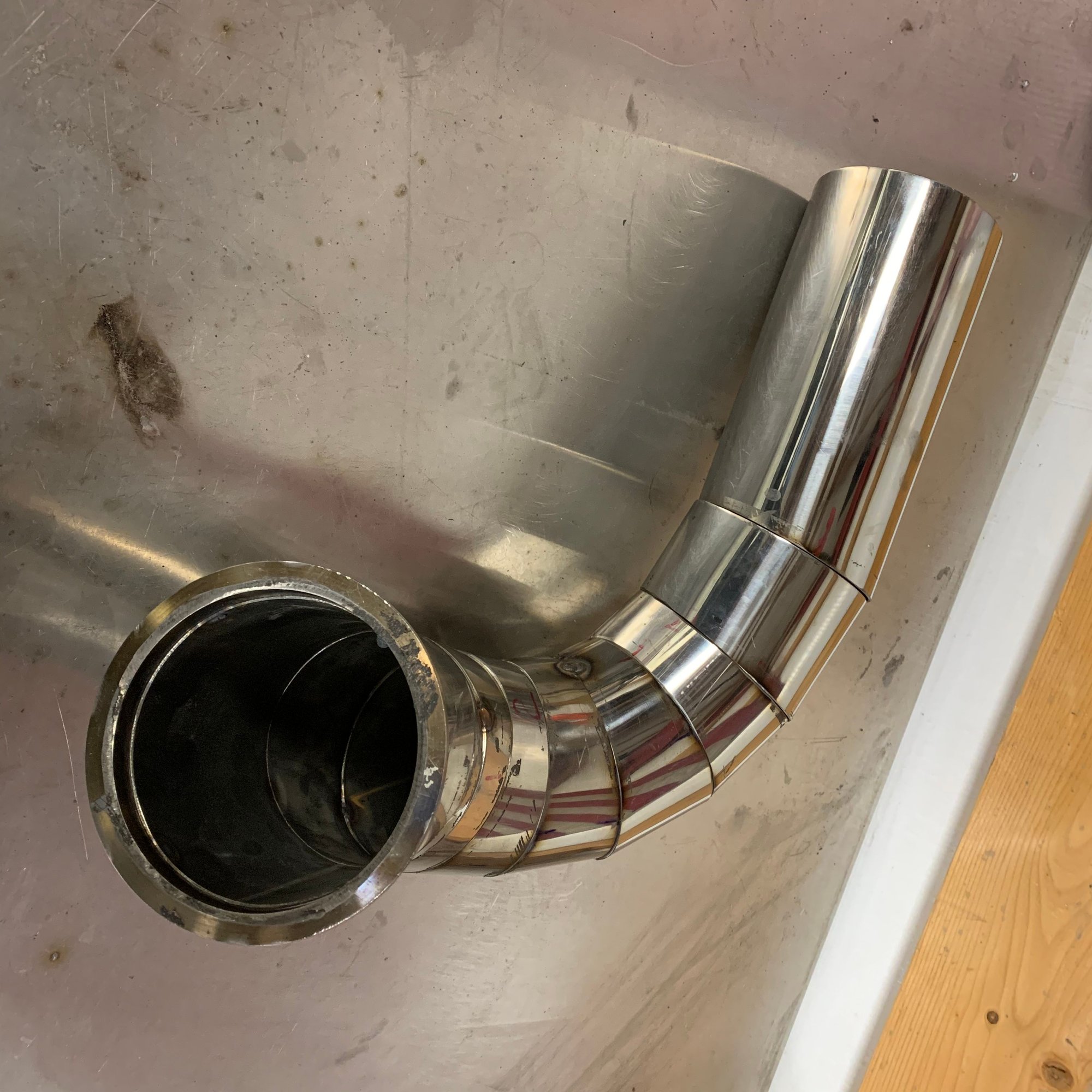

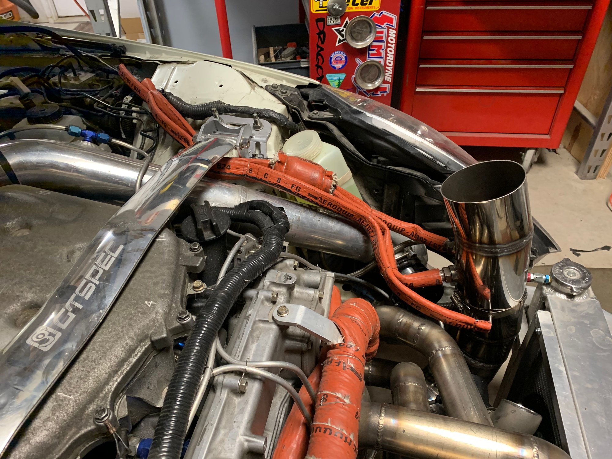

More time on the exhaust ...
got everything welded-up and it turns out the exhaust pipe is about 1" to 1.5" too short to clear the hood... I was gonna cut the last segment off and put another 4" piece on it but I didnt have anything that long. So I added a 3" piece and I'm gonna taper it back 8degrees or so.
I was also able to trim the hood so the exhaust pokes through without trouble. It sucks to see this hood in this bad of shape. It's rough, very rough...I look forward to replacing it at some point in time. I've taken pride in keeping the exterior as nice as I possibly can. Aside from catching a light-pole concrete base and ripping into the bumper (it was replaced) and a lady rear-ending me at 3mph the car has never seen damage. It punched my pride letting the hood fly up and damage the roof.
but ... 'every new beginning comes from some other beginnings end' ...

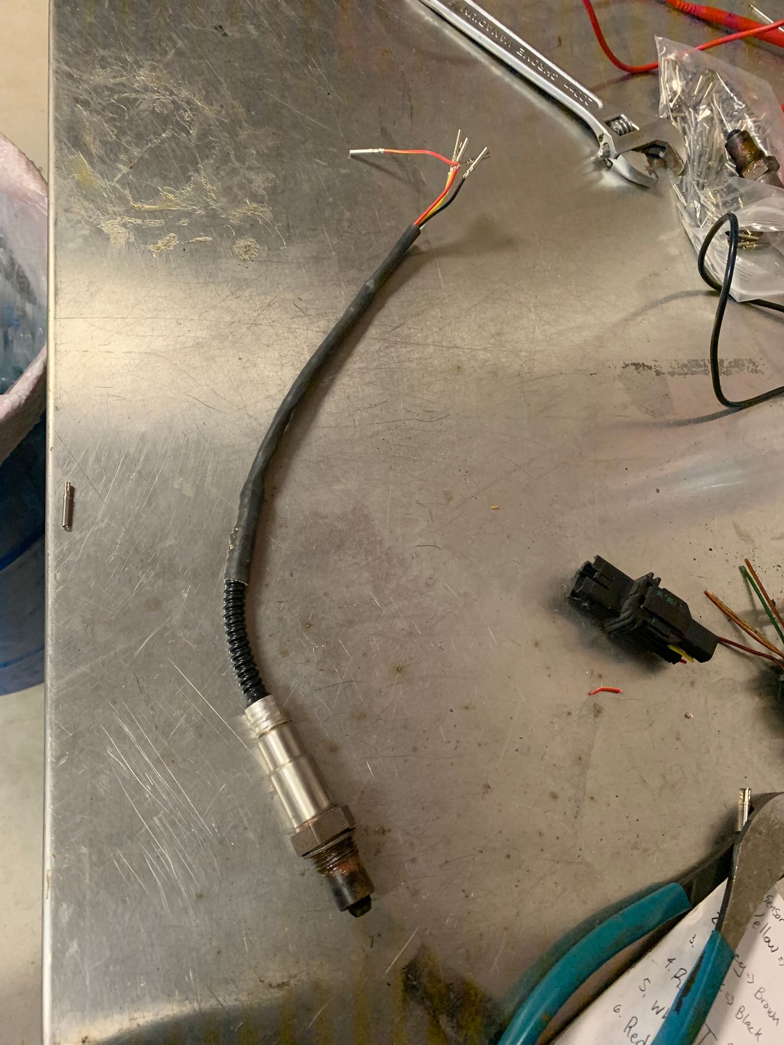

I also welded in two bungs for my o2 sensors.
I anticipate poking the waste gates off as well - wont be nearly as complicated.
too short of a pipe:
finished product
loosely installed
punched through

Why two widebands in one pipe?

The link is setup to take two sensor inputs and I left it this way for redundancy. I think this is for running different banks but I think I turned that feature off. I dont know if the link will average them out? use one as a primary and the second as a backup or a check? I should look into this.
The link does have a feature where if a sensor operates outside a given parameter it will default to a specified value that is used in the tuning. Meaning, if the sensor is reading 5:1 AFR (and this is obviously outside it's range) it'll 'lie' to the fuel maps and use a value of 14:1 (or whatever value you specify) and then it'll also give me the ability to run the car in a limp or restricted mode.

If the link thinks they are in different banks, and you have a sensor that starts to go out it could potentially cause havoc. The ecu is going to compensate for what ever the bad wide band is reading potentially causing one bank to either run rich or lean. Also the positioning of them side by side could cause erroneous readings due to how the air flow over one can cause turbulence for the air around the other I would think. But that's like fluid dynamics or some other smart person specialty.

I've got to look into it - I believe you can turn the system to a two banks or one bank setup with fuel. I hear what youre saying. I had my wide bands switched on my greddy / haltech build and when you graphed the O2 corrections it was nuts! Member 'Binder' sniffed it out and helped quite a bit. Im worried about fuel control but not crazy worried in that I have a built in factor of safety in my high load, high rev areas. But I hear what youre saying.
Finished up the hood exit, hooked up the o2s and my EGT sensor...it wasnt working before and I think it wasnt getting a 12volt power signal. So, resourced it power, and it's up and going.
I had to adjust the brightness/aperture on the camera as it was well into dusk. Also it should be noted that air temps were around 30degrees ... so I speculate the 'white-ish' exhaust is from the cold temps and not from blown headgaskets (or at least I pray it not headgaskets!!).

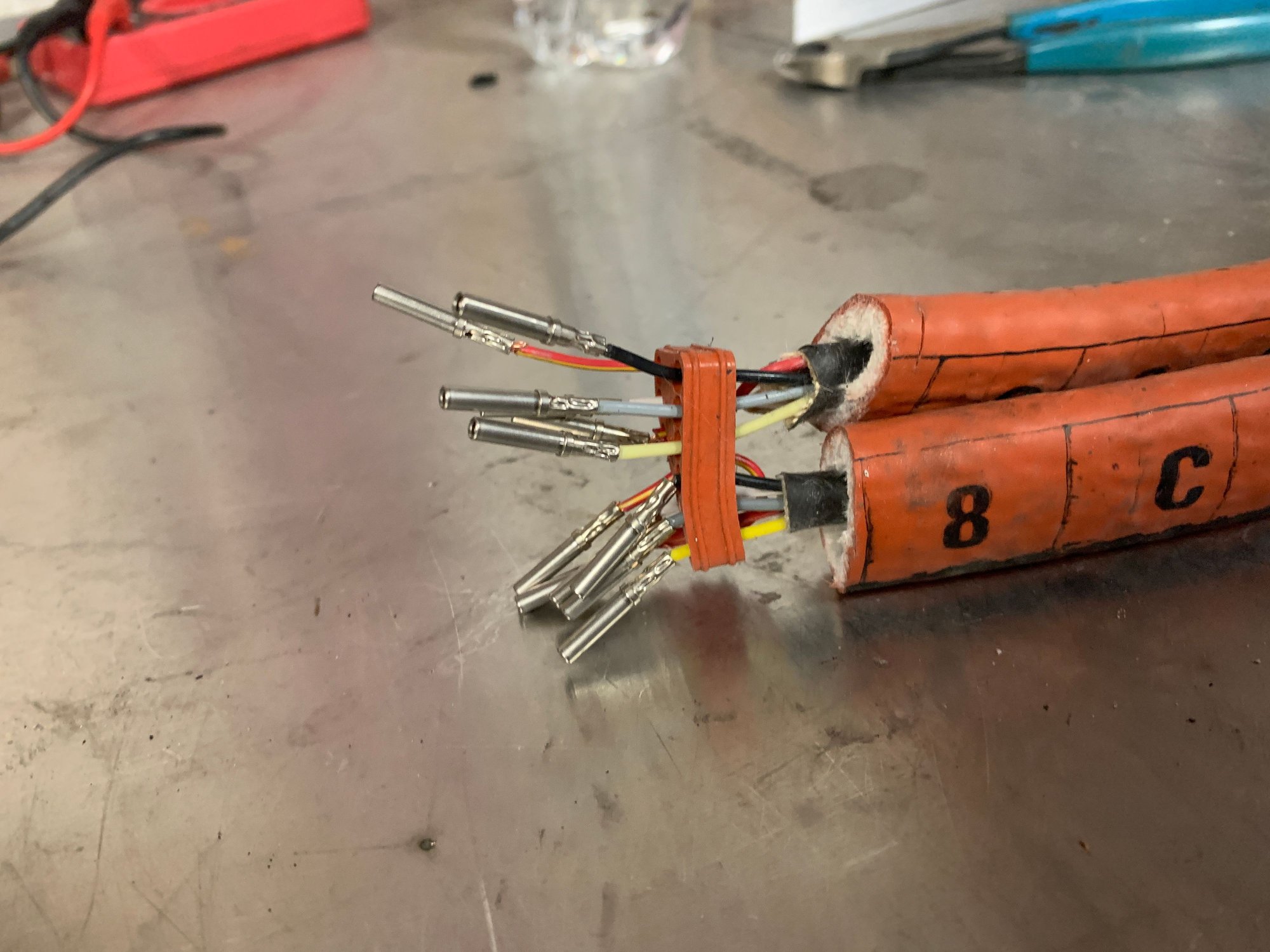

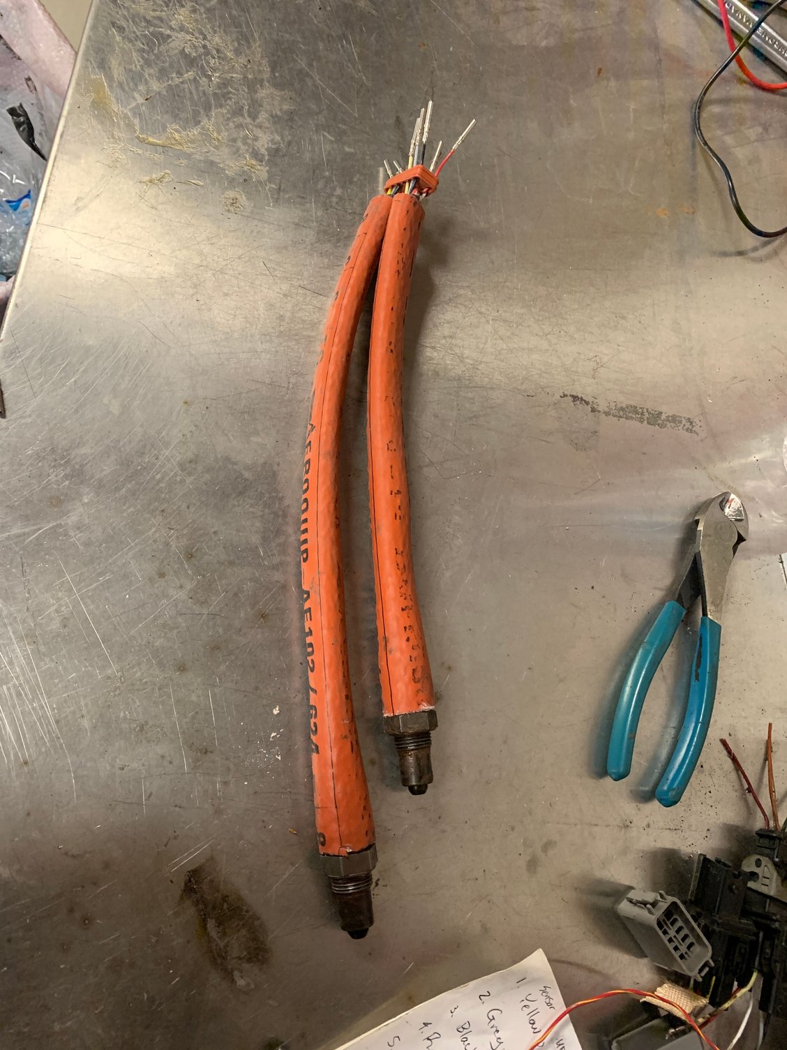

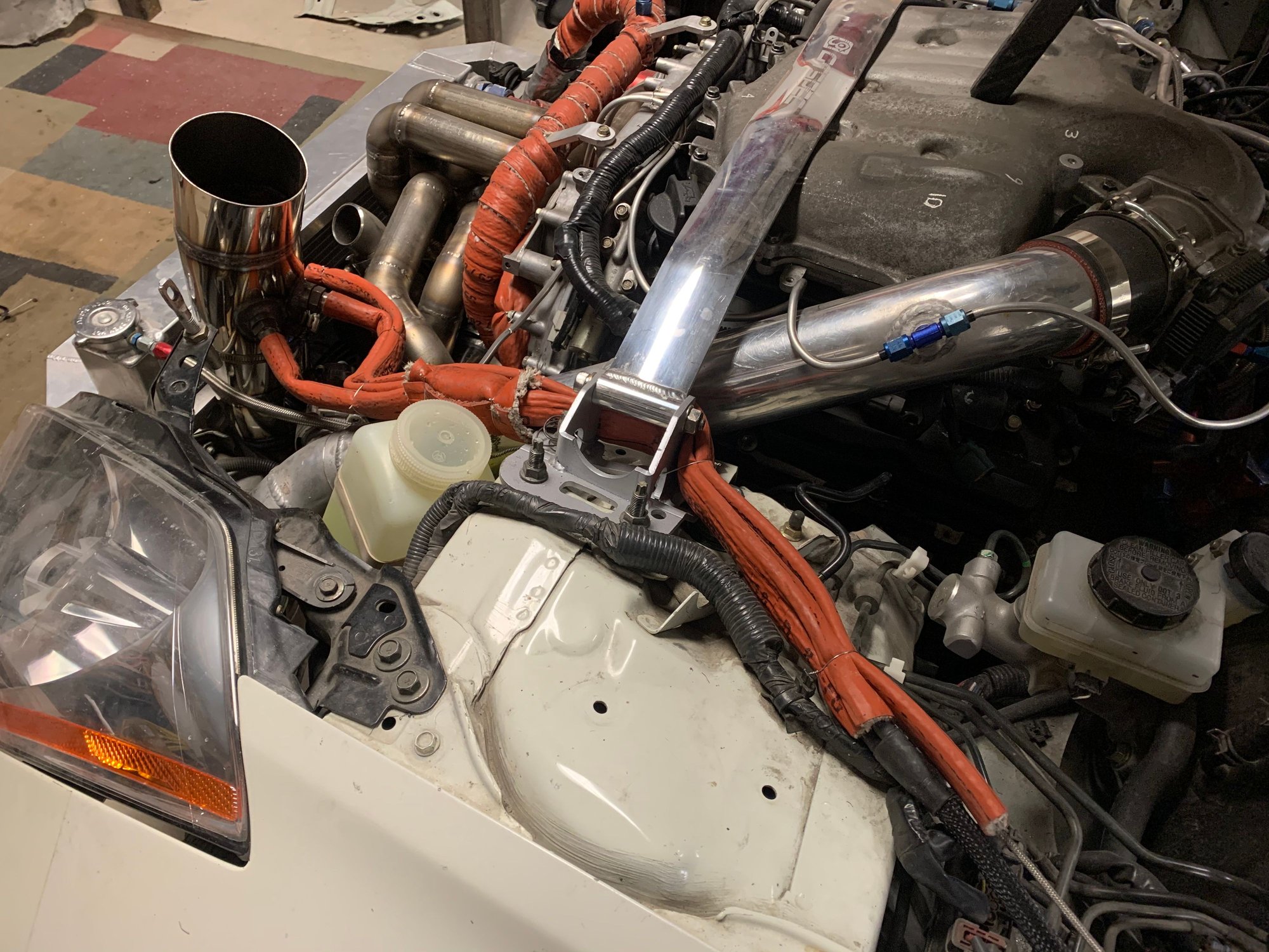

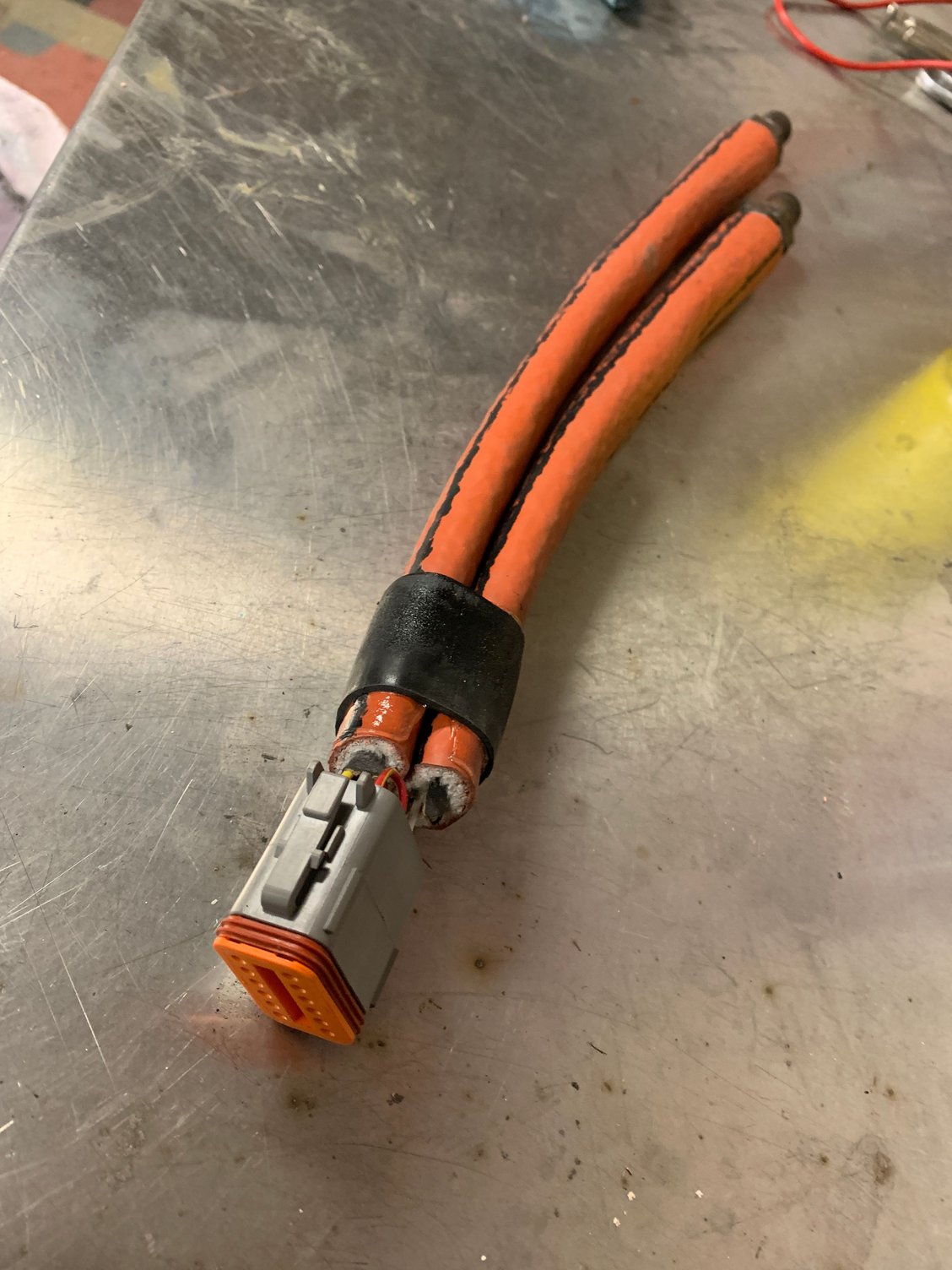

the headers get hot - no kidding ... at some point in time I will have them ceramic coated but for now they are bare - I didnt have the time nor the funds to do this before install. Next best solution and will carry-on when the headers are coated will be to wrap lines - fluid lines, sensor/signal wires, etc.
With the hood exit wrapped up and O2 sensors and EGT sensor right by the header wrapped the wires. O2 sensors are essentially impossible to wrap. Solution: depin and use a new connector. Did this for both the two O2 sensors and the EGT.
