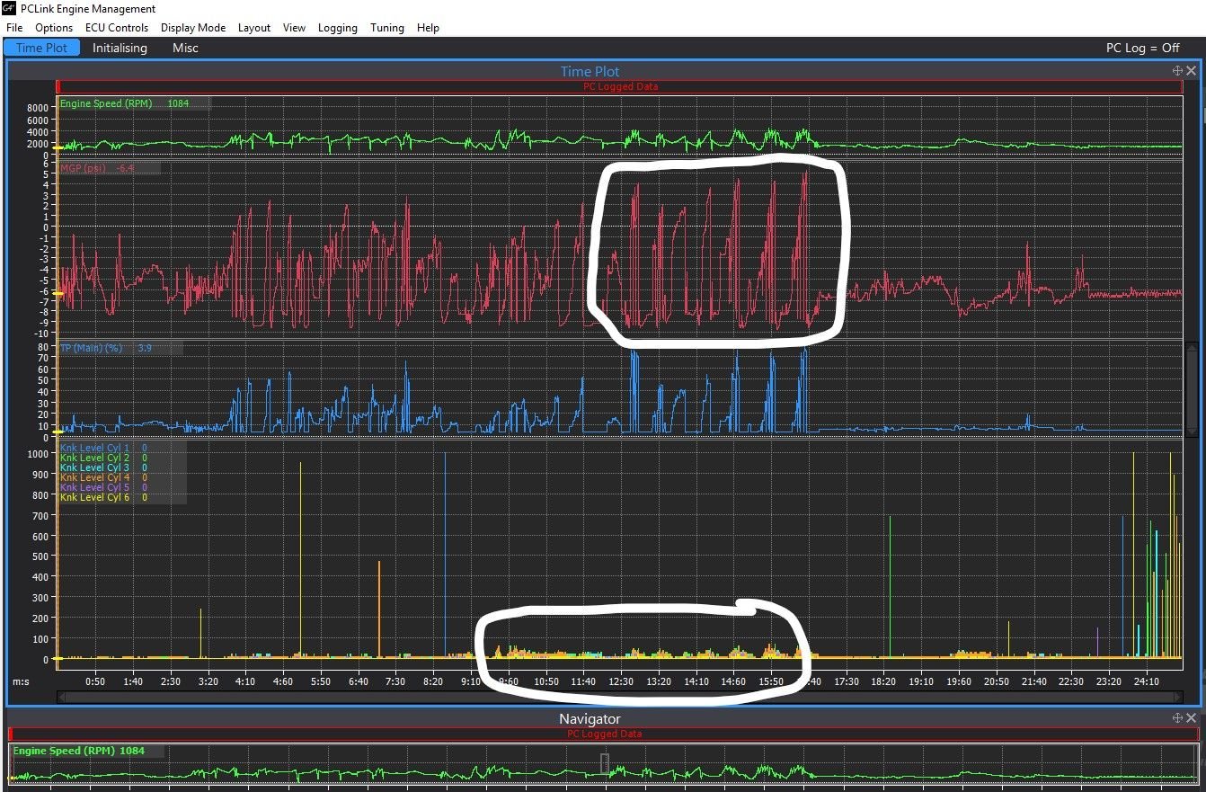

Tiny Tuesday Evening Update -
Finally cracked-open the datalog and according to the Link I hit 5.2psi of boost pressure!! Now I dont feel too too bad about the 6-8psi spring in the waste gate.
I had a few instances of knock in areas of the datalog you wouldnt expect (a few around 1400rpm and 2500rpm and all at single digit TP % and all in vacuum) not gonna freak out over them but I dont know how to explain it. Then in areas of boost I had some recognized knock but nothing that would suggest detonation.

Forgive my silly q, doesn't your stand alone recognize knock and retard timing?...

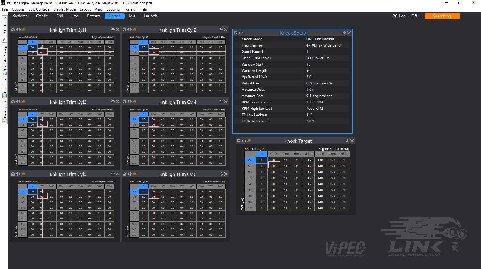

It does - (I'll upload a screenshot)...The link has a threshold table that ignores any knock under a given value for a given RPM … sorta a lock-out if you will.
From there once knock is recognized you can trim each cylinder's timing based off a 3d table of RPM and boost/load.
and this table is 100% blank...I have pretty safe ignition timing values where I shouldn't be anywhere near detonating. Hence my surprise when I had a spike for no reason.

Knock down that low in vacuum sounds like false knock. I wouldn't worry about it.
I have to admit I admire your cajones flying by the seat-of -your-pants! Are you running an AEM wideband FailSafe? (asking for a friend )

lol ... nah ...no AEM fail safes ...I should dial back timing in the knock table … sorta foolish to leave them blank. To my defense, my ignition timing is stupid safe
top circle boost and when I was getting into the throttle / lower circle shows some minimal knock values … then you see other spikes of knock … especially when the car was cooling down (far right)
Knock retard setup … Any knock below the 'Knock Target Table' is ignored but once the knock climbs above that user-defined value, each cylinder has a trim table that will be activated based on load and RPM.

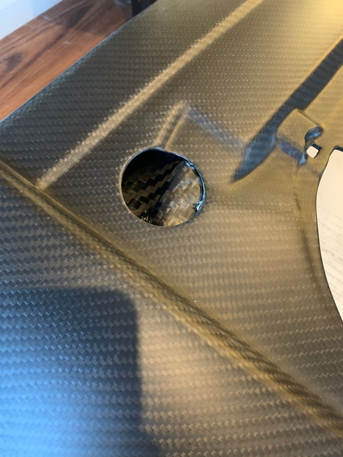

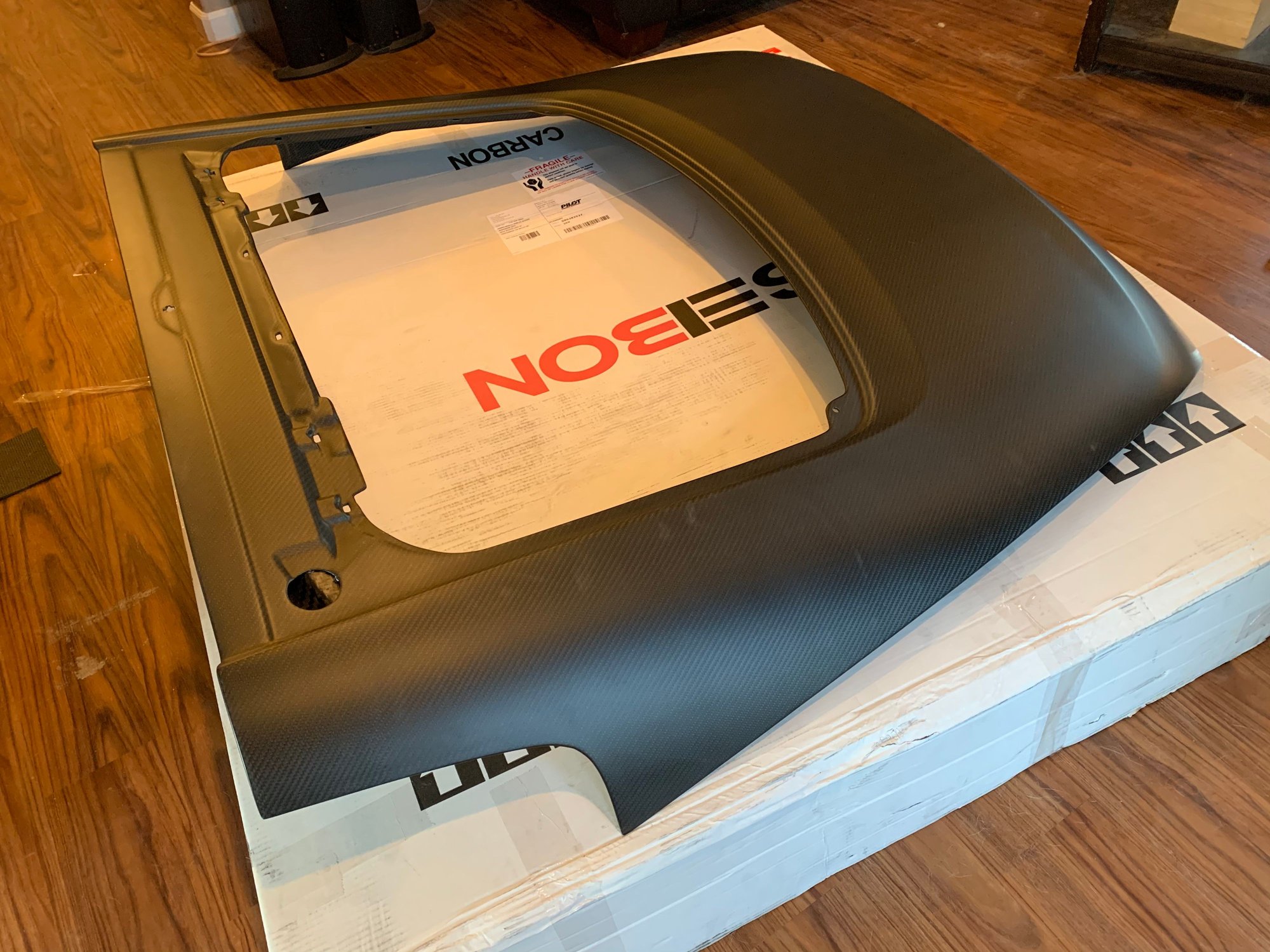

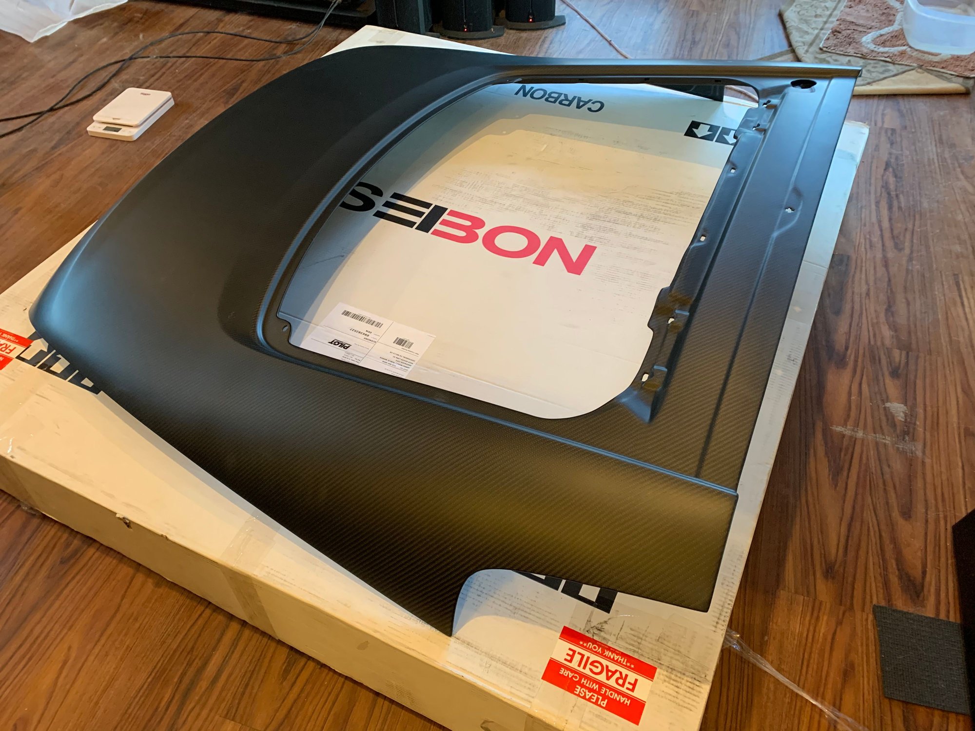

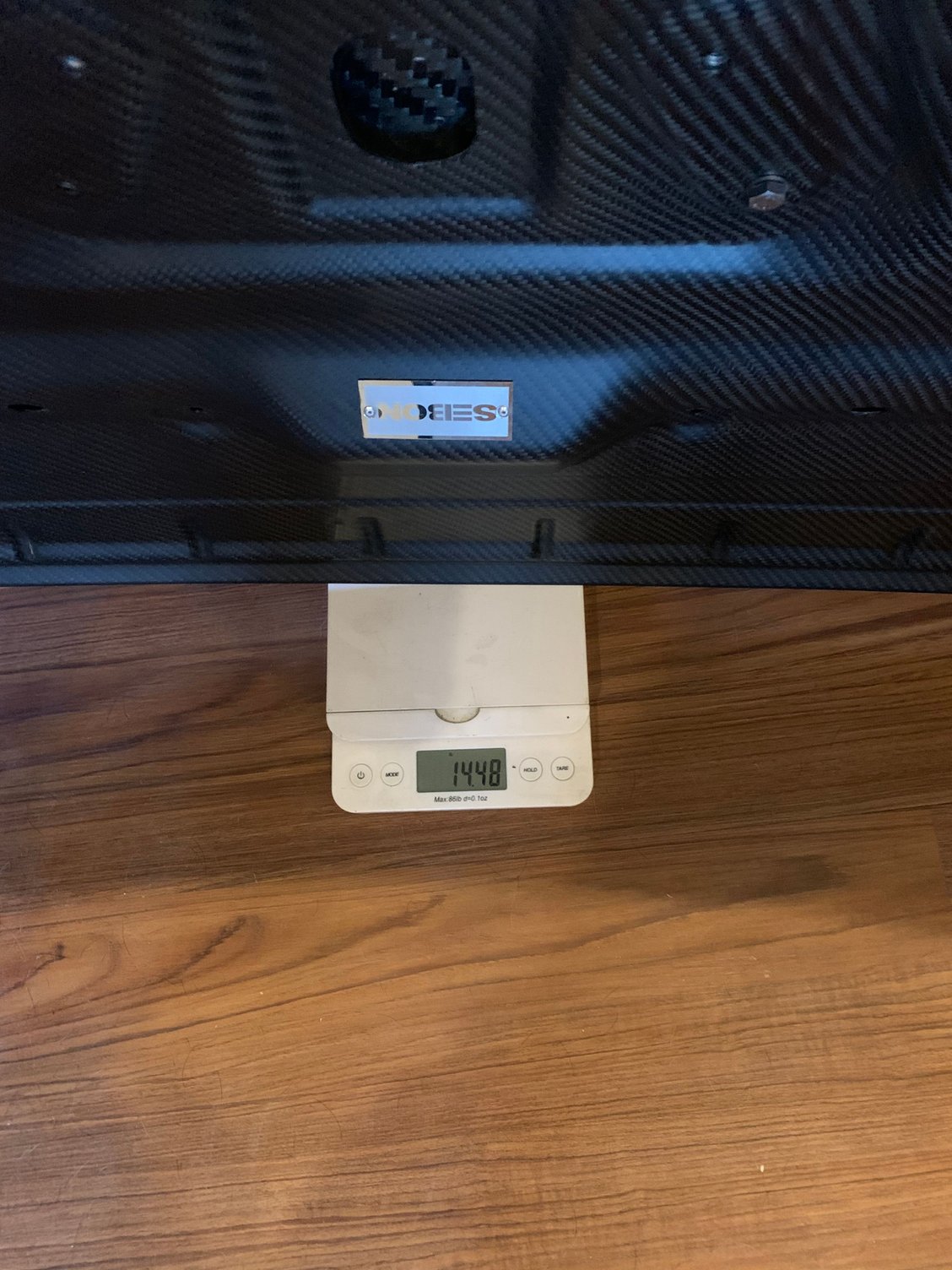

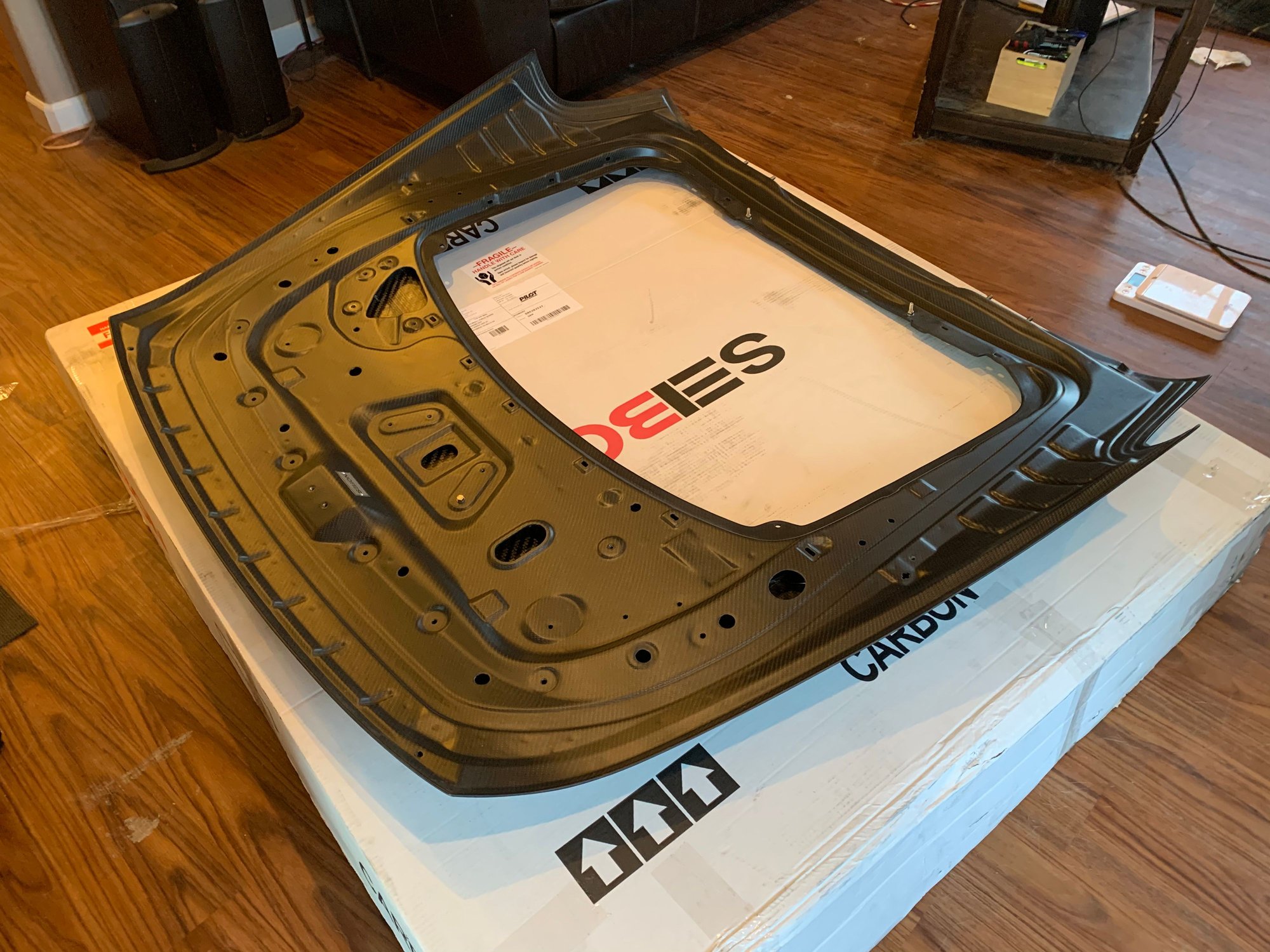

Welcome to the weekend ... got notification that the hatch came in...so I went and picked it up...all sorts of stoked for this one. It's been one of those pieces that I've had my eye on for years and couldnt find it used or didnt have the cash. Picked up a bunch of side-welding, did the turbo kit on the blue z, sold a bunch of stuff out of the garage, and parting out the black Z and saved up enough...
My initial impressions is that it's pretty kickass. I was worried that seibon was gonna use high-end dry carbon fiber for the shell and mild-grade fiberglass for the underlying structure but it's 100% (or at least 100% from what I can tell) dry carbon fiber. Without glass/lexan is between 14lbs and 15lbs. I speculate that lexan will be in the 6lb to 8lb range. I have a piece I was gonna use for the previous 'rescue' hatch and it's 13lbs for 1/4" and I may drop down to 1/8" or 3/32". I thought the carbon fiber weave would have come through the resin a little more but it's 100% smooth.
lol Rusty!!! Way to keep me honest

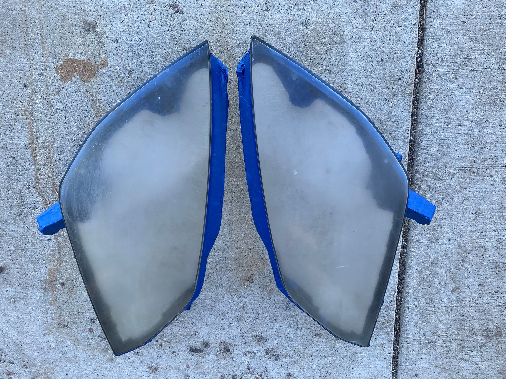

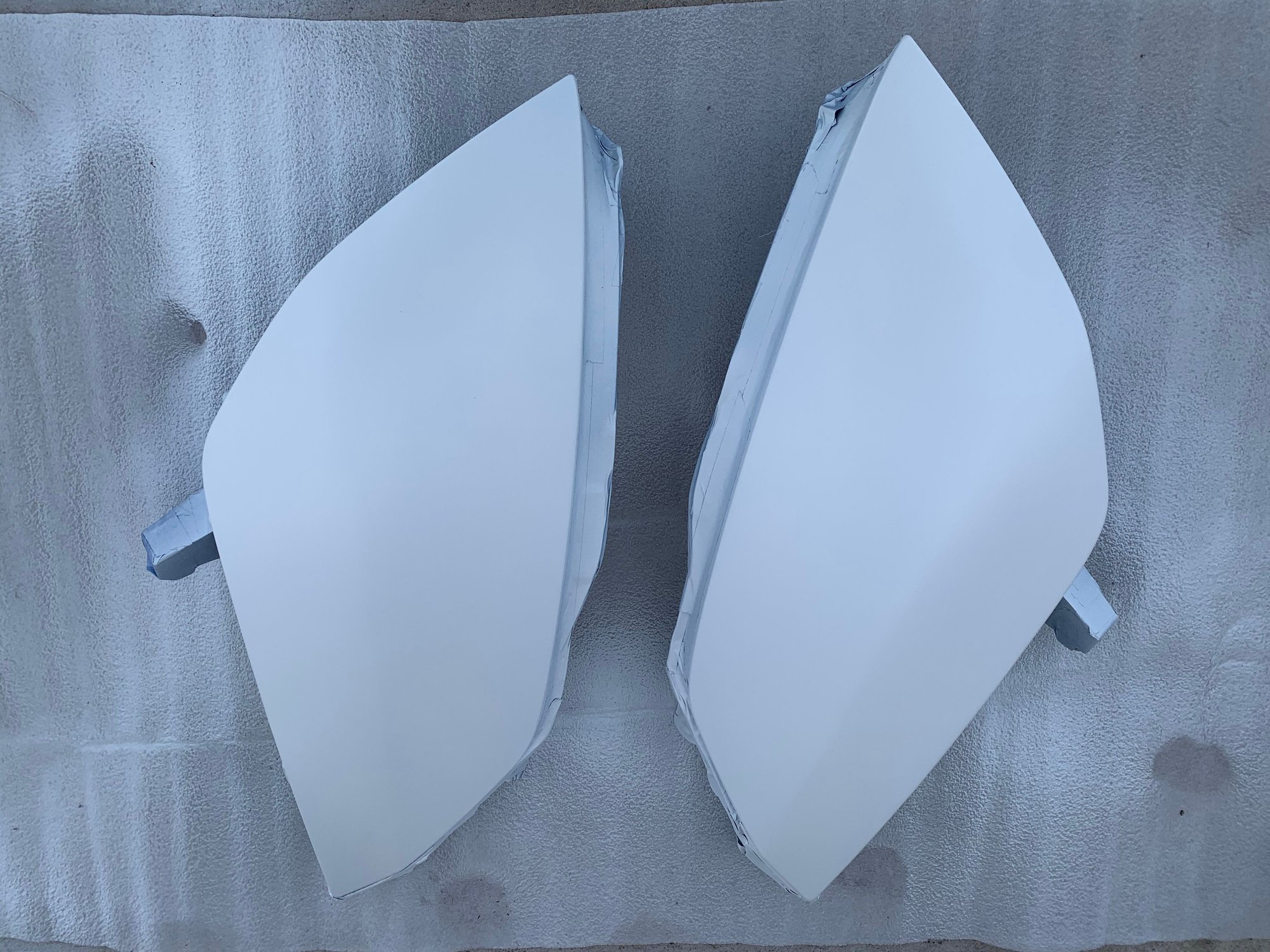

A productive Saturday - weather was pretty nice - mid 60s - ok...so all those shooty days - this 'starts' to make up for it ... put a round trip to the store (25miles total) on the car and it did fine. I wasnt as agressive on boost as before but hit that 5psi mark a few times. I did a quick once over on the data log for the 12mile trip to the store and did Link's Mixture map and all the cells were within 2% of my AFR targets. Nothing for the trip back. TBD.
I copy/pasted the warm-up tables from the base-map, and it's better, but it still wants to die after start-up...so I might have to tinker with the warmup/post start maps.
got my faux-pa headlights cleaned/taped/painted - painted them with a can of kylon matte white ... not too sure how I feel about them but we'll see - might repair to better match the OEM paint...we'll see. (I did weigh them and they are 2lbs - stoked!)

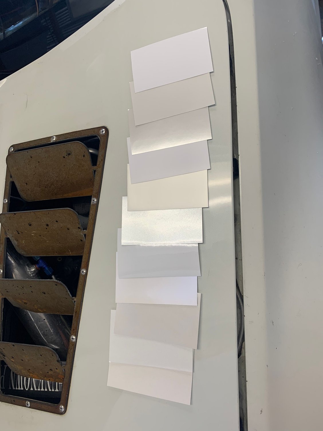

Likely going to wrap the hatch ... I am gonna get about 15 samples of different shades of pearl / glacier / pikes peak white from Metro-Restyling ... if I can find something close I'll be wrapping the hatch. More on this later.

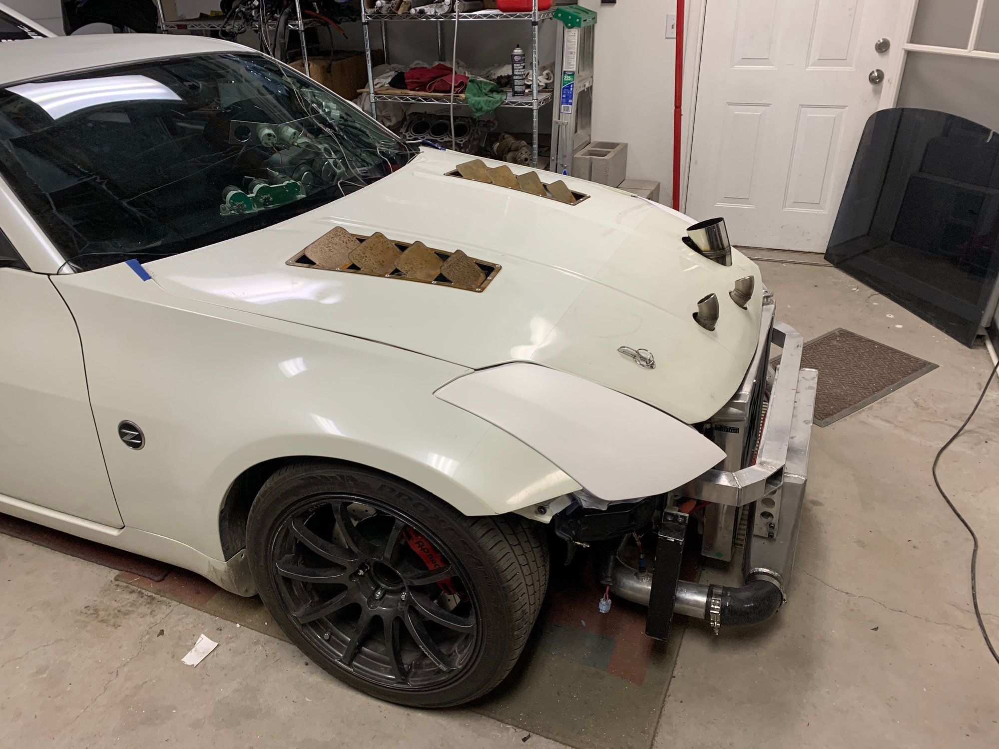

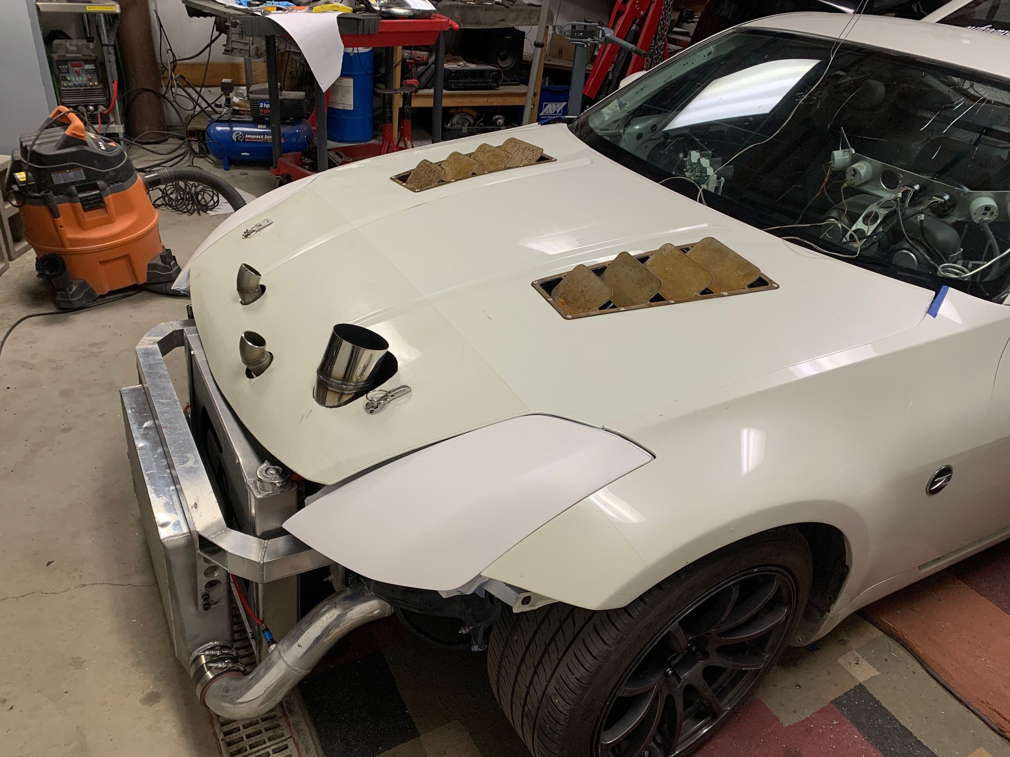

Been working on a a small front splitter, flat-floor, and rear diffuser - nothing crazy like time attack or le mans but something to block off the airflow from the undercarriage of the car ... I'll post pictures once I'm done.
Also chopped the rear bumper to accommodate a diffuser. I initially like the look and I think the diffuser will compliment the look.
The alumalite panel here is a rough-cut - it's been since wildly cut & trimmed down

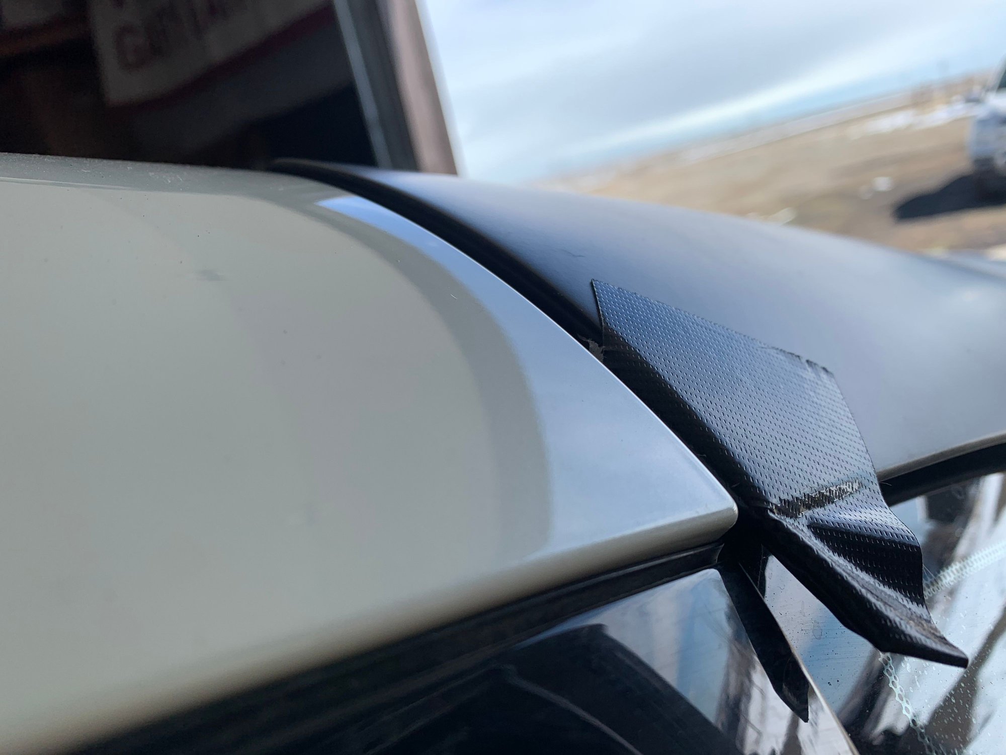

Got the OEM hatch off the car and test fitted the carbon fiber hatch. It fit pretty damn-well and nothing that can be adjusted out by adjusting the OEM hinges.
I'm not 100% satisfied with the plasti-dip color match and my next best (non-permanent) option is to wrap it. I jumped on Metro Restyle and picked up 11 samples of glacier white squares. Gonna narrow down a shade/style and order a sheet for the hatch. If all goes well I may wrap the entire car ... saw some fun textures.
