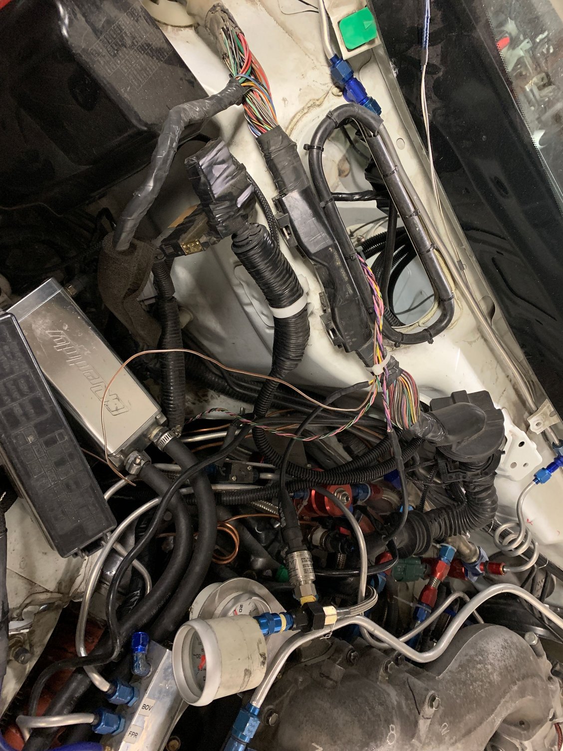

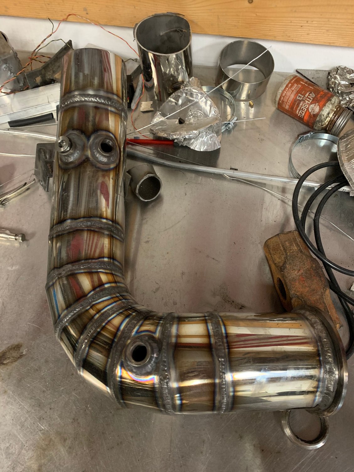

the three link sensors all went out - I figured it was something simple (the Link was still pushing out 5volts and I messed with the wiring (put nylon sleeve around it to clean it up)...turns out the 5volt power source pin (On the sensor side connector)wasnt seated right ... fixed and fixed...

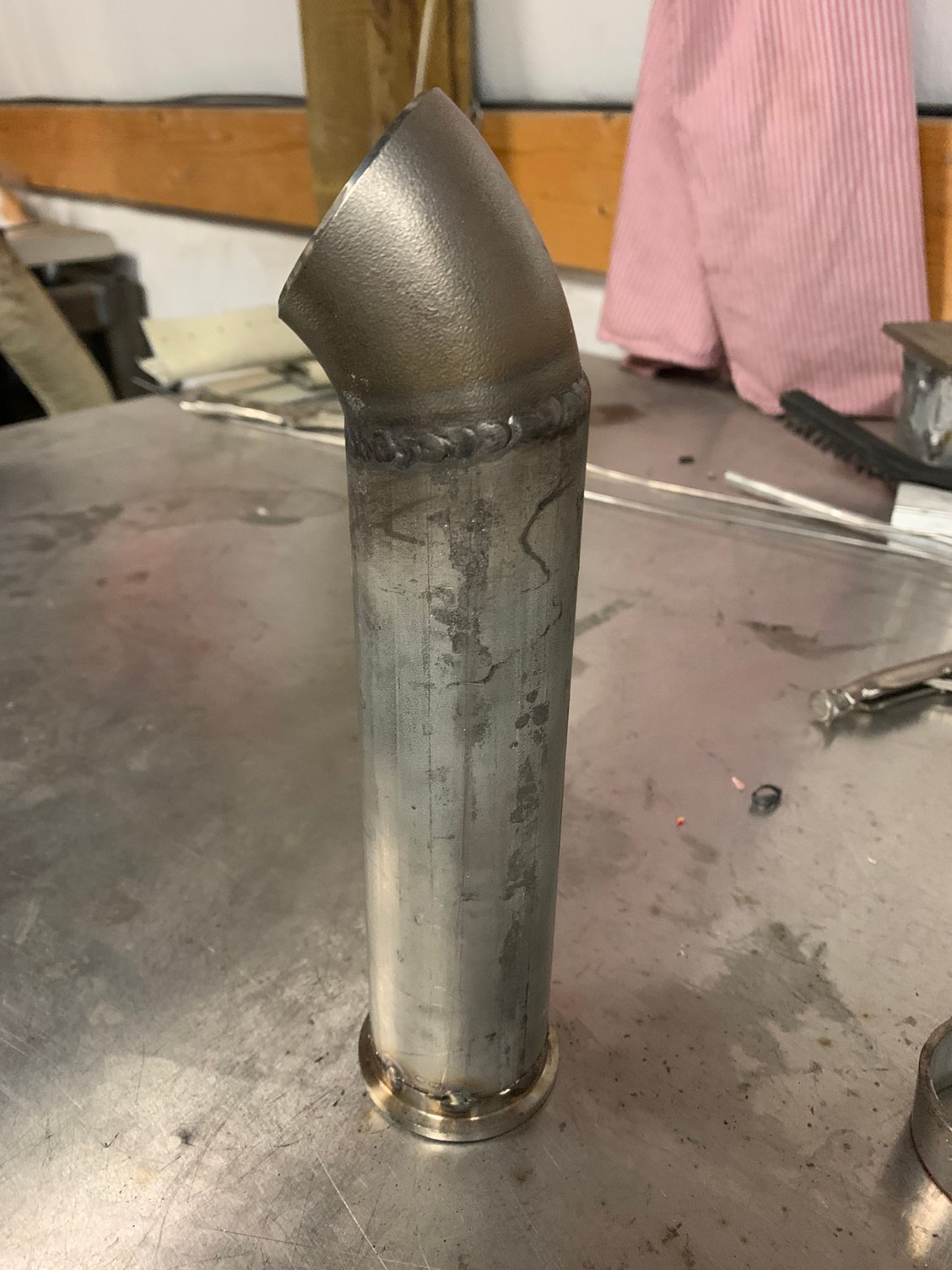

Got the exhaust off and hole drilled for another O2 sensor. A quick 7/8" hole, tack-weld and check prior to welding it in. It is 9" to 10" from the exhaust turbine wheel - so we'll see.
got going on the dump tube - gonna go hood exit similar to the exhaust. Got the passenger side about 95% there - just gotta final-weld the v-band flange to the tube. Will do the drivers side tomorrow. Just taking the 2" exhaust runner leftovers and capping them with a soft 45* bend. I also chopped the top of the pipe with a 5* to 10* angle to further pronouce the angle.

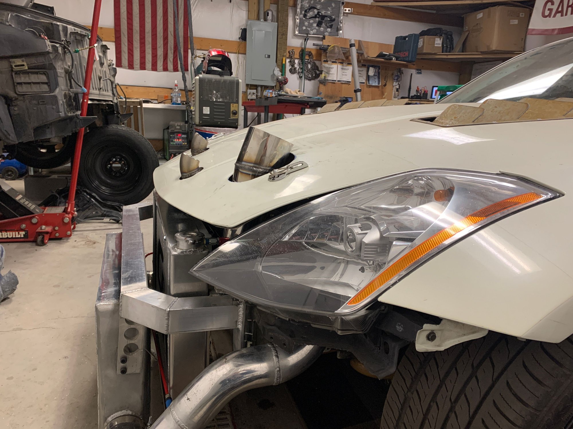

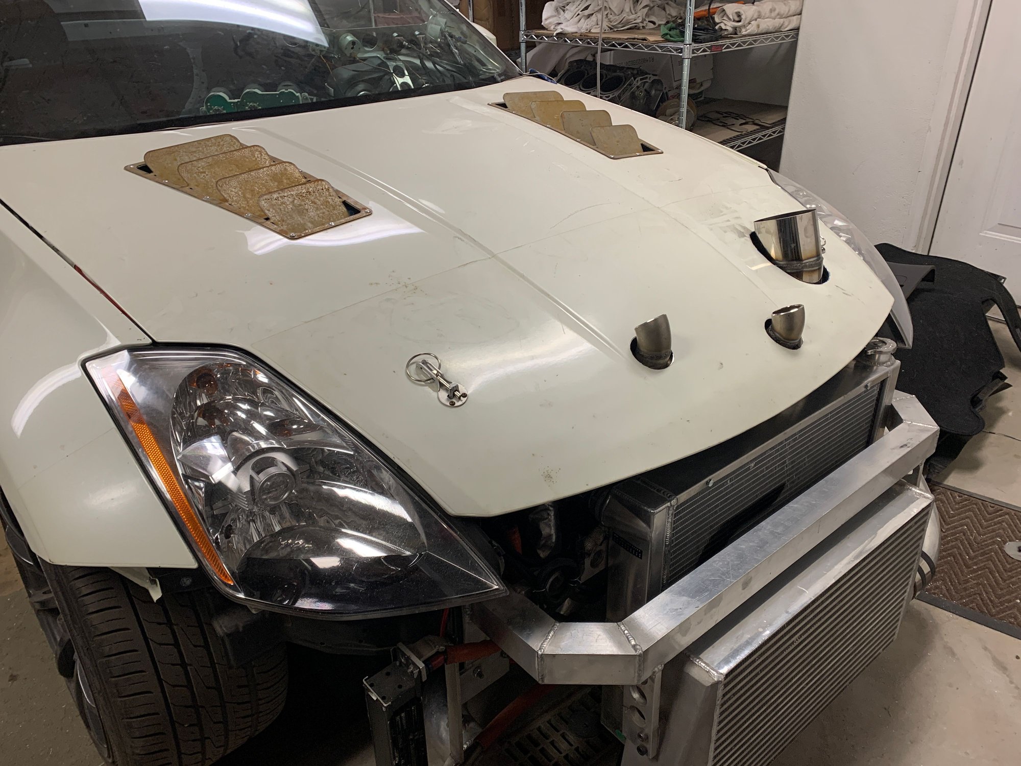

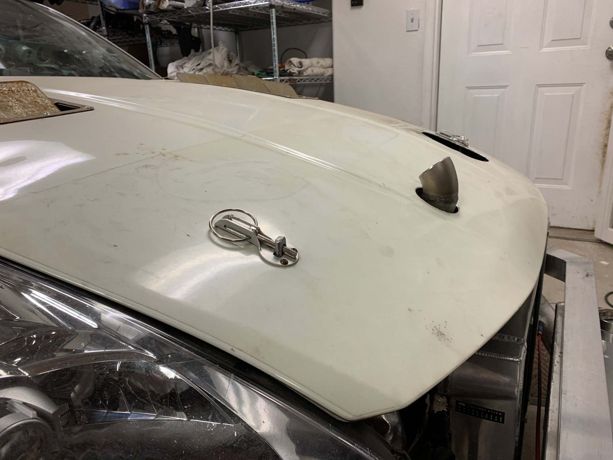

finished the hood exit dumps ... you ever hear the saying 'pleased but not satisfied' ... pretty much how I feel right now. The turbo manifold is a few degrees rotated off center and it's very apparent with the waste gates as they extend out so much ... chalk it up to my lack of precision and that I did this header setup by hand and very little computer aid.
with this minor discrepancy the driver side (and a exhaust runner is sort in the way) isnt symmetrical with the passenger side and rather than fight it I said 'f-it' and punched the hole lower. I think it came out alright but if I dont like it this way I will do them symmetrical when I replace this hood. None the less, it's done - cross it off the list.

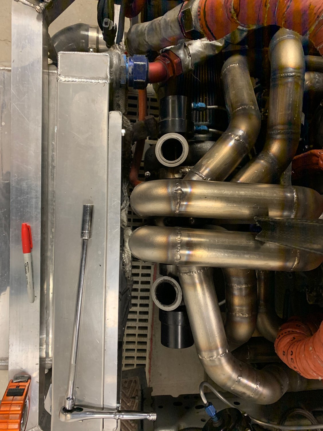

well ... I feel like a total schmuck ... I had a issues getting the car started Sunday night and subsequently had to push the car into the garage - sorta disheartening.
new plugs came in on Monday and got pecking away at them when I got home ... with the plenum off I was able to access the coils/plugs. One feature the link has is the ability to test fire coils/plugs and injectors ... ran through them one by one. Plugs 2, 5, and 6 were fouled pretty bad while 1, 3, and 4 were still firing. When I got to cylinder #1 it wasnt kicking at all...and surer than shoot, I didnt have the sub-harness connected for cylinders 1, 3, and passenger side VTC solenoid - I was dumbfounded when I came across the disconnected harness. Got the harness reconnected and plugs tested and good to go. Plugs gapped to .04", torqued-in, and coils reinstalled.
Next task is extending the OEM coolant hardpipe from behind the engine, up and over the passenger side exhaust runners and down to the radiator.

Somethings are easy to over look when many projects are on the mind. One reason i break projects into small sections so i don't miss things. Even still i had 2 hose clamps that i didn't finish tightening after installing the engine. Fix 1 small leak the first week and the 2nd leak didn't show up for over 1 month. Especially if you have anyone chatting with you while working like i normally do, so much easier to get distracted. Glad you found the issue. Why not try starting the engine before you start messing with the cooling to keep possible problems isolated?
That's smart - I try to make checklists and be diligent about organizing hardware so that I know that I put all the hardware back in. I'll start thinking of things that way - I can see how it works and works well.
Yea - I'll do that … I need to keep the engine unbuttoned to fab/measure the coolant pipe. I will probably have to install the coolant pipe prior to buttoning things up as the coolant pipe is well-under the fuel lines...but I can start-up prior to refilling coolant.
Overall, happy nothing crapped out!

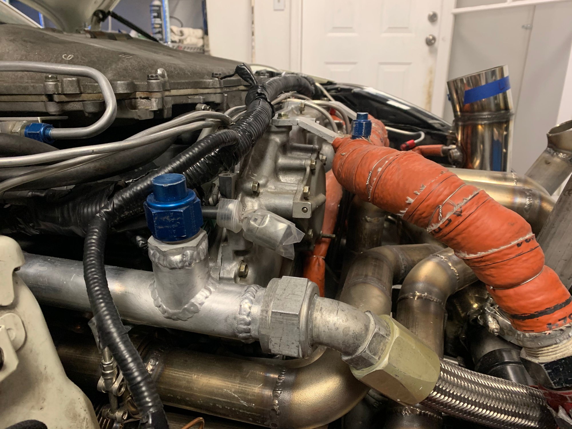

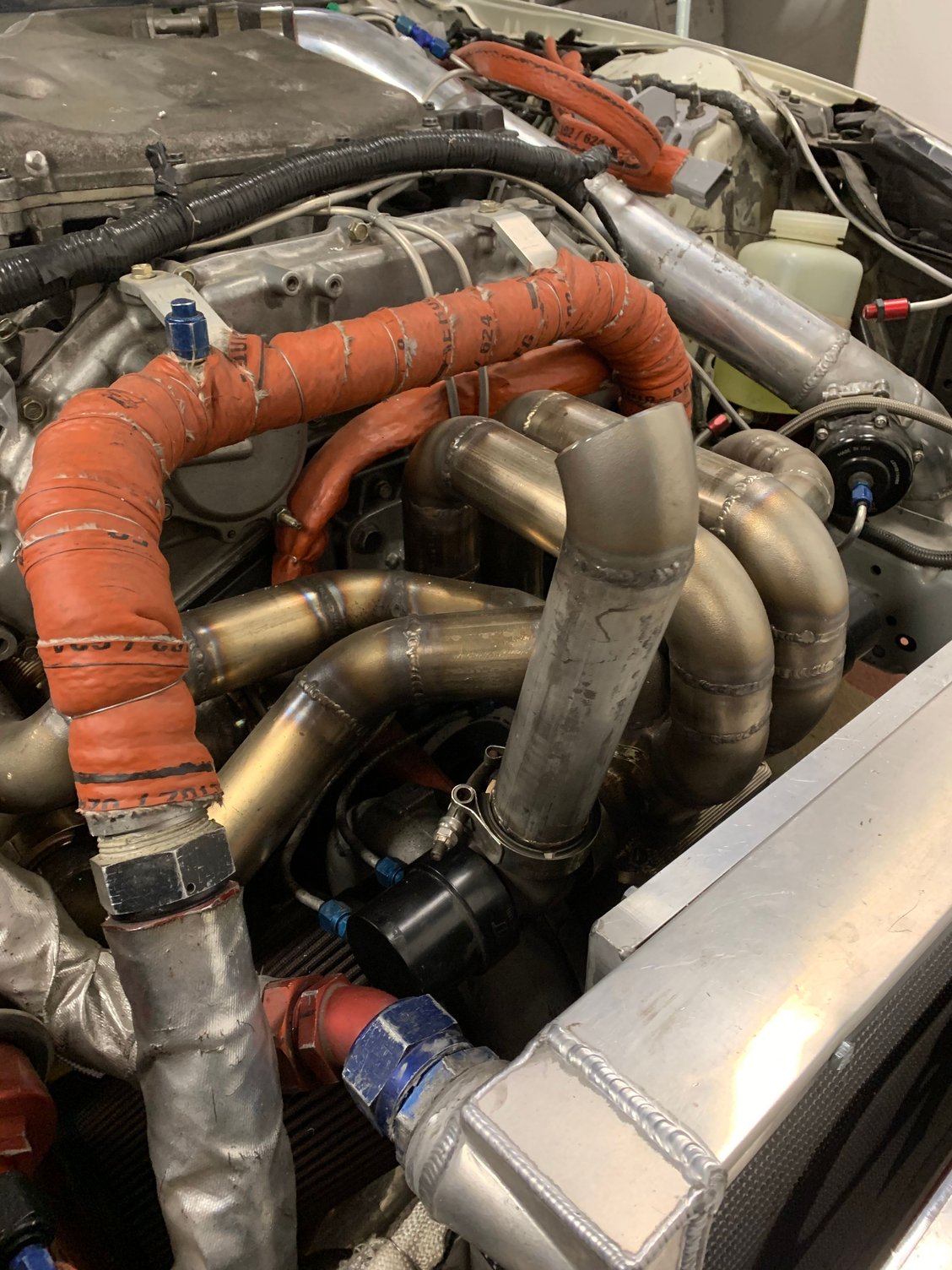

got a fresh tank of argon and about $60 in aluminum including a 3ft stick of 1.25 ID tube. I was going to use the 1" ID but it just seemed too small. Got angles cut and fitted, the OEM coolant pipe off the engine and prepped and spent wednesday night and tonight(thursday night) piecing it all together. The welding came out alright, might have come out better if I would have cleaned it more. It's gonna be wrapped so I didnt want to get too tangled-up with it. I'm not entirely happy with how the shorter section of steel braided line is going to run from the radiator to the hard pipe as it'll only have an inch or two of separation between the exhaust runner and the pipe. If it ***** out, I'll revamp it.
finished the welding and I can rebuild the steel braided hose and reinstall. I like using coolant rated gasket maker on the connections so it'll need day to cure before I refill.

Got everything buttoned and did about a 10minute 'just look at stuff in the engine bay' followed by a prime the fuel pump and sniff for fuel (as I did take the intake manifold completely off) to ensure things were buttoned up and no leaks ... Did Rusty's start-up recommendation and took a little more cranking than I anticipated (about 5 to 7 seconds worth) but it finally caught and I ran it for about 15 seconds ... nothing crazy.

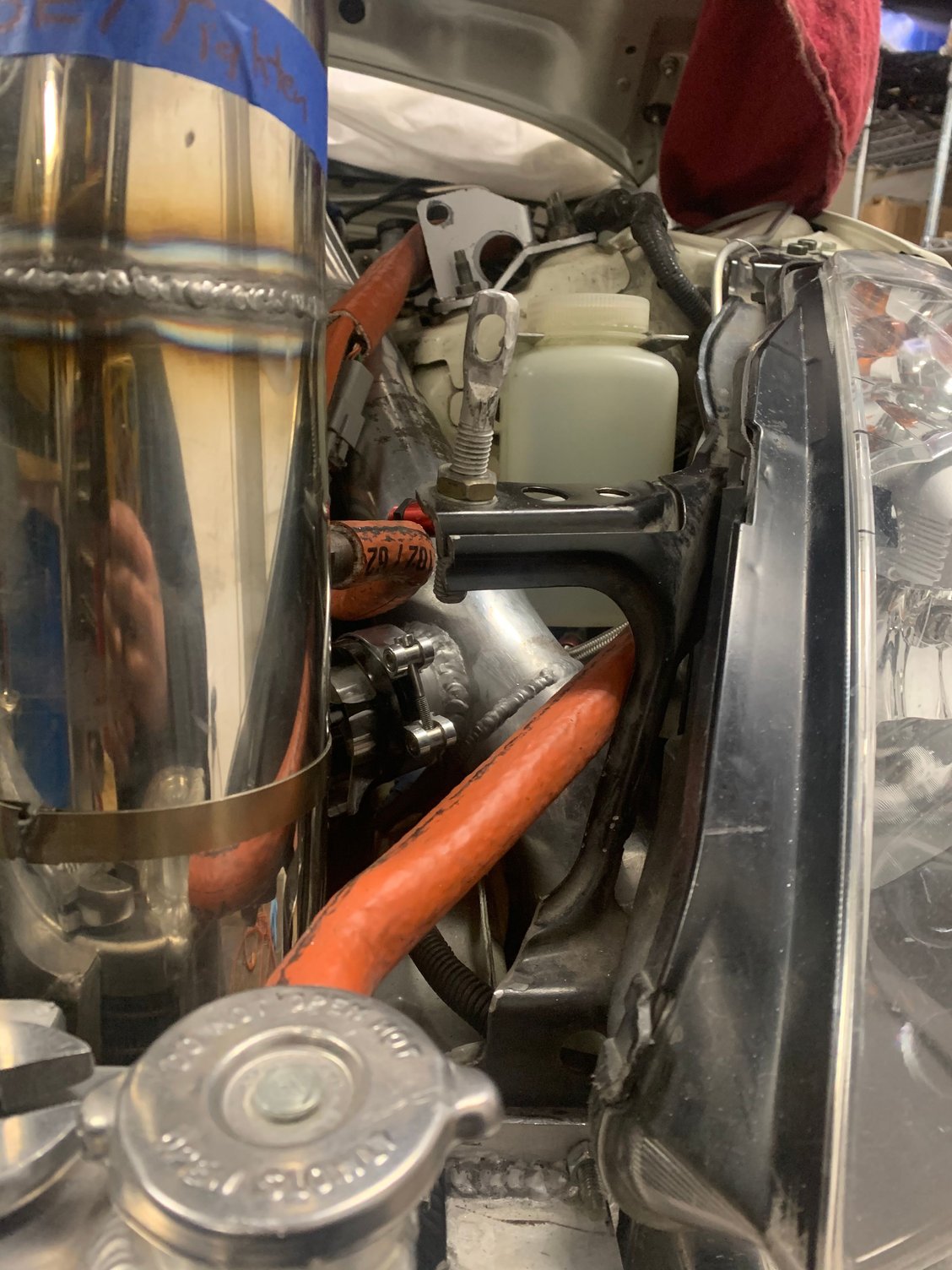

Despite it not being the highest point on the coolant system, I added a 5/8" fitting on the new coolant line ... it's the same 1.25" ID pipe and I think something that big will do a better job catching air bubbles. I may give the sealant another 24hrs to cure (applied it on Saturday afternoon) before I refill...

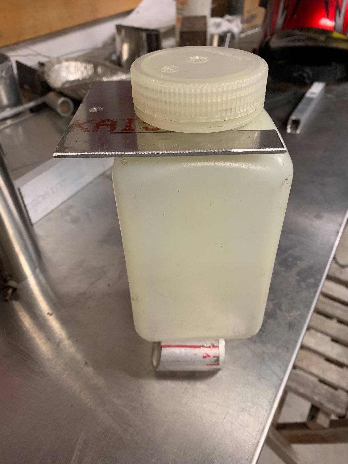

other news ... started a coolant overflow bracket...have been struggling with this but I think I have a solid idea by making a collar that I can mount to the chassis (to this effect):

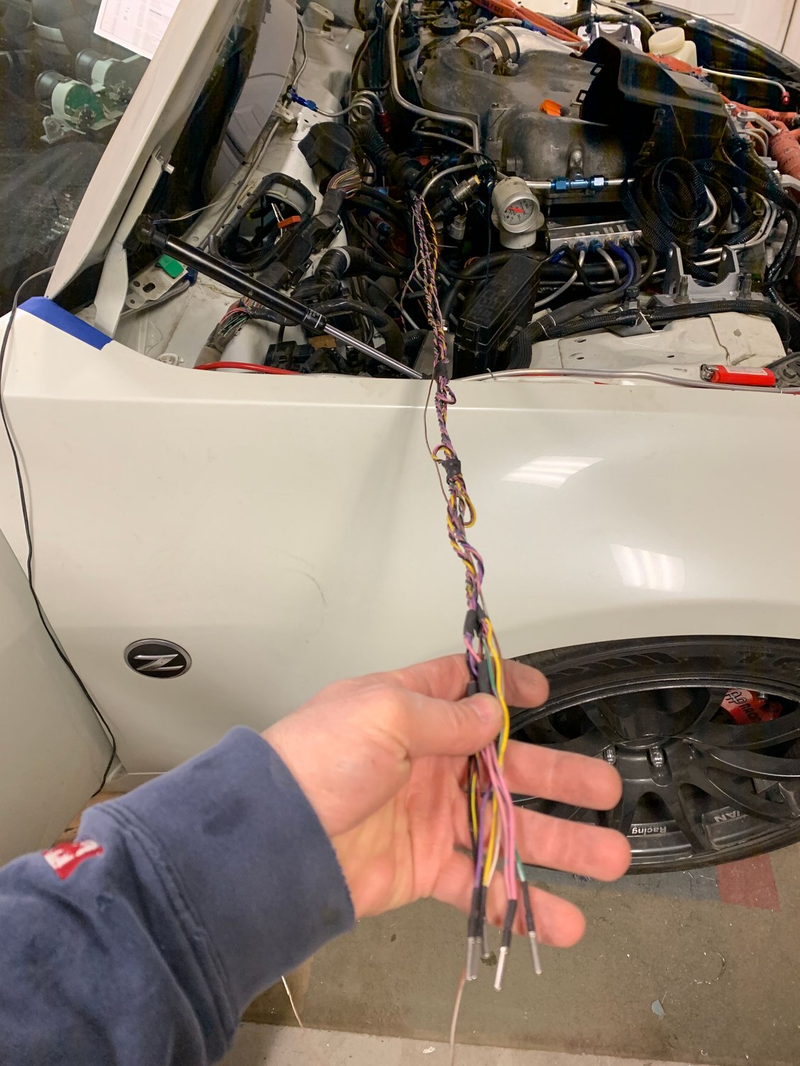

Aside from bulstering-up the injector/coil ground connections I didnt do much outside of filling/bleeding the coolant system ... started up the car 4 or 5 times, running it for a few minutes in the garage to cycle the coolant and I think it's bled-off ... helps quite a bit that I have my one-off fill points and a small hole in the thermostat plate.

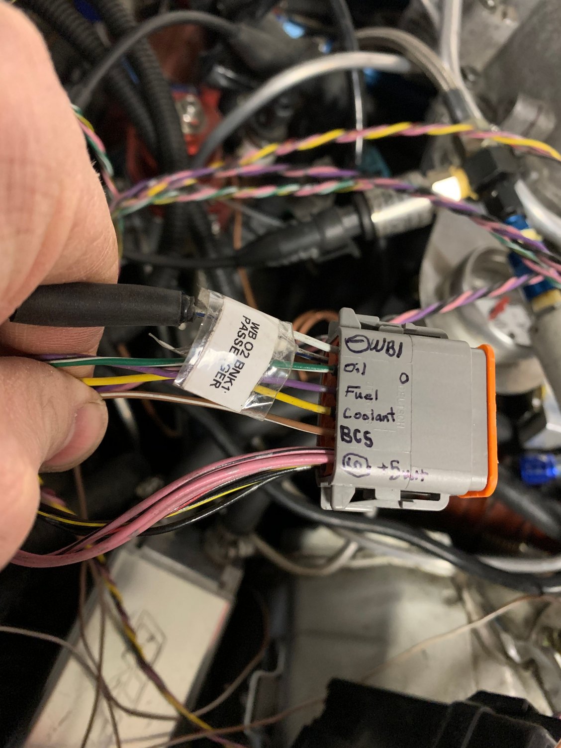

I forgot to plug my ECT sensor in...so that caused a hiccup and I think I'm missing a ground or something on the fuel tank line or somewhere on the harness that runs down the drivers side. My fuel temp sensor is pulling a error code, no fuel level on the dash, my fuel tank door button, and trunk popper button are inactive. I'll poke around the FSM.
