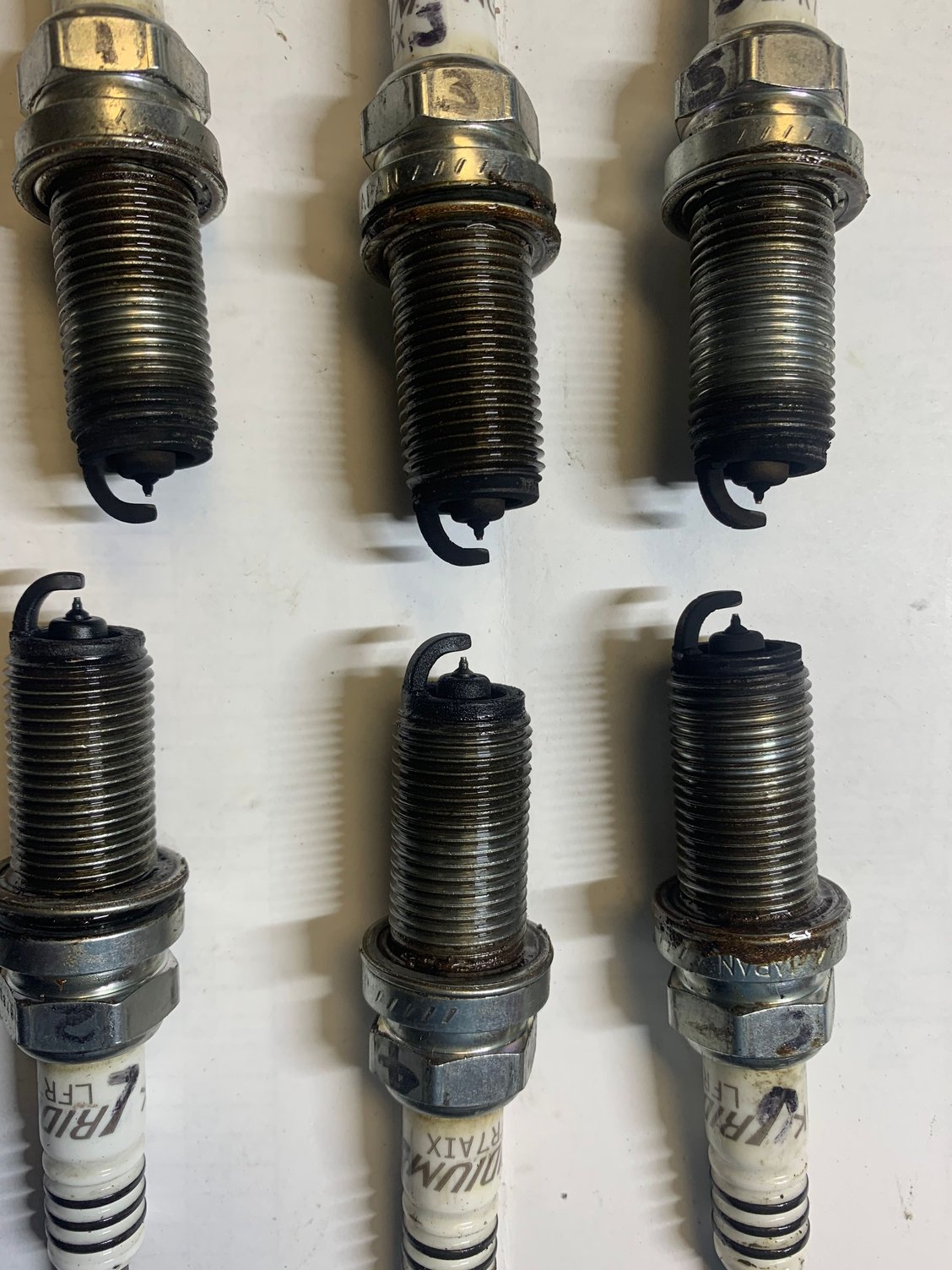

Spark Plugs ... pulled the plugs and I speculate I'm running super rich. Which I sorta knew.

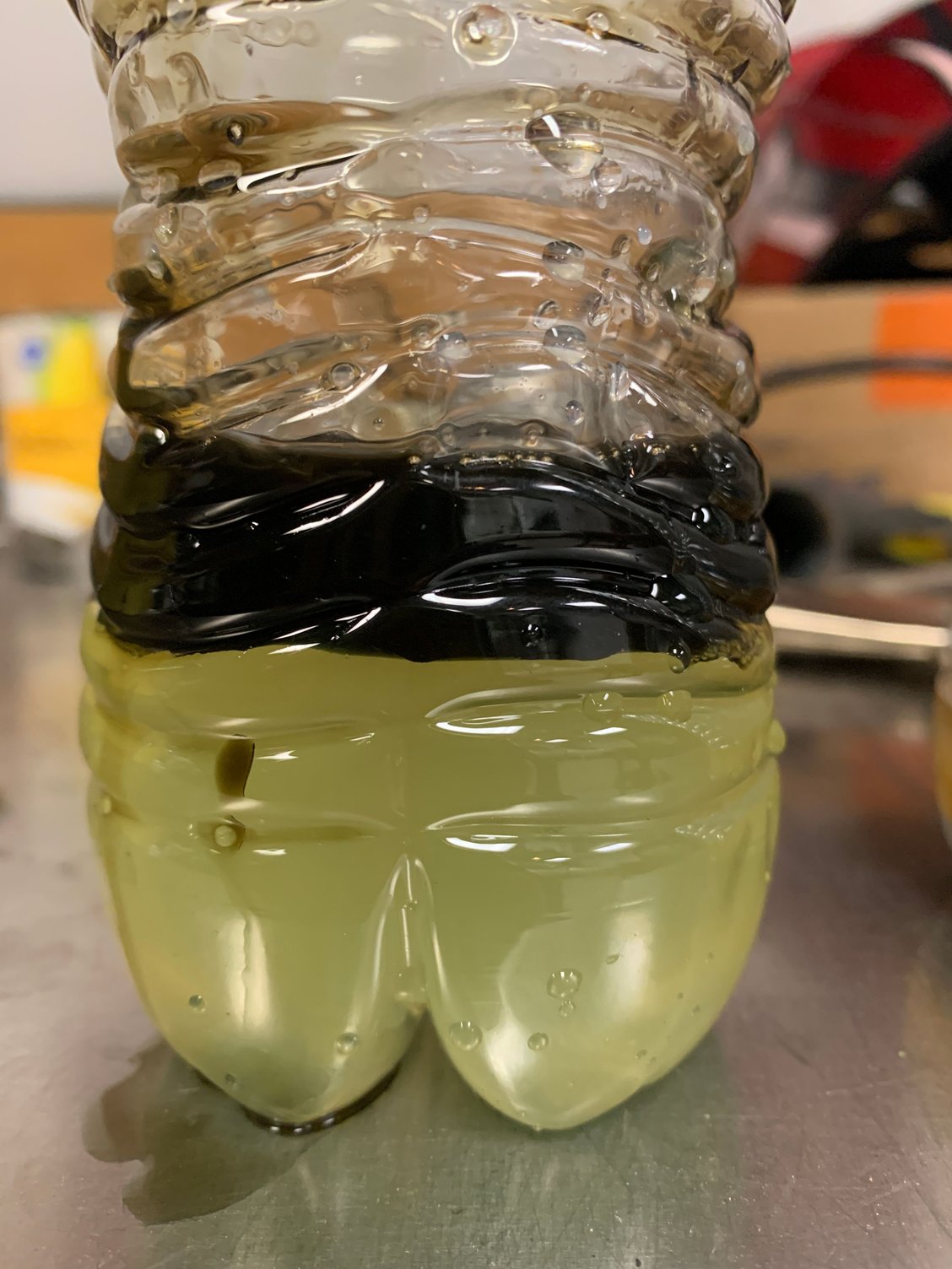

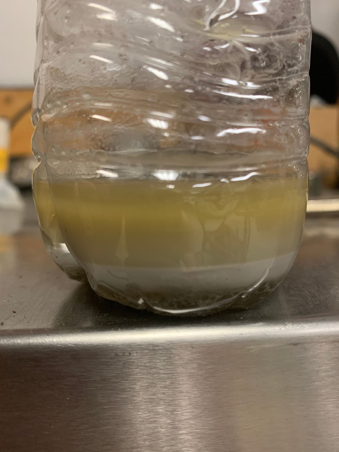

With the gunk oil/coolant mix. I'd honestly tend to think its condensation. I get a similar build-up on the bottom side of my oil cap when it's cold and my car has sat for a bit. I am curious what your compression looks like with a better gauge though.

I dropped the oil and nothing looks crazy ... I did take a few ounces of coolant out of the radiator and a few ounces of oil from my drop-pan and the oil (obviously) is floating on-top the coolant/water mix.
I have a random 2liter bottle and I'm going to fill it with the oil to see if any coolant/water settles to the bottom over night.
Part of me wants to take the car out and hammer the **** out of it and see what happens ... trial by fire!

I am pretty sure my spark-plugs are fouled as not all my exhaust runners are heating up at the same rate. This likely is causing the excessive exhaust / unburnt fuel. (hat-tip to Rusty)

gotta get another set of spark plugs in the car. And a round of checking coils would be smart.

Moving forward …
I'm gonna get the coolant hardpipe off and re-route the coolant (likely above the headers - but pondering how I can run the line below without it interfering - ehhhhhh, may be a bad idea). I ordered about 4 sticks of 36" 1" ID aluminum tube. I may re-do the cold side as well - I don't like how it's laid-out.
Another set of spark plugs ordered and I think I may open the gap up to .035 to .040 from my current .03"
Also gonna do a round of checking coils per the FSM.
and take the exhaust off and put in a new bung
trouble shooting in the ECU and decommission one O2 sensor.
