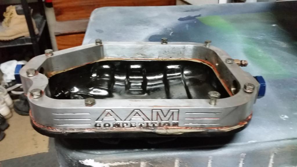

You can grab an oil pan spacer that has the oil feed and return ports pre tapped also. I have one..
What kind do you have? Does somebody make one that is the whole pan that has the holes pre tapped rather than just a spacer?

Is an oil pan spacer a must?
Old Dec 7, 2014 | 08:20 PM
  #52
bealljk's Avatar
bealljk
Joined: Apr 2010
Posts: 6,504
Likes: 1,325
From: North Denver
No, but you (obviously) need to give your turbo a port to drain back into the oil pan.
I highly doubt you can get feed oil off the oil pan, just return.

From: G'ville SC

you can run the oil feed from where the oil pressure sensor is with a "T". and use the oil pan spacer with pre-threaded ports from JWT, Z1, etc. for the oil return line. so you don't have to drill into your upper oil pan.

If I went back and did mine over I would have drilled into my upper oil pan and saved myself the $100. (or whatever it cost)
