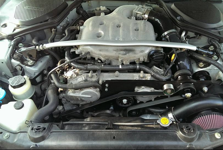

Put the bottom of the coupler on, then work it around and run a small flat blade screwdriver around the edge from the TB side as you push. It'll slip right on. The TB and MAF housing are really more like 3.125" or 3.25" but it's not too hard to get 3" couplers on there. I pieced my Vortech kit together and I just used a 3" 45° at the TB instead of the pipe and couplers:
Yeah it was a bit of a pain, but it's totally possible.
