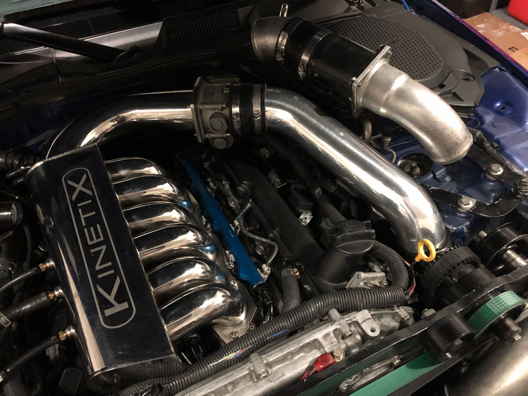

Replaced my 3 piece janky charge pipe with the R-Rydes Vortech piping last night. A much cleaner look in the bay for sure.
