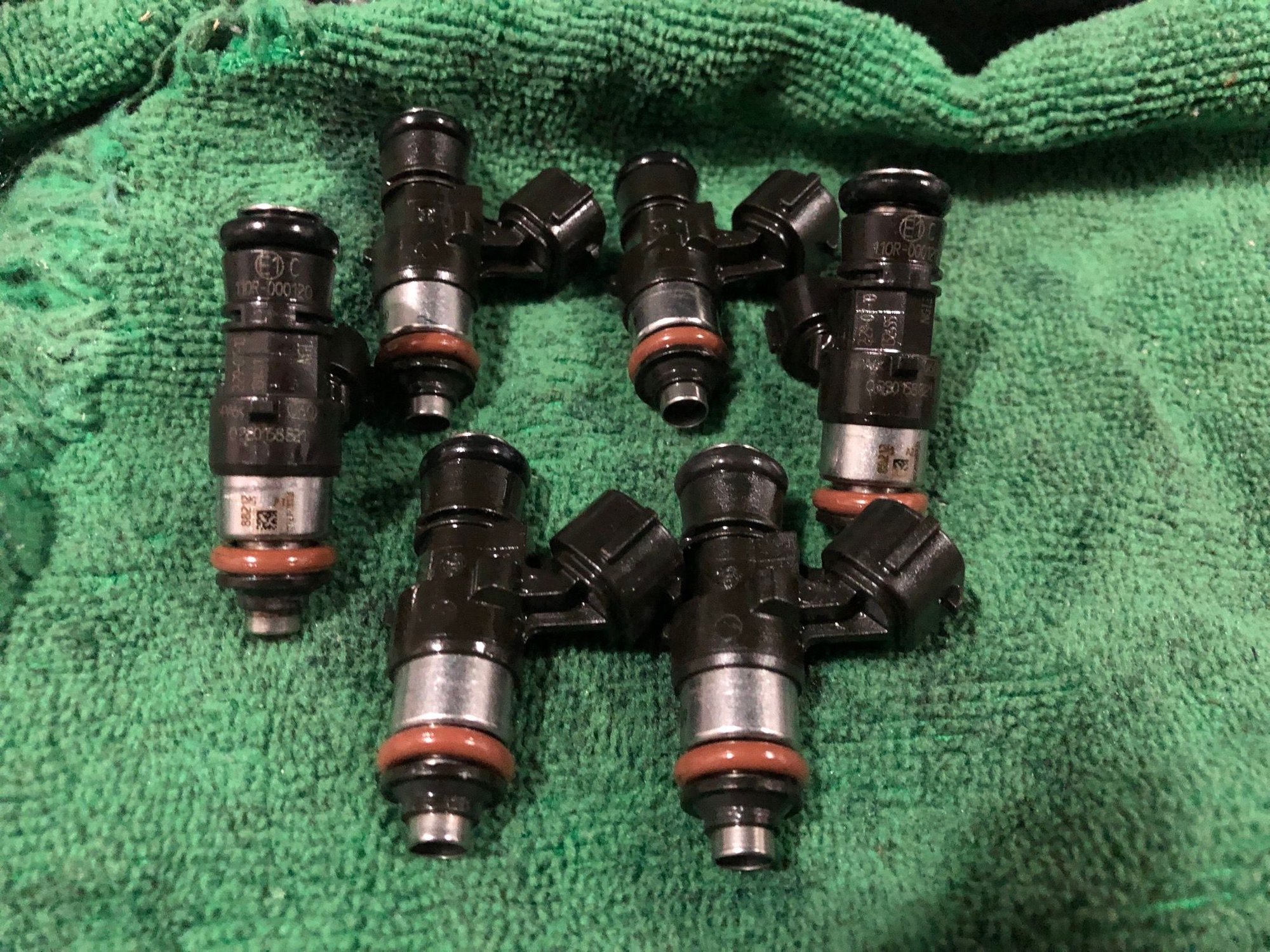

Soo, I've been eyeing a set of six authentic (not china made) Bosch 2200cc (210lb) injectors for sale lightly used off an MK3 Supra. Seeing if my bid falls thru for purchasing.

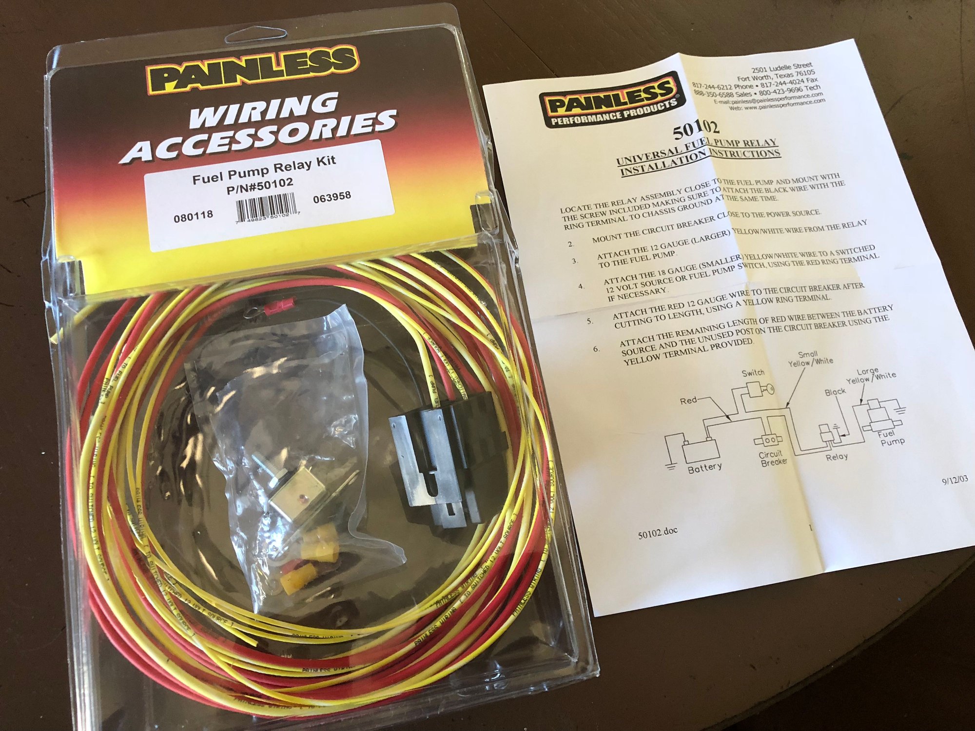

Drafted a wiring diagram for the project at hand soon. If anyone can put any input on this please let me know so I don't do more harm than good. Specifically thatv35guy if you can take a look if its similar to your setup. Much Thanks!

My sale went thru with the Bosch 210lb Injectors and i picked them up this morning in NC. They are a few millimeters shorter that the traditional sized ones im used to seeing for the Z. He had a 60mm adapter cap but i think it would be too long, gonna order the 48mm adapter caps with the 14mm O-rings and filter by the end of the week.
That looks right to me.

Thanks, gonna be doing some layout planning later on today, utilizing the lower passenger side cubby to mount the BAP and relay, while hiding the wiring underneath and running the other wires under the cabin carpet to the battery. All and all it should be a 3 hour install taking my sweet time.

Soo far I wired up the Hobbs switch to the BAP and Dedicated Battery wire with fuse to the battery from the Fuel Pump Relay. Nothing pretty but tried to get it as neat as possible without excess wiring
Another above shot of the Hobbs switch connected to the vaccum line. Below is a pic of the Kenne Bell BAP mounted in the cubby along with the relay laying on the side (Temporary spot until i mount it on the side of the cubby. Most of the wiring was cut to reduce cludder, and is stored underneath the cubby floor wrapped and ziptied. Last step is to cut the wire for the oem 12v source from the fusebox to the fuel basket/pump and attach one end to the relay and the other from the BAP.

Update on the project: This morning I secured the Painless Fuel Pump Relay to the side of the cubby using leftover metal scrap i had in the garage I saved for the longest. This way its not going to be moving around while the vehicle is driving.
Was kinda scared cutting the Black/Yellow wire leading from the harness to the pump, since this is close to the last steps to completing the install, and will be doing more research that later as a precausion. The FSM shows that that wire is the power wire to the pump, and i want to be 1000% sure and confident thats the wire to splice so i dont damage any wiring or components on the car's harness. I guess im just nevous, but thats better than being wreckless ��.
