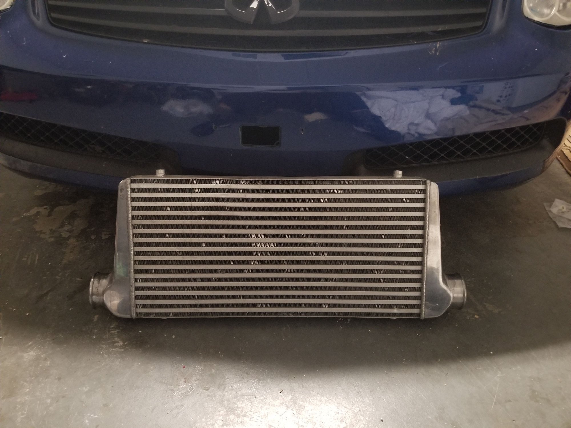

Well spend the better part of last night and this morning trying to mount the intercooler and fab up the intercooler piping. Here is what i have learned,
THIS FCKING BLOWS!
Went to lowes last night and bought two https://www.lowes.com/pd/USP-12-in-1...Strap/50325307 To support the intercooler. The down side is I need to make two 45* bends so that the intercooler is about 1/2" below the radiator, so that my front airbag sensor will clear the top of the intercooler. I currently don't have a away to bend it so that is making things more complicated....
I also realized that the intercooler piping kit i had doesn't have all the piping i need with out hacking and slashing it all up.
As it looks right now i have to wait until the blower gets back in a few weeks to figure out how to route the rest of the piping.

Relocate your air bag sensor to the intercooler. Then you don't have to work around it and it will work as it's intended. If you do, disc. the battery 1st.
