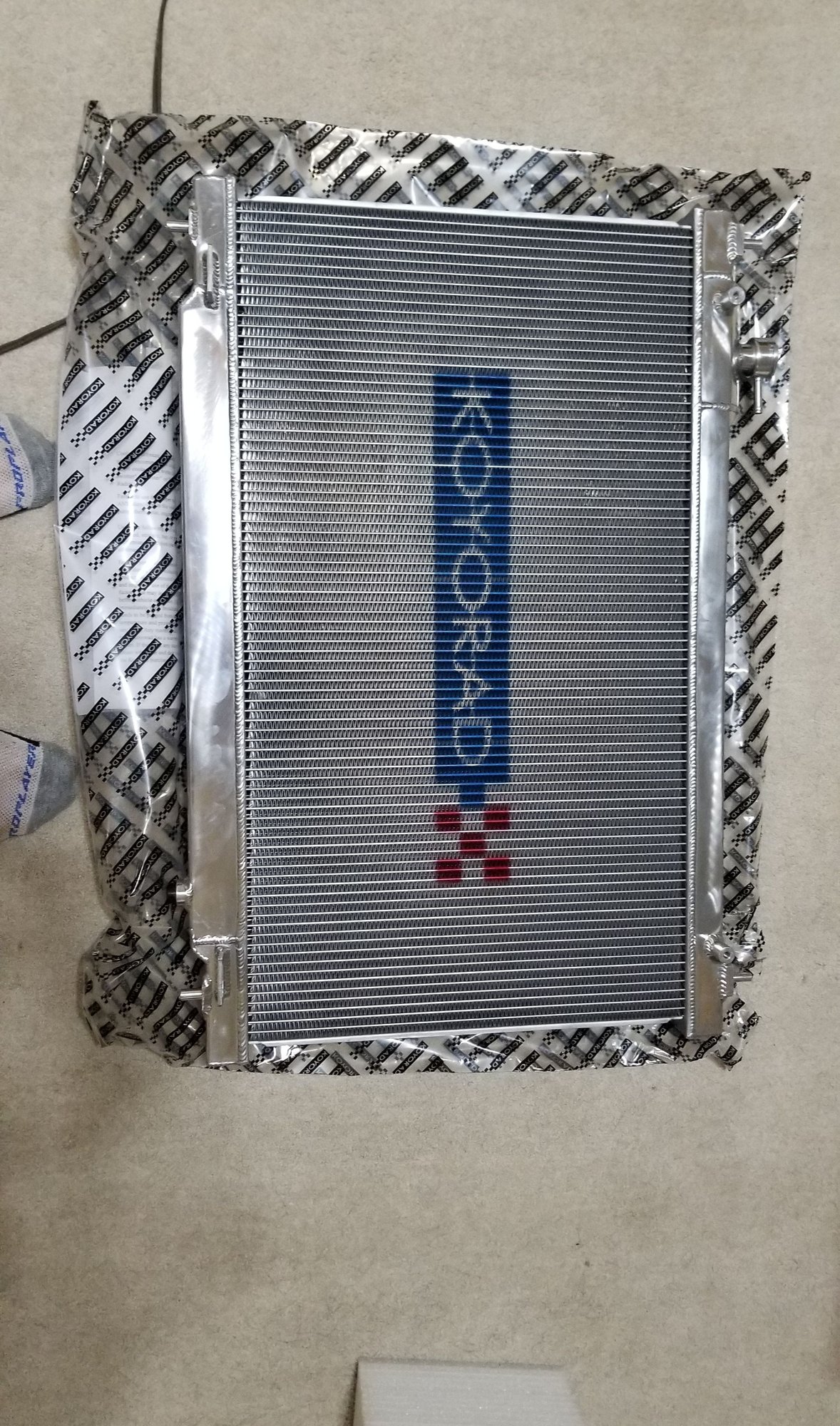

Well received some goodies today...
This bad guy looks amazing! It's also like twice as thick as the MT G35 OEM Radiator.

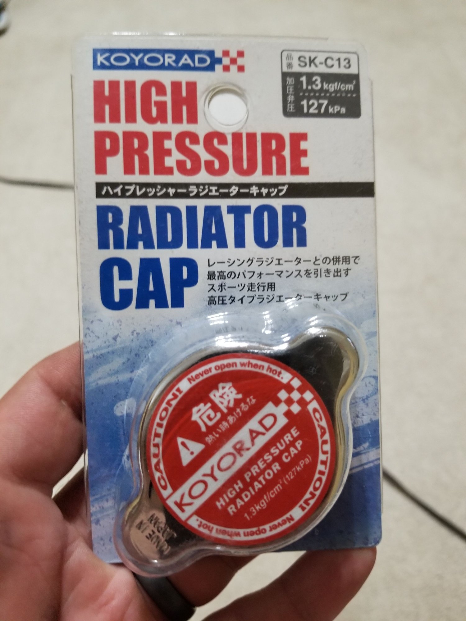

Not sure if i need this or not but to be on the safe side i wen't ahead and ordered a new high pressure radiator cap.
