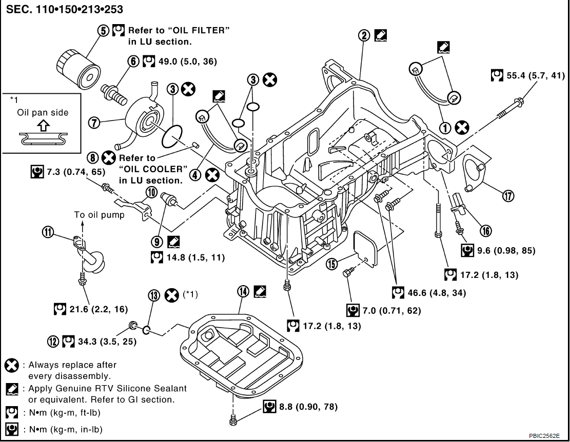

Ok so its not the rear main, its the upper pan rear gasket. I had to do a little more digging i thought the rear main and that was one and the same.
#1 is what i need replaced.
The shop said it should only take a few hours to replace but they are booked full for a few weeks. They also don't know when the tuner Slowpoke Tuning will be back in town, so that kind of sucks.
