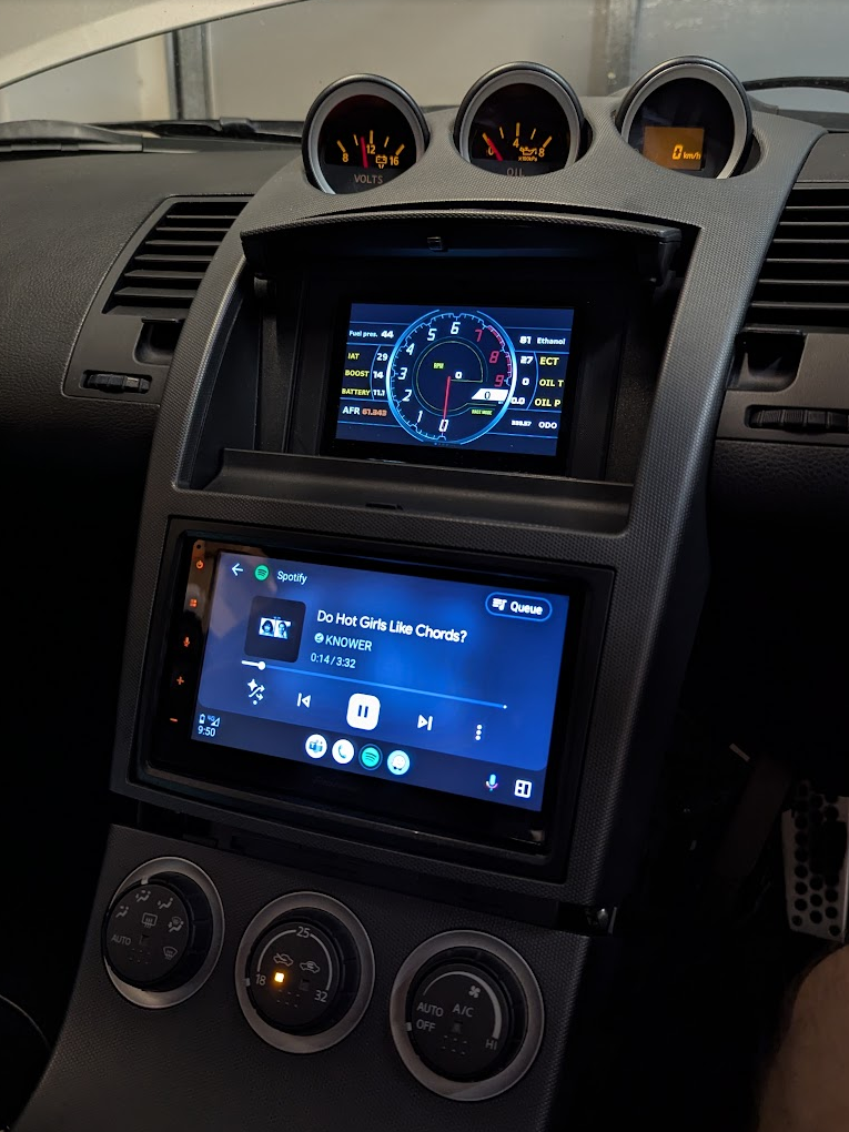

Originally Posted by Timboj
Just notices the gauge flip on the RHD

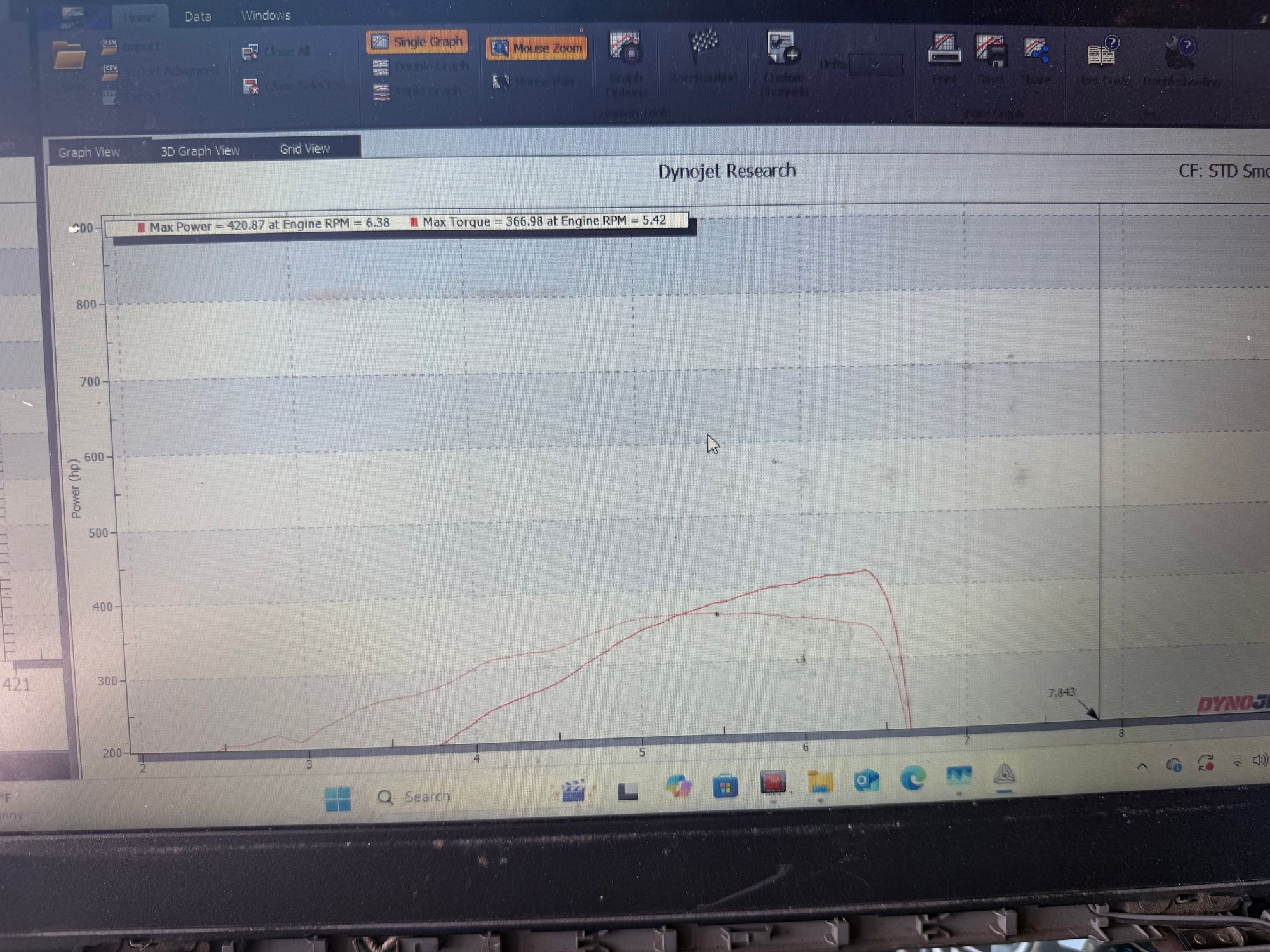

Update:
Made 420whp 355wtq
8.8:1 compression built bottom end
JWT S2 Cams
91 Octane
HKS GT V2 100mm pulley (11.6psi) I've gotten up to 12.5psi on the street so I am not sure why it was a bit lower on the dyno. Possibly just getting hot or slipping a little.
On my old motor it was a RevUp 140k miles bone stock with the 110mm pulley made 313whp on a Mustang Dyno so it was prob about 340whp on a Dyno Jet.
I bought the new built motor for a steal so I didn't get to choose the compression. But since I drive this car all the time, I do like the added benefit of zero knock whatsoever.

Car looks rad. I imagine the piston’s compression ratio is holding it back, but I wouldn’t be sure how much though.

The CR is definitely holding it back. Ideally that motor is built for a big turbo with fat boost and E85.
But since it's such low compression I am able to run really high timing with only around 12psi and the motor is super happy. I may later this year go to a mid mount kit and run e85 and get a lot closer to 550whp.
