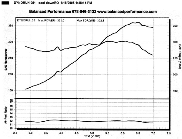

I have dynoed 375hp before. This one is 361hp. I have a return fuel system, Walbro Pump, and 440 injectors. When I was using an FMU mine was very hard to tune. Even with the 440 injectors and no return fuel system. Previous tuning took a couple of hours with problems in the A/F. The line you see on the dyno took 4 pulls. More pulls were done because of tip in enrichment.

Let me get rid of all the garbage. This show my A/F after the Kinitex Polished SSV IM was installed before tune and then after many hours and 28 pulls of adjusting.
This is probably the best and closest example of a side by side of stock vs. Kenetixs, at roughly the same AF. At the top, some of the gain is a result of slightly leaner AF...you can see that on the chart. But in the midrange, the A/F's are nearly identical, and I see some decent gains.

SungNamZ: was the boost identical on the before and after run? And what about the ignition timing? was the fueling the only thing that was "tuned" or were there other variables? how did the coolant temps compare between the runs? how about the intake air temps? I guess my point is, can we say that 100% of this increase in HP was from the manifold or not?
Being a dyno owner myself I can say without doubt that "back to back" pulls are worthless unless all conditions except for the test variable are maintained. I'm not pointing fingers at any person or product, I'm just looking to further understand the testing that was done. Considering the huge gains seen on your car it seems odd that others are experiencing far less of an increase. Obviously tuning matters, but on any manifold that I've built/used that actually increased power, the first step was that the car went lean as a result of ingesting extra air... once the AFR was richened back up to the old ratio, the power increase was obvious. It seems odd to me that others are reporting the opposite phenomena with this manifold and that its installation makes them run richer. The only way that would make sense (other than the manifold being worse than stock) is if a higher MAF reading was scaling the fueling up to a level where it is disproportionately richer. For example, imagine if the ECU's tables were such that 10% extra metered air selected an index where it commanded 15% extra fuel, thus leaving you 5% richer than before even though you have more air coming in.
Note that no one should be looking at peak gain on sungnam's dyno chart. The dyno operator stated that he (unintentionally) hit the button to end the run before the 350Z was through the entire powerband. (on the dynojet, this causes a spike of power)

2jz, the higher air flow reading wouldn't be possible would it? The MAF is pre intake manifold and therefore there should not be any increase in avg. MAF (correct me if i'm wrong: it wouldn't even do this on a turbocharger setup because I don't think it would change the airflow enough for the MAF to be out of avg. range.
Like Sharif said in another thread, the only way we will know how much power this intake manifold makes, is by tuning the same A/F ratio and comparing the dyno charts (preferrably on the same dyno on the same day). I also believe dyno-operator-error (intentional or not) should be non-existant on these tests.
and yes, in the case of a blower or turbo, the extra air will be metered by the MAF as well, again, unless it's maxed out...
one situation that could allow the extra air to slip under the radar would be a speed density system... in other words, you might have the same air TEMP and PRESSURE as before, which the computer interprets as the same amount of air, but if in fact you have a better flow path you will be getting more air... THAT is actually the entire reason for the invention and use of the MAF... nothing escapes its view... it is the ideal metering device (in terms of accuracy), it's only downside is the flow restriction that it provides...

I believe that a true comparison would be dyno factory, install SSV and tune to same A/F curve and redyno for after results.
All these cars are reacting differently in regards to the A/F with the SSV install.
I wish everyone's car would have the same reaction to the SSV install, but there are just far too many variables. Tuning is far less critical in NA form, where we are getting good feedback from our NA users.
