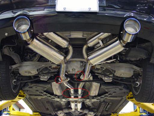

The loose bolts that I found were from the mid-pipes, circled in the pic below in red. The tic'ing sound, seems like it's coming from the back of the engine/HFC's area. However the gasket between the passenegers side HFC and H-pipe, didn't seem to line up 100% (I think the gasket was sticking out a bit from the oval flange)

double check clearance issues on that rear strut. When the car is on, and the exhaust is flexing it may be tapping that strut. I had that problem with my borla. Also do the same for the rear differential, that one pipe can come close to either of them depending on how your hangers are set more towards the front of the car.

clearance on the rear strut bar was in reference to the metal on metal ticking sound he was hearing. The white smoke was another issue.
