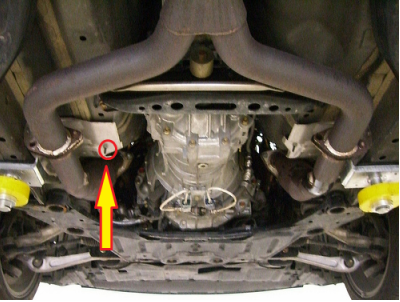

Hey I've been searching but it's hard for me to find. Which bolts do I need to shave off during the install? The driver side pipe keeps hitting something

Its the 6mm stud with the arrow pointing at it.
It will make all kinds of noise if its not trimmed down.

Also I've been driving for a couple of days and can't get it fixed until Monday. Will that damage the pipes?

No, not at all.
But it will be annoying with all the noise it makes. You can even cut it off with bolt cutters or even with a heavy guage wire cutters.

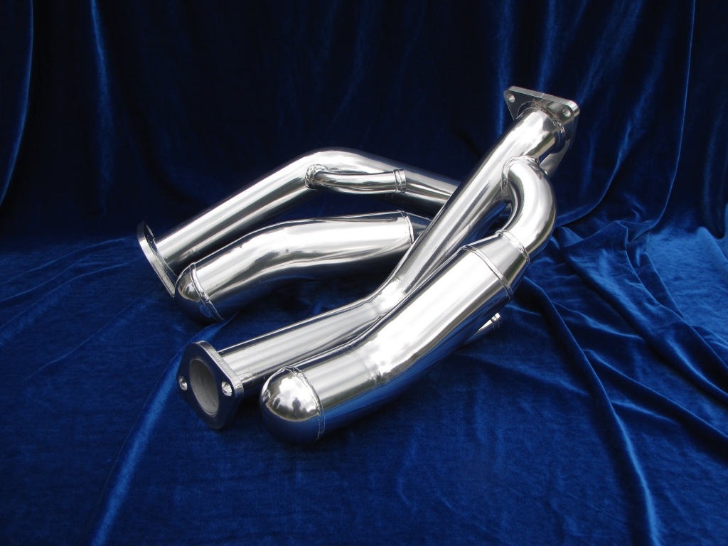

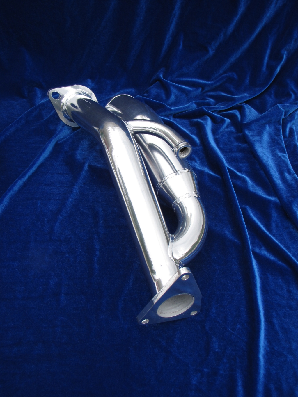

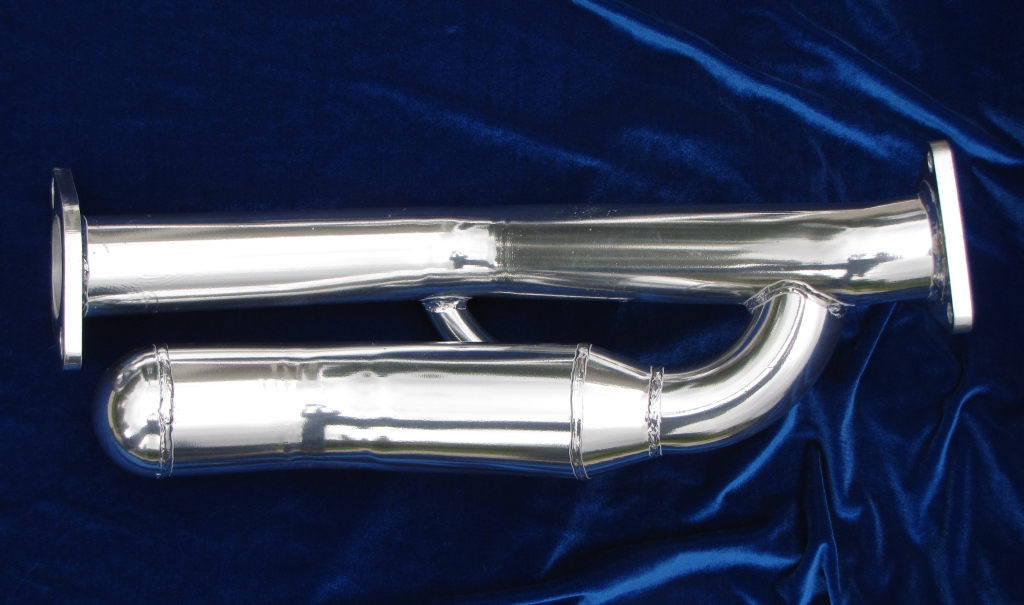

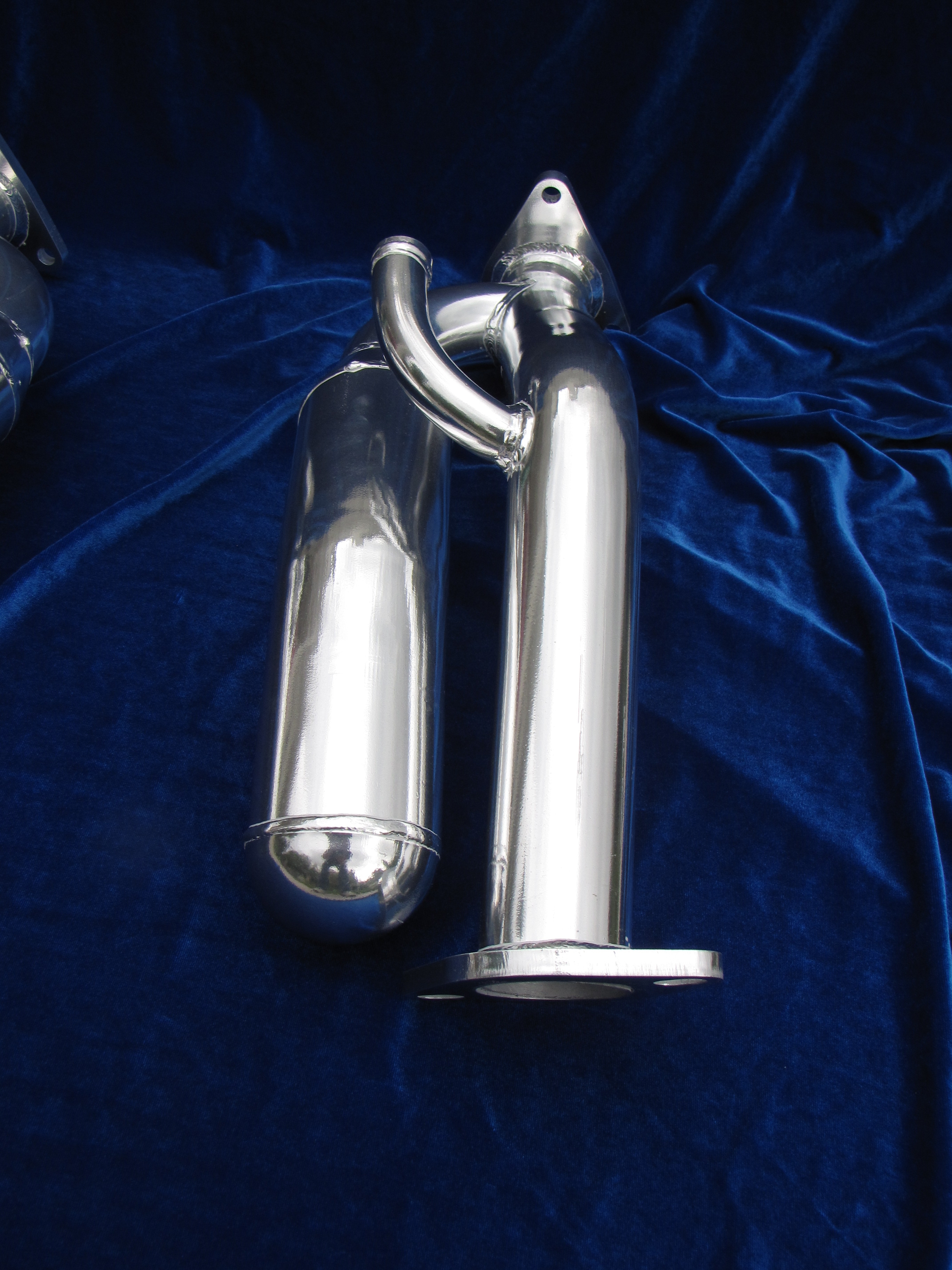

New Ceramic ART Pipes!

benefits? Cost less? makes more power? dont tease me now tony

Same price. More value.
Ceramic coated stainless steel. Slightly more TQ. Slightly less sound and less heat.
