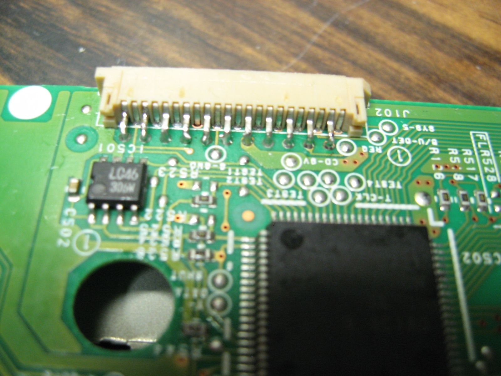

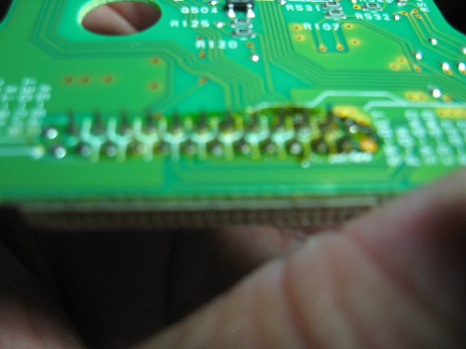

I had to take the radio out and strip it down.
Here are some images that show what the issues are.
I trimmed the ribbon cable and reflowed the solder on the plug. I am strapped for cash so the Bose will have to do for now.
Not sure which fixed the issue but better to do both at the same time cause the solder was weak and not flowed to both sides of the feed through's
